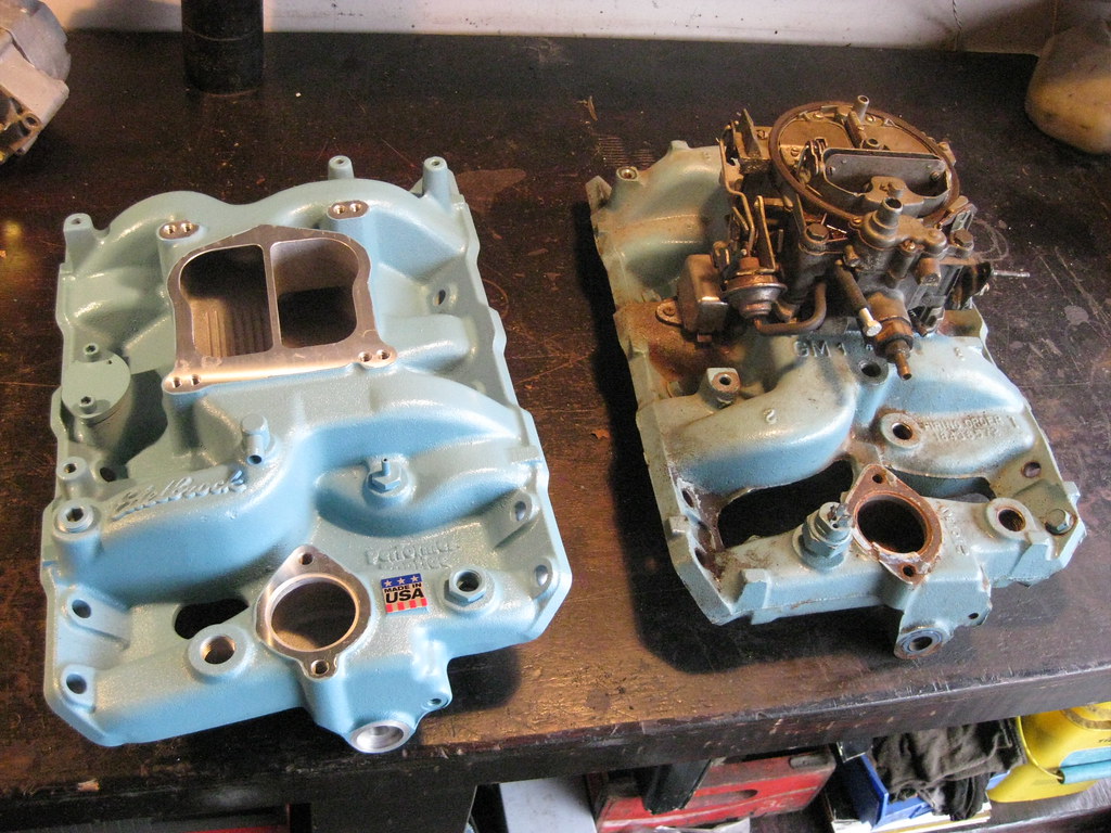

    We moved over all of the fittings from the original intake to the new intake.

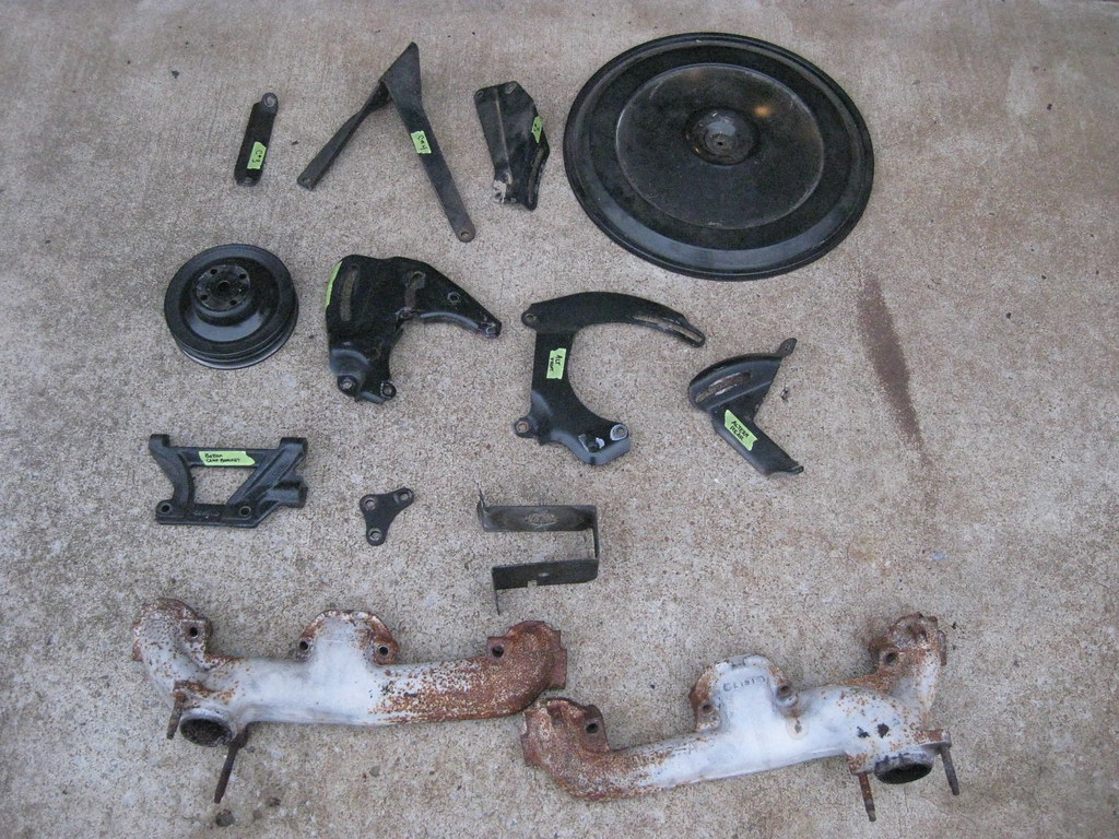

    I sent all of the front accessory brackets, and a few other pieces, to be powder coated. I also had them sandblast the exhaust manifolds. I believe by the end there were a few more pieces added that aren't pictured below.
    After looking at different options I decided to paint the exhaust manifolds with a product from Eastwood. It's a heat resistant coating that is a thin liquid. I applied a few coats with sponge brushes. This stuff is supposedly supposed to resist rusting and flaking off, so we'll have to wait and see.

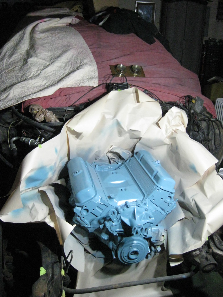

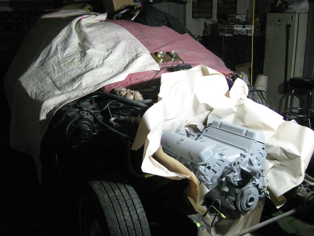

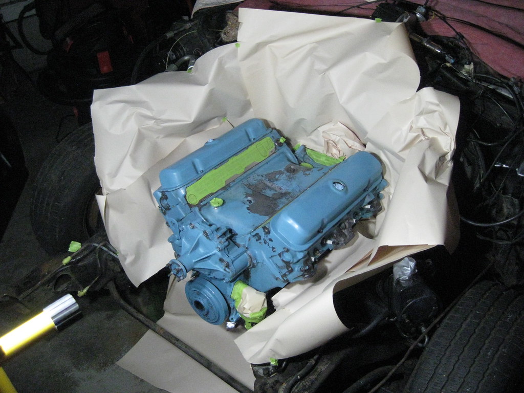

    Getting the car pushed back in the garage wasn't too hard because I happened to have family in that weekend and they helped make it easy. After the degreasing I cleaned the engine and prepared it for paint.
    I've never been entirely happy with the rattle-can primers I've used in the past so after searching around a bit I decided to go with a two part, heat-resistant primer from Eastwood. It comes in a rattle can, but must be punctured on the bottom to allow the two parts to mix.
    I still had a few cans left over from the first time I painted the engine several years ago. Unfortunately, I didn't realize that they have since discontinued this color. I would have had plenty of paint left over but unfortunately something happened to my last, completely full and unused can and none of the paint will come out at all. Fortunately, I had just enough, and I mean just barely enough, to get the entire engine painted. I couldn't just go buy another can because the colors wouldn't match.
