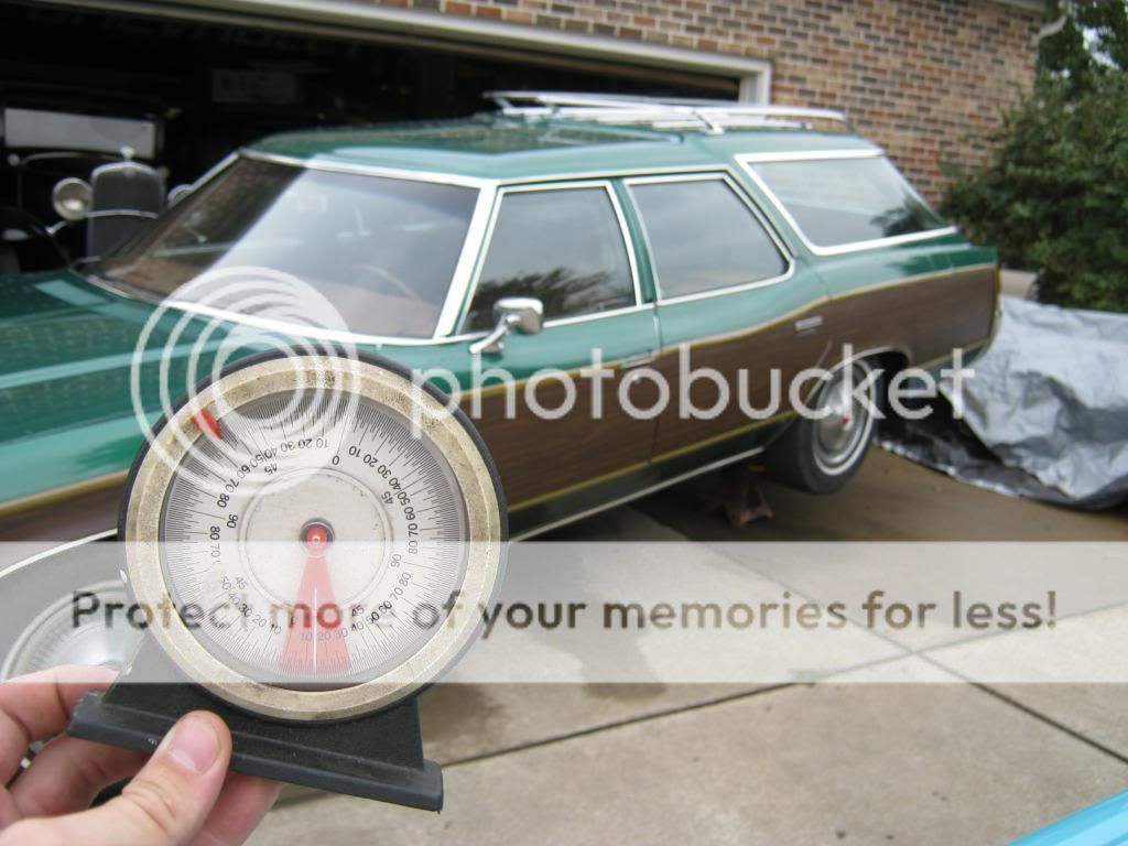

    I needed to find and set the pinion angle on the rear end. The new transmission caused the need for a longer driveshaft and the difference in size between the new 700r4 and the old TH400 meant that I had to modify the crossmember to allow the trans to sit lower. My friend let me borrow this angle finder.
    It is not necessary for the car to be level. What is necessary is that all the angles are relative to one another and that the jackstands are under the rear axle to mimic how far up the axle would sit against the body if the car were on the ground.
    First I got a measurement from the driveshaft.
    Then I took the driveshaft out and got a measurement from the yoke.
    I tried several different areas on the differential and they all gave different measurements. This was confusing because this is not supposed to be the case so I ended up using the measurement from the yoke because that is supposed to be the most accurate measurement. Though I don't have a picture I then crawled under the transmission and got a measurement from the pan. As it turns out the yoke and transmission are exactly the same angle (positive and negative 3 degrees relative to one another). This means the transmission is pointing down to the same degree that the pinion is pointing up. This is ideal in theory, but in real life you want a bit of negative angle on the differential to compensate for how much the leaf springs allow the pinion to rotate upwards under the forces of acceleration. Other suspension types such as ladder bars require less and a four-link suspension requires an even lesser amount of compensatory negative degrees of angle. My friend is going to let me borrow some 1 degree shims to insert between the leaf springs and the rear end before I buy them. This is the appropriate way to change pinion angle. We'll begin with the one degree and move to a two degree if necessary.
