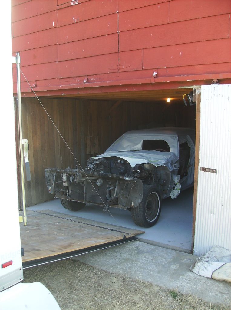

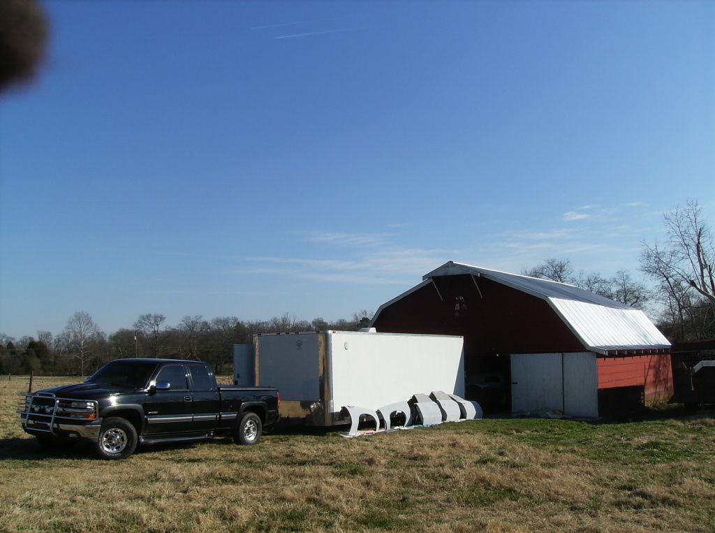

    It took quite a few attempts to get the trailer backed in because I didn't have the extended mirrors on the truck and it was impossible to see exactly where I was going. First I had to move all the parts outside, pull the car in the barn and then put the parts in the trailer.
    [​IMG]​
    [​IMG]​
    It was a close fit. The car was in the trailer at an angle and was only about an inch or two from the support cable from the door on the trailer.

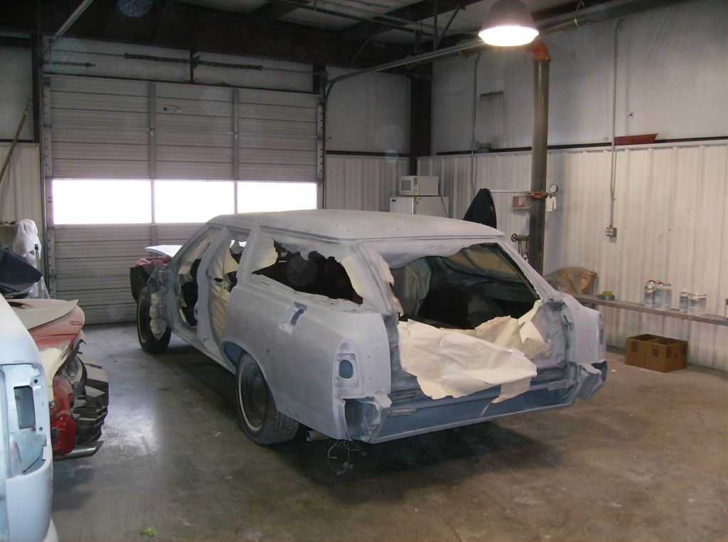

    Yesterday I took the car and all of its parts, in two separate loads, down to the paint shop. Fortunately, the shop is only about 3 miles from our house. It is in the back of a used car dealership that was, up until recently, a GM dealership that the government in their infinite stupidity decided to close down when they took over GM a few years ago.
    [​IMG]​
    [​IMG]​

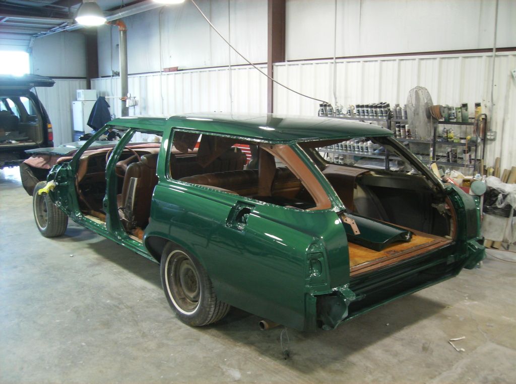

    The painter called today and said he was already done with it and asked if I could come pick it up so it would be out of the way. This was much sooner than I had anticipated and the problem I had was that when I hauled the doors home I didn't have anyone to help me unload them into my garage. I searched everywhere and finally I called dad to see if he knew anyone. He called a friend who came over and helped me unload them. After unloading the doors and fenders and various parts I came back and picked up the car. I called April, because it happened to be right as she was getting off work, and she met me there to get a first look at the color. We both thought the color turned out really well and it really complimented the color of the interior. It was difficult searching for the right shade of green but April said that this was exactly the color she had pictured so I suppose that's what matters. The pictures don't really do the paint justice compared to what it looked like under the florescent lights.
    [​IMG]​
    [​IMG]​
    [​IMG]​
    And, upon April's request, an obligatory shot of me in front of the car.
    [​IMG]​
    Here are a few of the pieces
    [​IMG]​
    [​IMG]​
    [​IMG]​
    It's not a show car, but it wasn't intended to be. In my opinion, it turned out to be a really great, perhaps above average, driver quality car. Next stop is the upholstery shop to have a headliner put in. Then I'll have the windows reinstalled, which can be done at my house since the window guy is mobile, and then I'll drop the engine in so the ball joints can be replaced before I reinstall any of the front end. It was recommended that I wait at least a month before installing any woodgrain.
