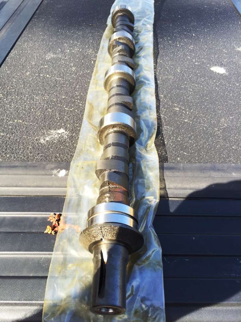

    Well you two must be psychic, as I finally got all the parts a couple of weeks ago (I thought) got the block cleaned up and Painted, got some time and the energy to work on it again this weekend.
    1st new picture the new TA Performance Cam

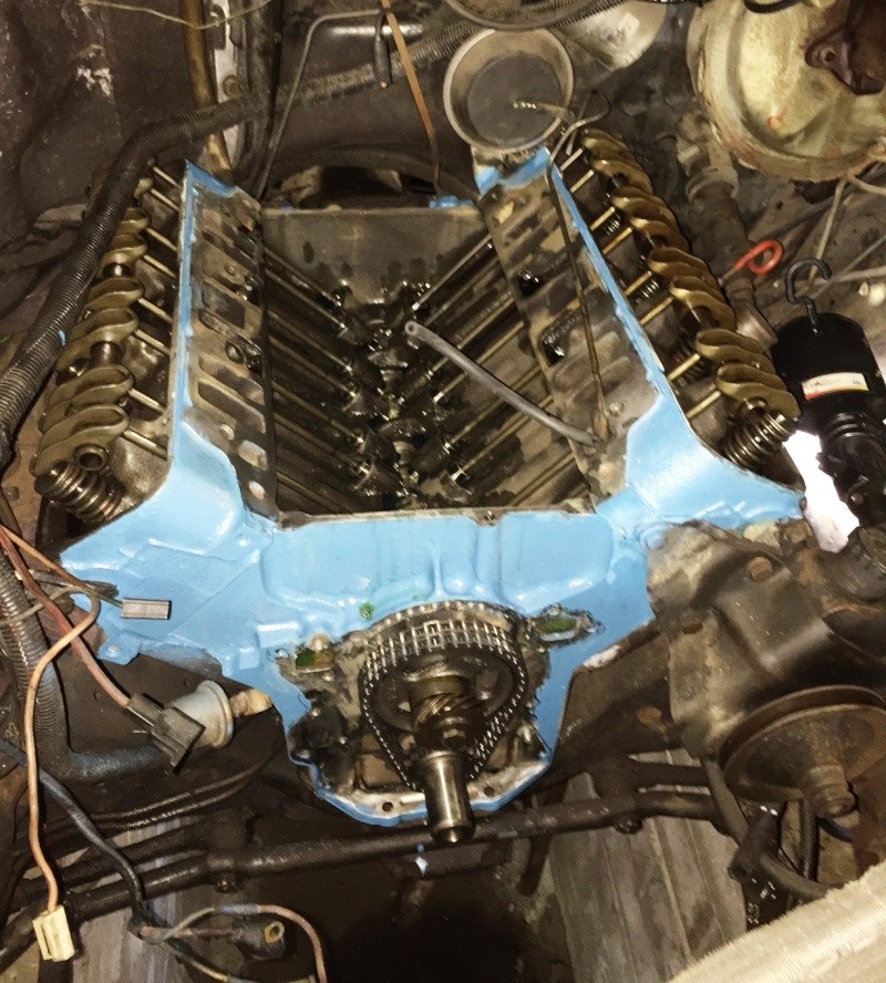

    The Block Cleaned up and Painted.

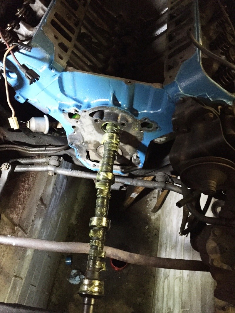

    The cam Lubed up and insertion started.
    Cam, New Cloyes True Roller Timing Chain (installed straight up as TA claims it is ground 2 degrees advanced) Fuel Pump eccentric, Dist drive gear and bolt installed and torqued to 48 Ft lbs, Lifters push rods, rocker shafts installed and torqued to 15 Ft lbs.
    Intake installed with new Bolts and torqued to 45 Ft lbs for the Aluminum intake. I think it cuts 45 lbs off the front of the car![​IMG]
    And Finally the EGR Valve installed, the new 5-port Thermostatic Valve installed, and the Thermostat Housing installed with new Bolts. I found a few issues with the S-divider intake with this Stock Late 70's non Buick installation. The Stock intake has 4 threaded holes in the water crossover passage, the S-divider has only 3, The large 5-port valve screws into the large one as shown, but the Temp sender is larger than the hole on the driver side, I will have to see if there is a smaller sender available. As for the Heater Hose nipple the same applies, larger than the Threaded Hole, and I will have to rig up a T connection to plumb both the Heater Hose and the smaller 2 port thermostatic valve into the 1 remaining hole on the passenger side. Hopefully it will not look to bad.
    Now I have solved 1 of the 2 Vacuum port issues, the transmission Modulator connection was larger than the stock hole, but I had a connector on a spare engine that would work. I will have to find an adaptor to connect the Power Brake booster to the other Hole in the intake. Hopefully small issues.
    I still have quit a bit of work to do, put in the oil pump Kit (standard not High Volume) put timing cover on, install the Dist, install the electric choke kit on the carb, wire it up, install the carb spacer (recommended for use with the S-divider Intake) Adjust the carb Linkage to match the new carb height. Pre Oil the engine, Hook up the cooling system, break in the new cam ECTRA.....
