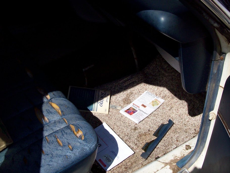

    When cleaning the wagon up when I first brought her home I found some t-bolts laying on the rotted carpet. I saved them thinking, I don't know where they go, but I might need em later. Low and behold after doing some reading these bolts hold the shift collar to the lower steering column assembly. I have some more homework to do, but tommorrow I'll do some real life finagling.
