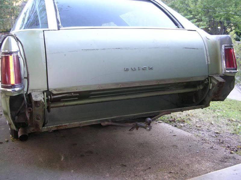

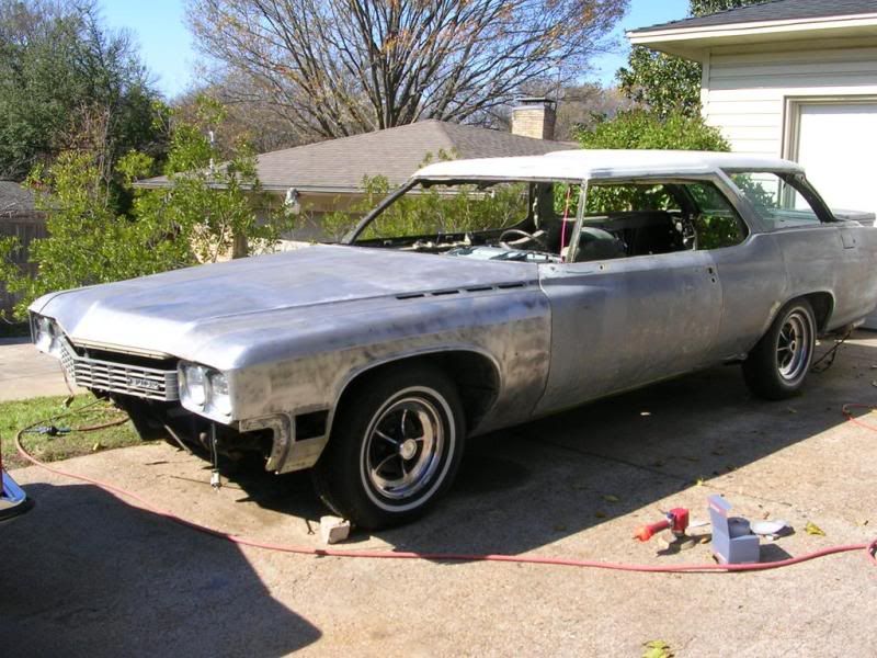

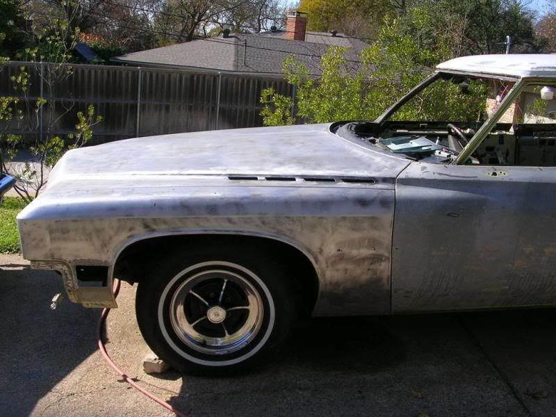

    My wagon is in bare metal!!! and I am waiting for a stretch of nice days to get it epoxy primer. I am using a PPG metal cleaner and PPG metal conditioner. I love this stuff! This keeps my steel clean and in great condition. Plastic tarps keep it dry.
    Today, I worked on my tailgate panel.
    I took it off weeks ago, and it needed some repair on the lower corner where the LH bottom mount had pulled away. This was caused by poor lubrication of the rollers and tracks.
    After some welding, it is good to go. I had tried to align it months ago, and couldn't figure out why it never lined up right. Now, hopefully it will line up just fine.
    I will have better pics maybe next week, if I can get a break from the rain.
    David :tiphat:

    That 4th pic gives a nice overall view of the 2 door effect. Looks great!
