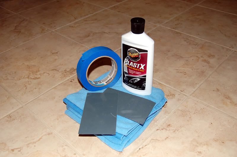

    Here is the exact process I used on the clear plastic speedo lens with
    severe yellow haze from 40+ years of wiping dust off with a dry paper towel.
    I slightly modified what was done at the below link
    http://forums.genvibe.com/zerothread?id=32206
    Note pic below is borrowed from genvibe.com
    1. Cleaned the lens with dish soap
    2. laid it flat on a bath towel with the outside of the bezel up.
    3. Started to wet sand 1000grit with soapy water in one direction along the bezel
    4. Repeat with 1500, 2000, and 2500 all in the same direction. Note you may want to only use light pressure thru all the steps and be careful if you wish to save the part numbers on the lens you will have to go around them otherwise they will be gone.
    5. Flipped bezel and sanded inside starting with 2000 then 2500 (not as bad on inside)
    6. Used a drill with foam ball and Plastx fully perpendicular to the surface moving slowly left to right.
    7. This step requires repeated polish, buffing off with a microfiber towel, then re-polishing. I noticed that if I let the polish dry it was harder to remove. You will have to try mild to med. pressure. I started with more pressure at first then as I buffed and reapplied, I would use less pressure.
    8. Flip and repeat on the inside of the lens. Hold up to the light and keep going until it is crystal clear..it takes a while. I hit both sides with windex and a microfiber towel and that did it!
