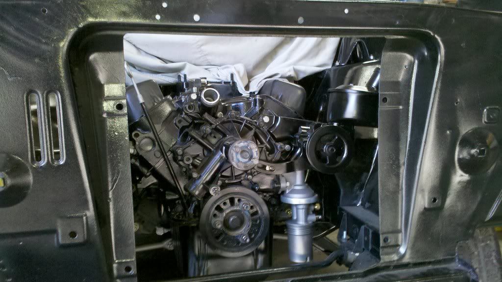

    The motor is now in, and I have started to assemble the motor accessories from the inside out, and..........problems right away,nothin that cant be handled but.....I think I might have shared already but the Tri-Y's (headers) from the mustang wont fit on the Comet since I am leaving the column shift C4 (green dot) in the car. Also the power steering pulleys dont match up wit the 65 style pulleys from the mustang, and the shift arm is wrong behind the neutral safety switch.
    Well i bought the exhaust manifolds back from the guy I sold the motor too, and the shift leg too :)
    Then I found a 62 63 style crank pulley for the mustang motor to match the power steering pump, wow is it heavy (the old pulley)!!! I had the entire power steering system rebuilt and it is back in as well.
    Gas tank was put in as well as the wind wing rubbers....That took a while but was rewarding..........kind of a therapy session for those. Anyway here are some updated pics to enjoy. It took me a while to figure out my new stupid a$$ smart phone. ENjoy!!

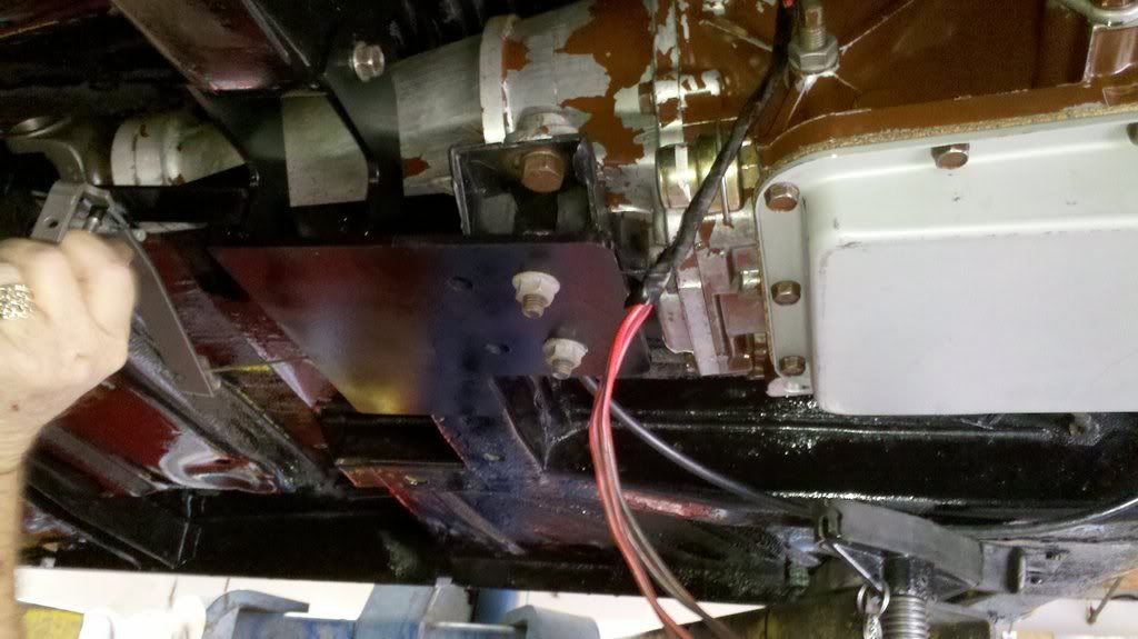

    Here is the fancy dancy universal trans mount, its kinda hard to see. It actually is a nice piece and eliminated the old cantilever style piece that was on there

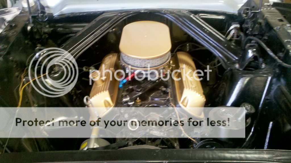

    And a couple of shots of the motor installed, the black valve covers are temporary, the pretty GOld ones will go on eventually. Oh yeah and I painted the manifold black too

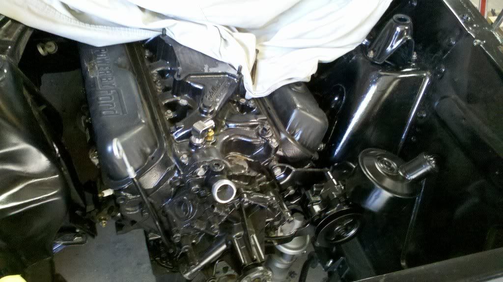

    Well this friday, I sandblasted the exhaust manifolds and I painted and installed them. (headers wont fit with C4 column shift).
    I installed the front shocks and layed the old wiring harness into the engine bay, I also installed one valve cover and laid the other one on the head.
    I also put the carb on the manifold and determined the following:
    I need black allen bolts to secure the valve cover, (to look nice), and I need to replace the blue and red fuel log with a nice black one from Earls. lol
    Then i pretty much looked and tried to figure out what would be next, on the following Friday, not a real productive day but.........
    Cya next week, here are some pics with the valve covers and carb laid into place. Ryan
