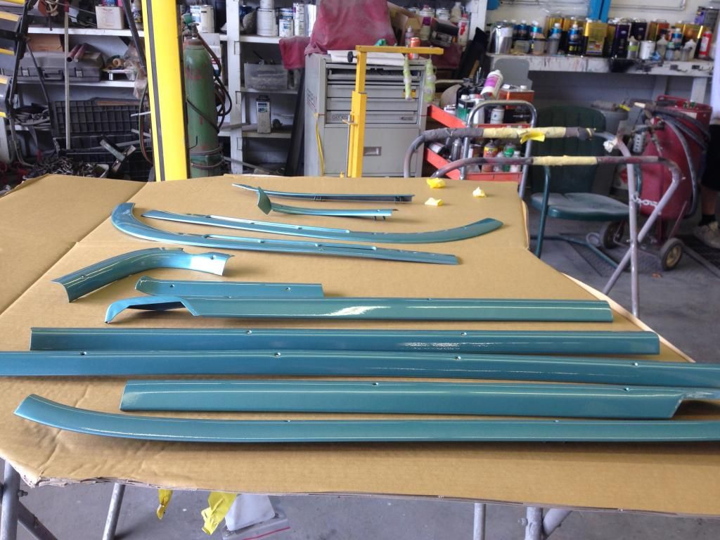

    I went over today and got a few more pics. Some trim (would you call them that?) pieces have been painted and I am very happy with the color!
    The engine guy hasn't been by yet but is expected next week. And the shop owner reports that he'll get started on fabricating the rocker panels and other pieces - the sheet metal we ordered has arrived.
    Worries are over about the color being too dark and not greenish enough - the color is lovely.
    My kiddo allowing us a closer look.
    Pieces awaiting paint. The shop co-owner is on the left. She has been so nice to work with!

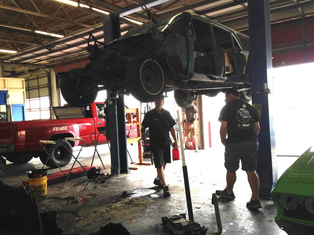

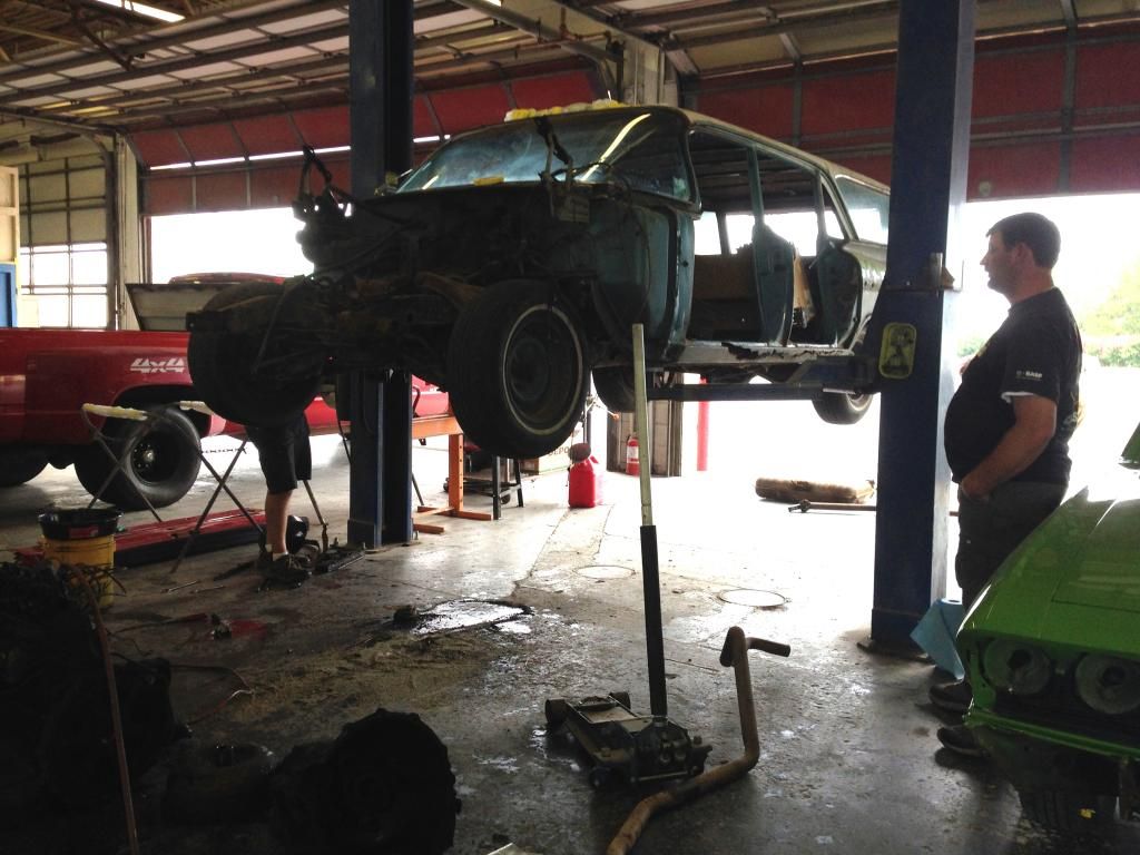

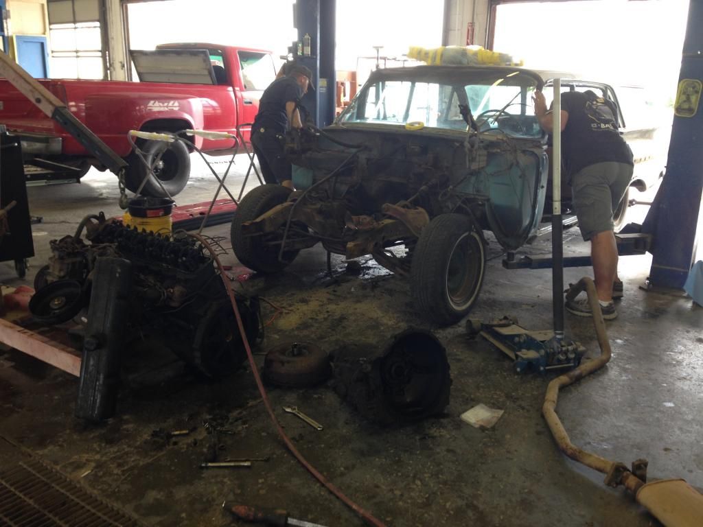

    A big day at the shop today. They're closed on Saturdays, but the engine guy, Larry, came over to assess the engine so we met up to learn what he had to say. Turns out he does a lot of other things, too - suspension, brakes, a/c, electrical. Pretty much everything besides interior/trim and bodywork. Steve, the shop owner, says he's the best in the business. That is always reassuring to hear.
    We talked at length about staying with the original engine vs. putting in a new small block V8. As you guys know, hubby and I have been waffling on this a lot. After meeting with Larry, though, we have decided to go ahead and replace the engine. He said he could rebuild it, and get the transmission in good shape, too, but in the end we would be spending more than a new engine and transmission would cost. Also, we would have a warranty and readily-available parts on a new engine/transmission. He understood my hopes to keep the original engine, but all things considered, doing so made less and less sense. As you guys have pointed out, we could get so much more out of the car with a stronger engine and better transmission.
    So - looks like it will be a Chevy 350 small block V8, and a 200R4 transmission. 4-speed with overdrive, if I understand correctly. I borrowed the shop's engine catalog and we're going to make our selection over the next couple of days. I think I want a carbureted engine, rather than fuel-injected, just to hang on to the older school technology a little bit.
    As for brakes, he agreed front power brakes, a dual master cylinder with power booster was what we needed. 60 - 40, and we could keep the drum brakes in the back if we wanted to. Does that make sense? I'm struggling a little to understand the terminology.
    Anyway, here are some pics from today.
    Bye-bye, old engine. I never really knew ye, or what you were capable of.
    Less and less of the car sits on the frame now.... here are Larry and Steve getting it on the lift.
    Going up...
    ... and up....
    ...and up.

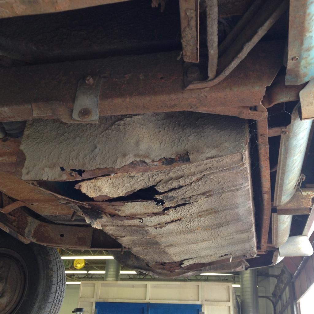

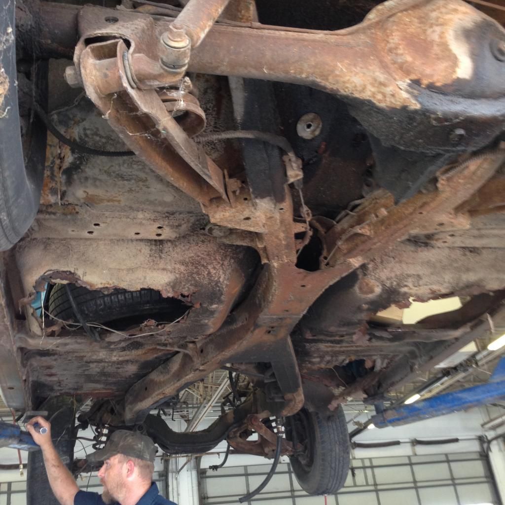

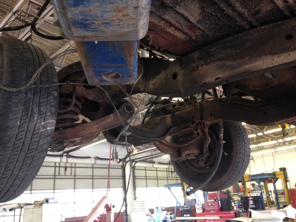

    The guys noticed the bolt missing from the... what is it? A control arm? Whatever it's called, they said the wheel had nothing holding it into place! Don't know how long it was driven in this condition. Larry will replace the springs, ball joints, and whatever else needs replacing. He thinks the frame looks good.

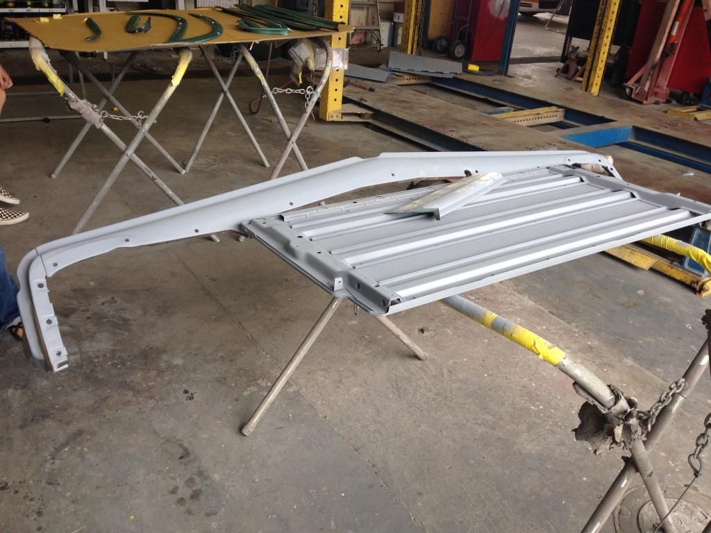

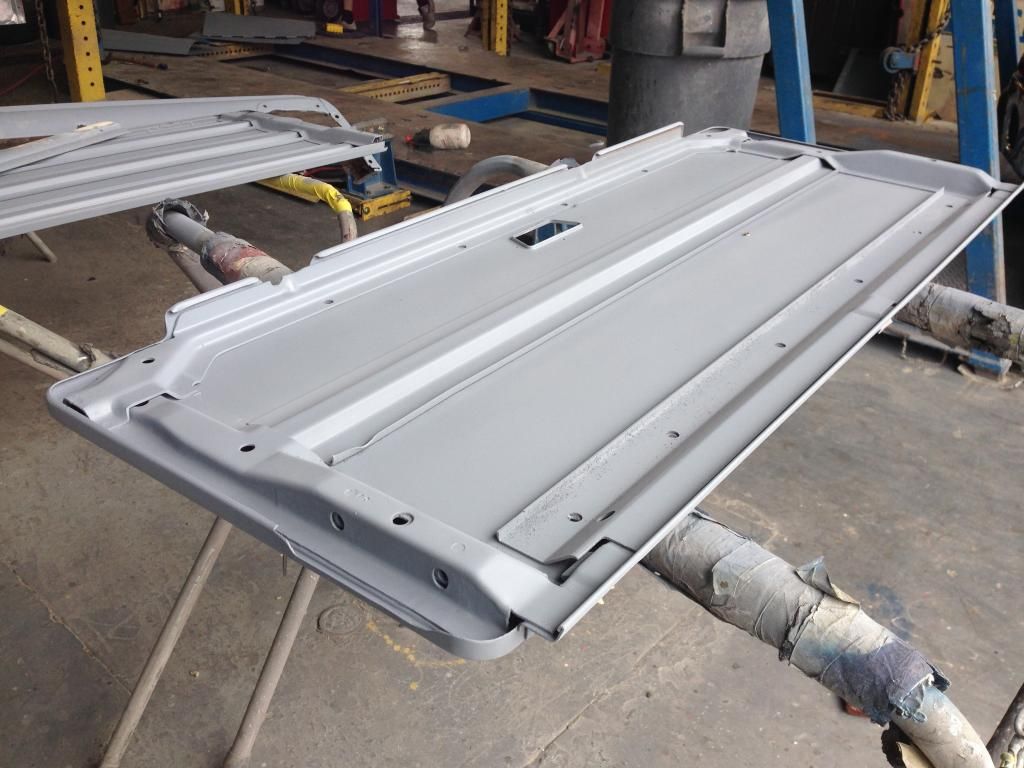

    The new floor pan arrived, as well as a new rear quarter panel and the extra sheet metal for fixing/patching other various holes.
    Various other pics, showing the condition of the undercarriage.
