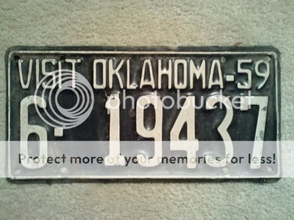

    Before pics (from Ebay seller)

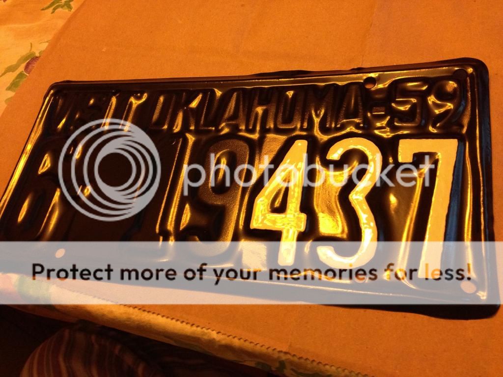

    The paint was kind of powdery and scrubbing the plates resulted in much of the paint coming off. So I went after them with a wire brush, coated both sides with Rustoleum rust inhibitor, then coated the front with Rustoleum black semi-gloss enamel. Let it dry overnight, then painted the ivory details with Testor's enamel model paint. Very tedious and my hand wasn't quite steady enough, but hopefully from a distance it will look all right. After this dries I'll coat it all with a clear enamel.
    Ack... from here the letters look pretty sloppy. Don't know if I should try to trim them up with a razor blade... might make things worse.

    By the way, I smoogied the lettering with my thumbnail in the places that were messy and straightened the lines a little. It looks better. Now I have to leave it alone until it dries, and the clear coat will go on.

    For the painting, I would've used a white Rustoleum first to cover the letters and numbers, then used 3M Blue masking tape to mask them off before shooting the black. But that's just me.

    I was reading some older posts yesterday about different methods of tag restoration, and one person painted black over white and then block sanded the black paint from the raised areas. I guess there are many ways to do it depending on the ability of the person doing it and the tools on hand; some methods are better than others.
    I would worry about my skill at masking that many numbers and small letters... not sure my results would look very good.

    Your license plate looks nice even if you did have to do some minor smoogying ! ;)
