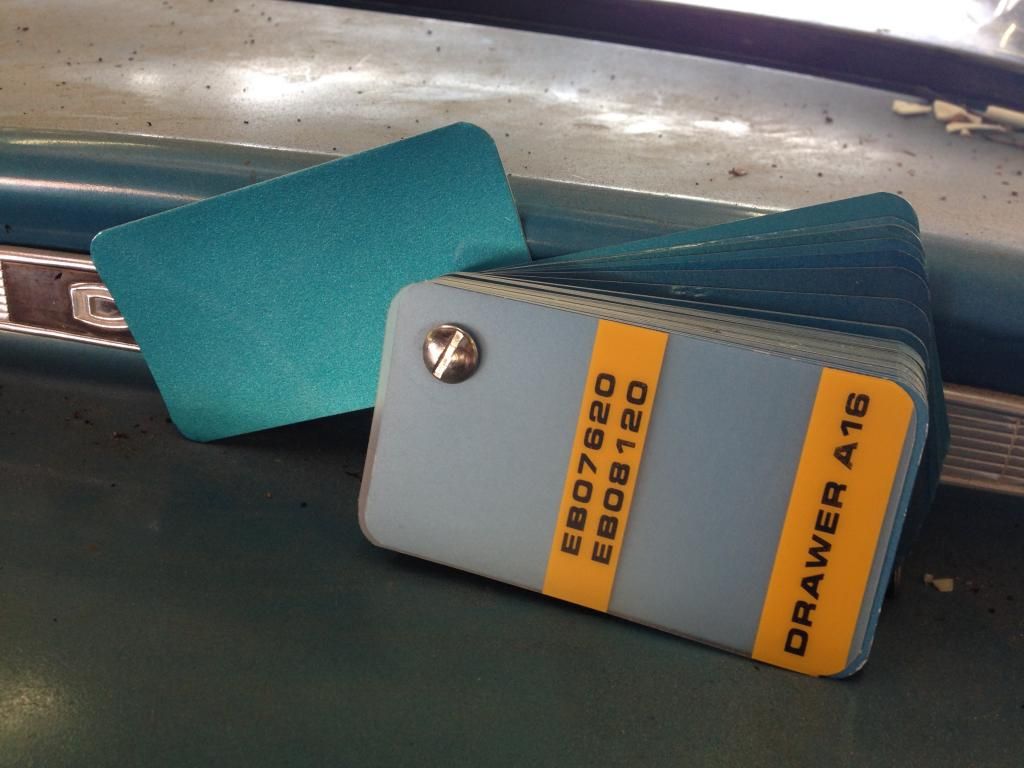

    Today the shop called and asked me to pick the blue paint color for the interior metal and exterior. I wish I had known the answer to this question before I drove over there: Was the color for the interior metal the same that was used on the exterior (which was Crown Sapphire)?
    They got the paint codes from the door tag, and from that they picked a color family closest to the Crown Sapphire color. There are probably 30 shades of blue on that car, inside and out, and after accounting for fading and aging, I ended up picking a color that I liked the best.
    This is the color I picked. After I got home and thought things over, I wonder if this is a touch too sparkly. And it looks lighter in the photo than it did in person. Maybe it would be a better exterior color, and something creamier would be better for the inside. It's just hard to know how a tiny variation in color will look when it's covering an entire car. Not unlike painting a room in the house!
    What do you all think?

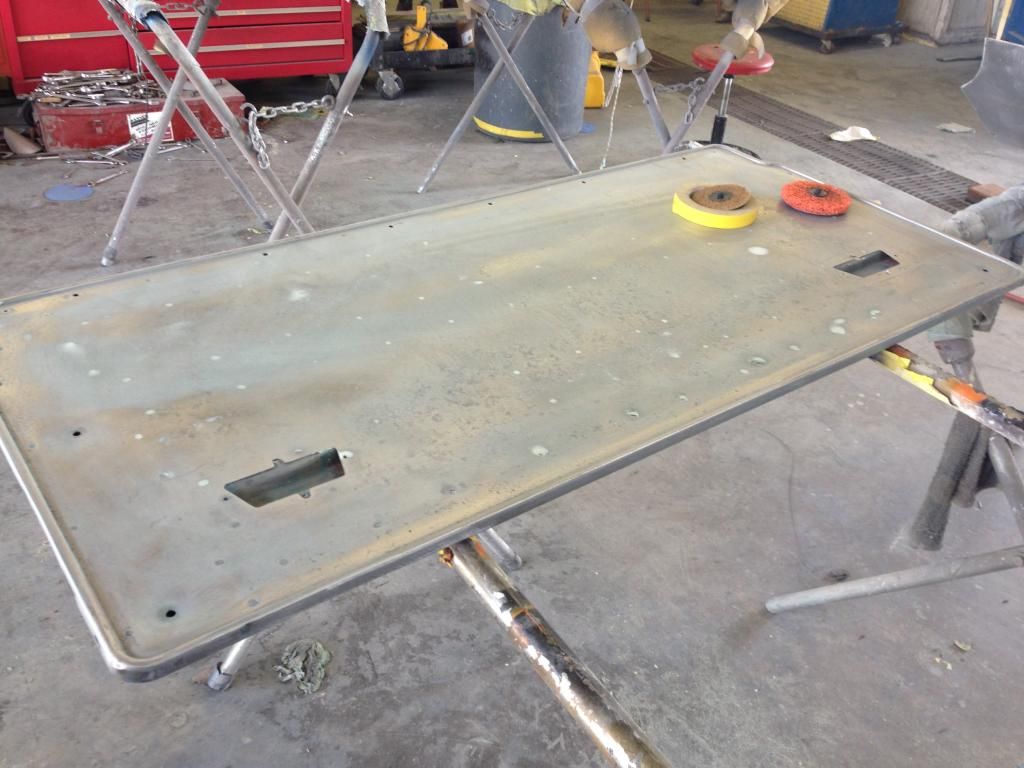

    This is what will be painted first; the metal panels for the linoleum decking in the cargo area. Here, they're prepped and primered, made as smooth as possible for the trim shop.

  14. Silvertwinkiehobo
    2,995
    Personally, I'd go with what you chose. I think the metalflake enhances the interior look, especially when kept polished.
