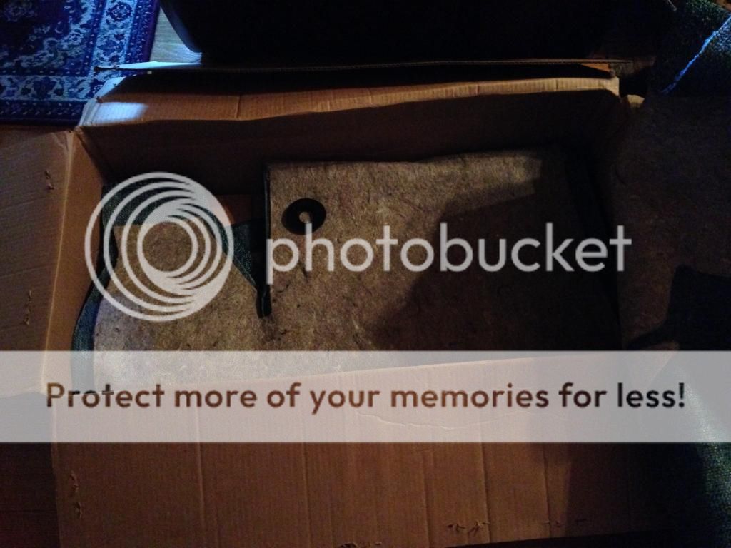

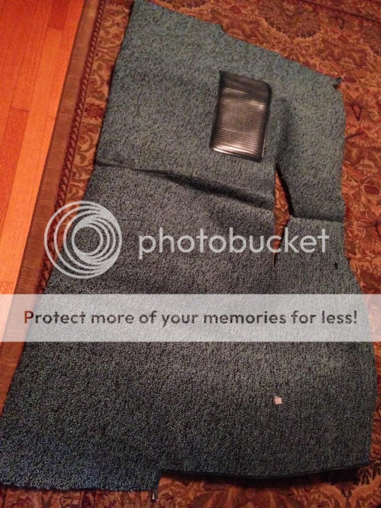

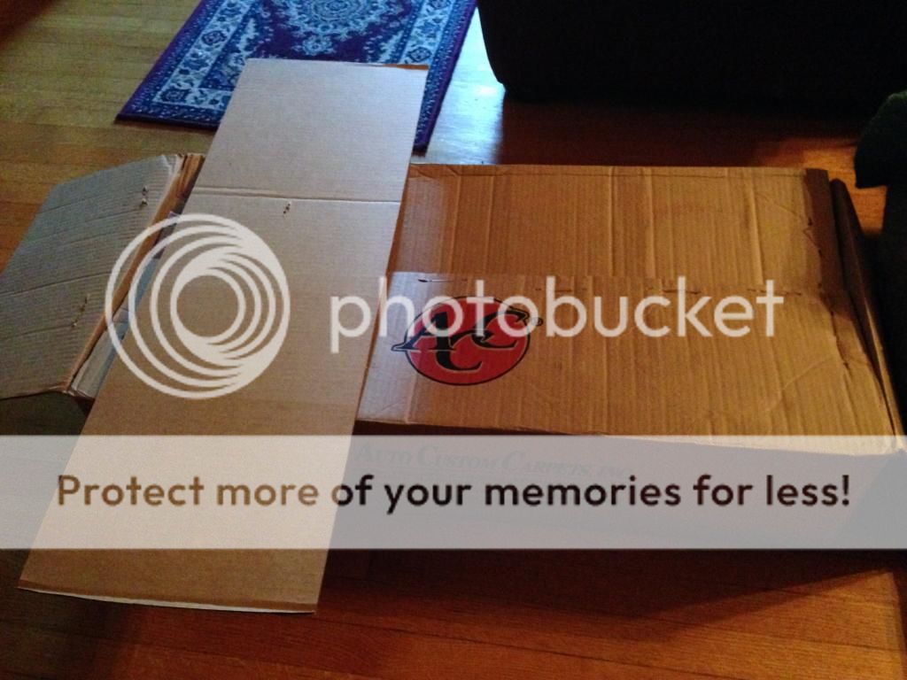

    By the way, the carpet set arrived from SMS Auto Fabrics yesterday. It looks very dark in the pics but it's the correct teal color.

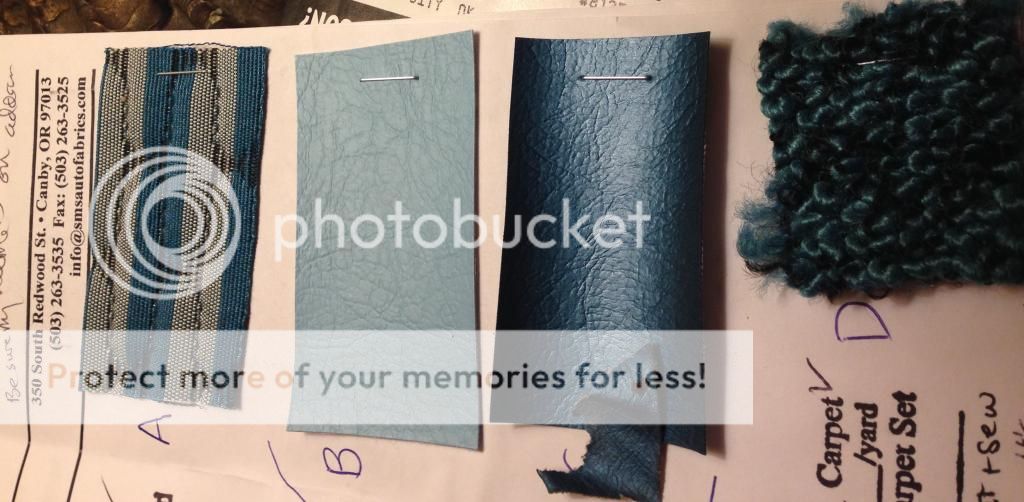

    The samples from SMS are perfect reproductions of the original materials.
