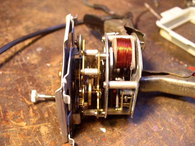

    As for the clock. I think it can be fixed. The movement in them is usually bullet proof and could last a hundred years. But the solenoid that periodically winds up the escarpment generally is the problem. That and dirt.
    I found that by spraying WD40 on the works and then dumping paint thinner or Naptha over the works cleans the movement (gears and such).
    Followed by a quick blow dry with compressed air.
    Then on the work bench, hook up the power leads with a 12v power source and let it sit and run. If it stops... clean again and again and again until it runs continuously without stopping. (Provided the solenoid works to wind up the escarpment of course.)
    re-set the time daily as most of these clocks are built with an adjustment clutch.
    The clutch advances the timing slightly as the set screw is moved forward. Retards the timing slightly as the set screw is moved backward.
    My dash clock now keeps perfect time and I couldn't live with-out it.

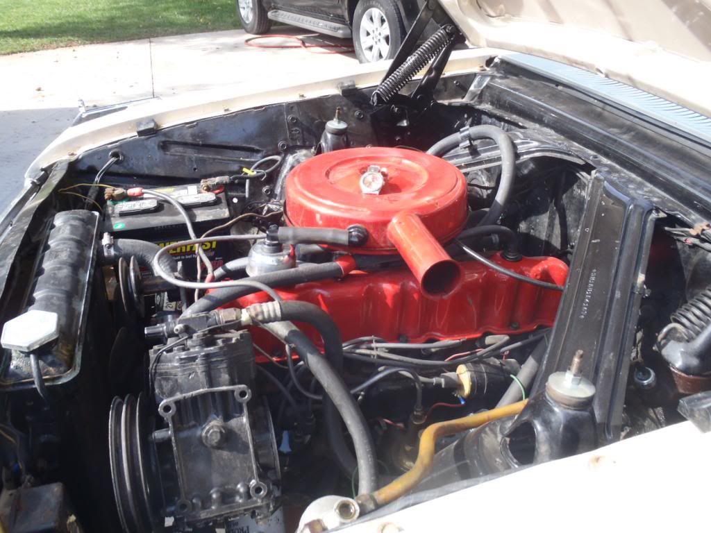

    Oh my goodness! That AC mount would be perfect for my 3.3L (200 CID) I6. Mine is on the passenger side, so I'm having to make my own exhaust header for it. If you're willing to sell it, please PM me.
