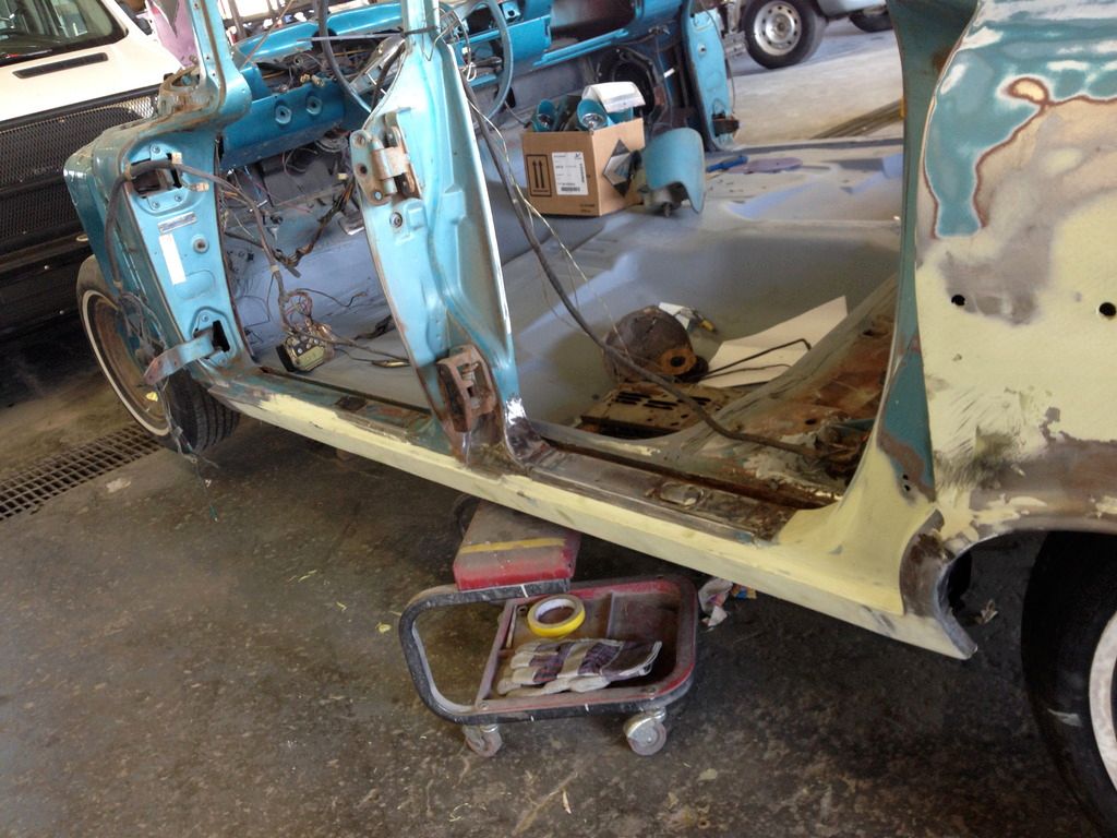

    Wow - yes, I've been away a long time! So sorry not to have filled you in sooner. Not much had been going on over the holidays, and then we had quite a run of bad weather which kept the body shop busy.
    But - I do have an update and some photos for you that I took today. Stephen has been doing lots of metal fabrication to replace parts that had rusted beyond hope.

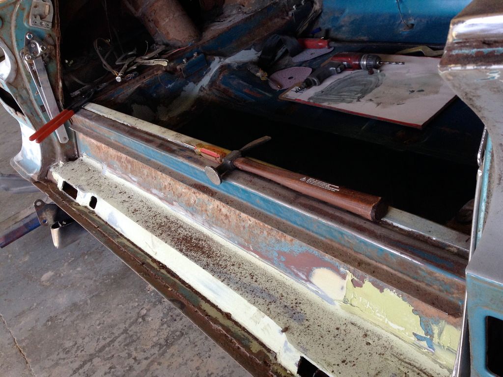

    Here are the new rocker panels. We were unable to find parts, so Stephen fabricated them.
    Panel below the tailgate area is all-new fabrication, neatly welded in.

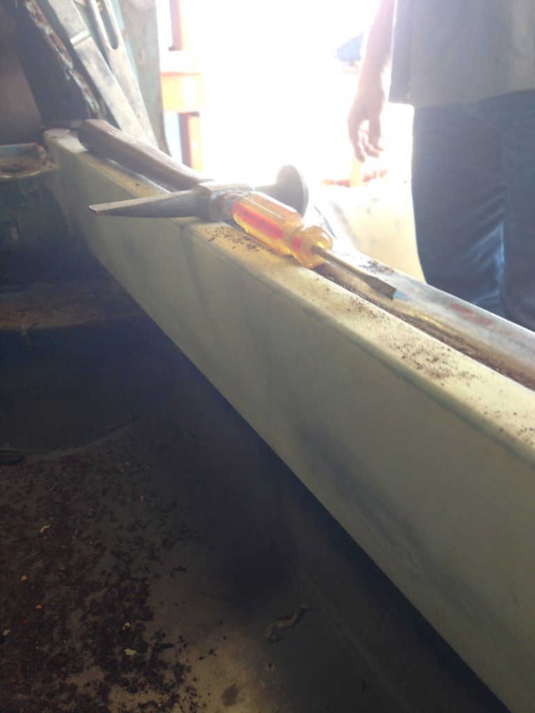

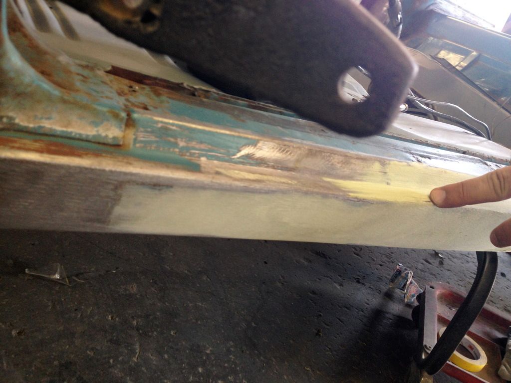

    What is this called - the sill plate? Fabricated, and ready for painting.
    The new replacement lower quarter panel is now welded into place. I tried to find the seams but couldn't. Looks very smooth!

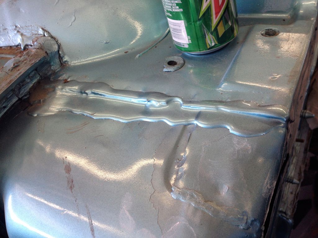

    New floor behind the rear wheel well.
    Can't remember what he called this stuff, but you guys probably know. It's a sealer kind of thing that's extra runny and really gets into the cracks. Stephen said it was the same kind of stuff originally used on the car.

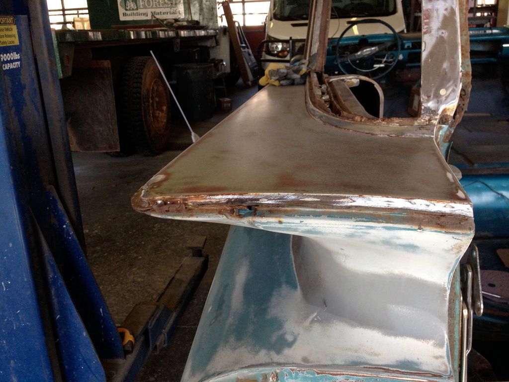

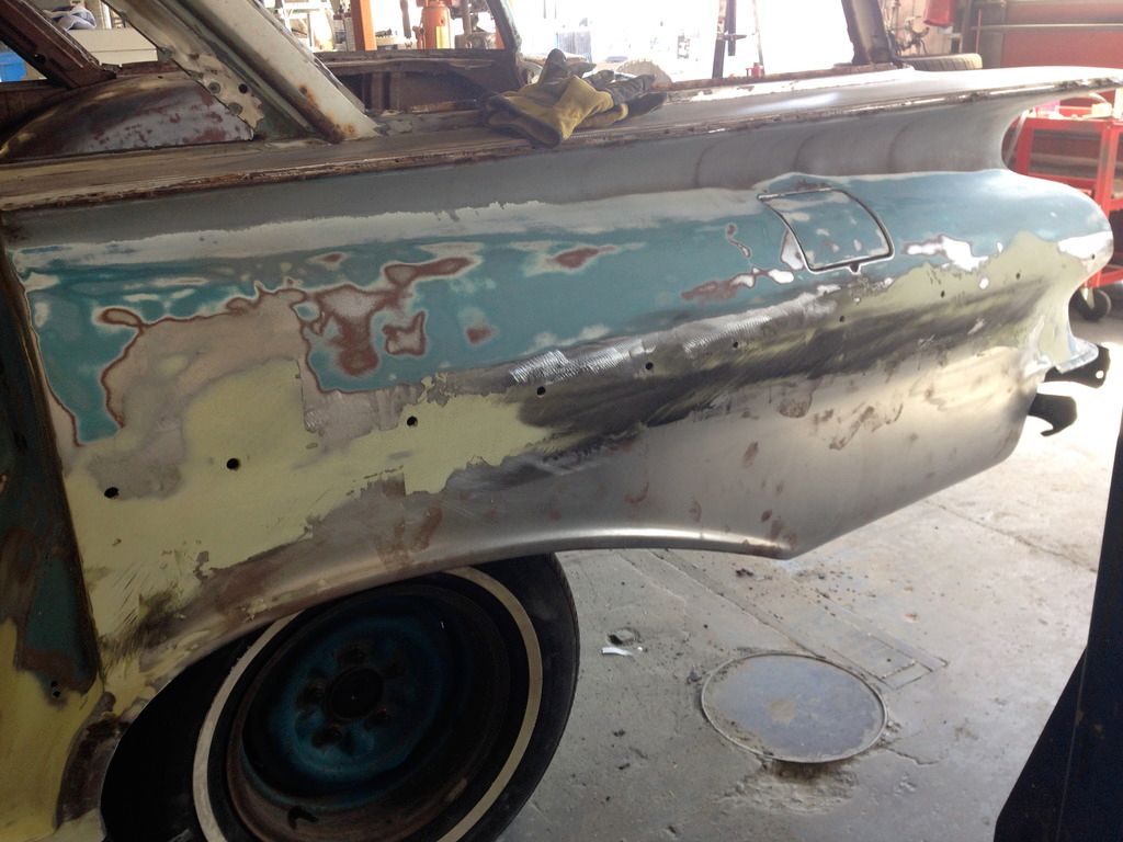

    Getting down to bare metal on those iconic wings.

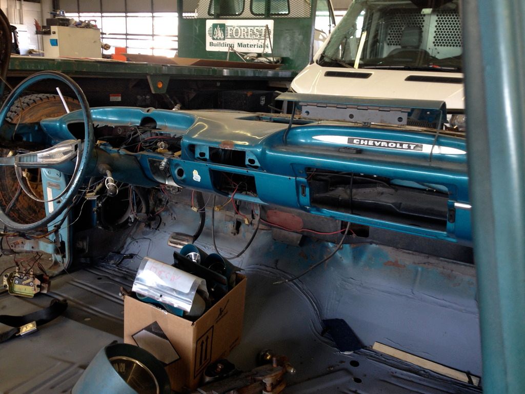

    The dashboard....

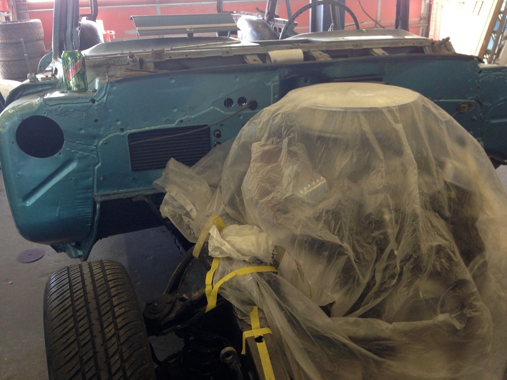

    Keeping that 350 engine dust-free...
