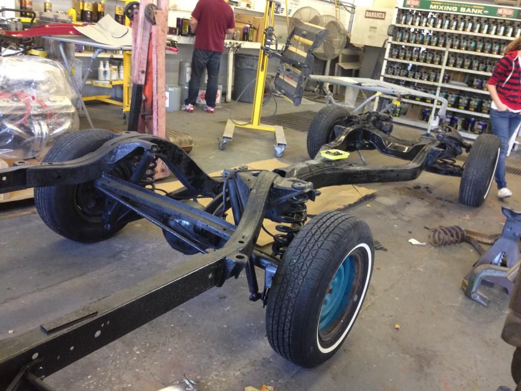

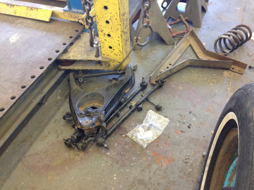

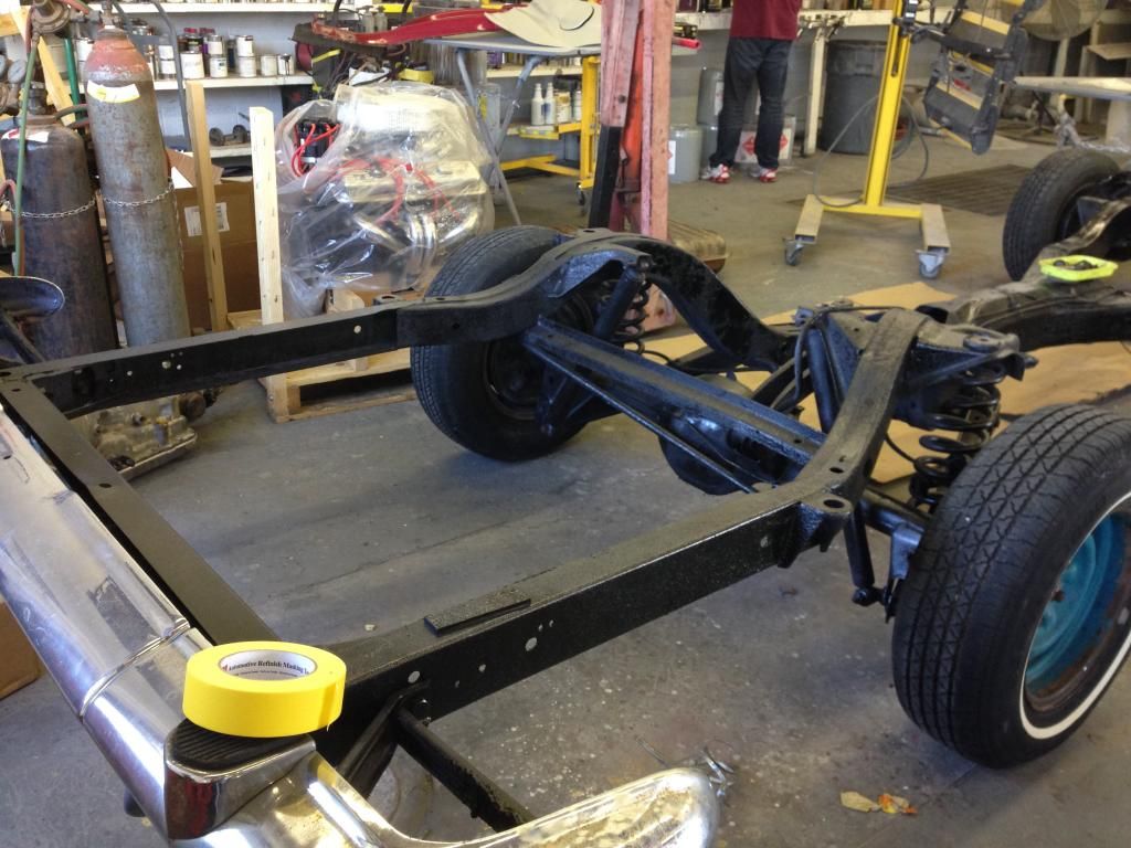

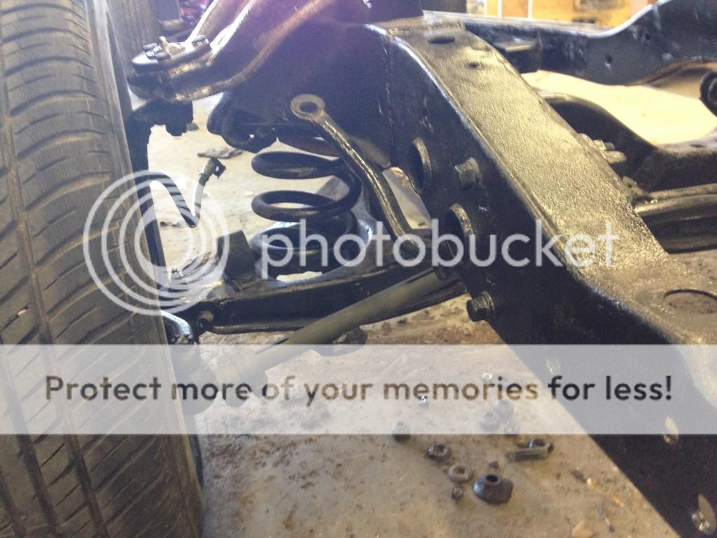

    And, yesterday I went by the shop. It had been a few weeks. Larry, the mechanic, has been going over the frame and it's now repainted, with new springs and suspension all around. Please correct me if I'm describing something incorrectly, or if you see something significant that I missed!
    Bracket added to support the new transmission.

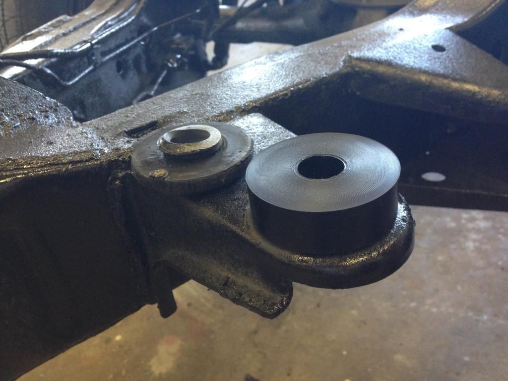

    New bushings to support the body. Old ones didn't look so good.

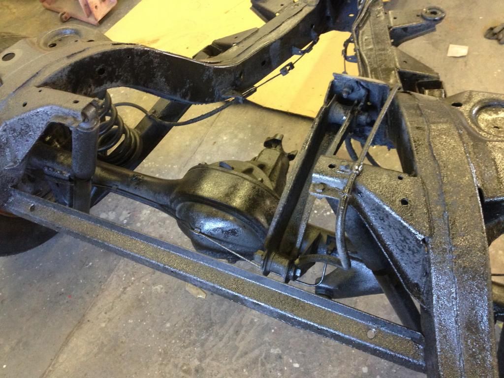

    Does it look like the rear end has been rebuilt, too? That was in the plan.
    Out with the old...
    Also, he's been working on the engine... distributor is in place.
    One more pic of the suspension....
    Stephen, shop owner, tells me they'll be fitting the engine onto the frame early next week, and possibly putting the body back onto the frame. I'll keep you posted.
  13. Joyflea
    Joyflea Member
    Sep 29, 2014
    25
    Texas
    Lisa it looks real nice ! There should be some gasket cement where the third member ties into the housing if he had rear end apart . Also you can check the rear end fluid and see if it's clean and full . But looking at the work he's done so far he probably is a good and honest mechanic . Is that crate motor a 340 horse . If so you will love it , have one in my 39 pu . Did you like the address label ? Latter , Blue .
