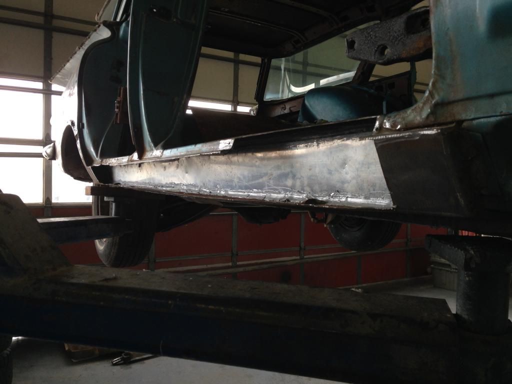

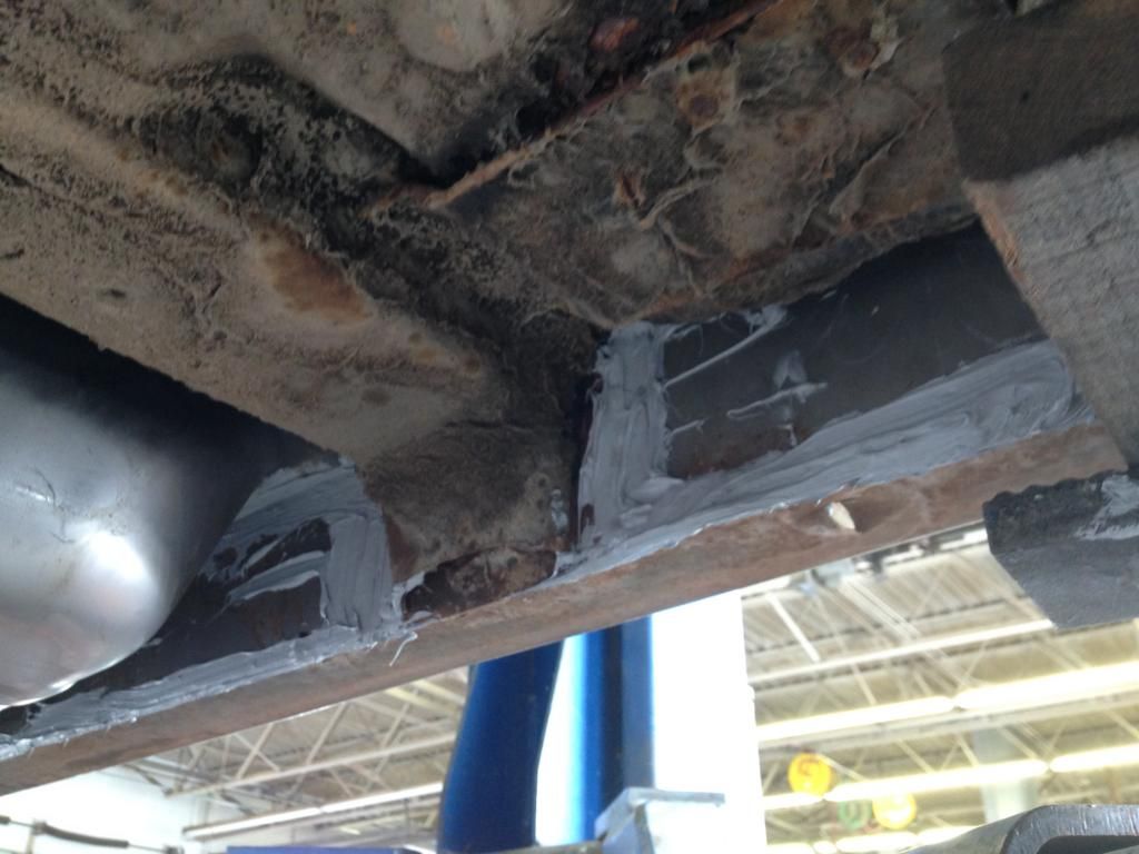

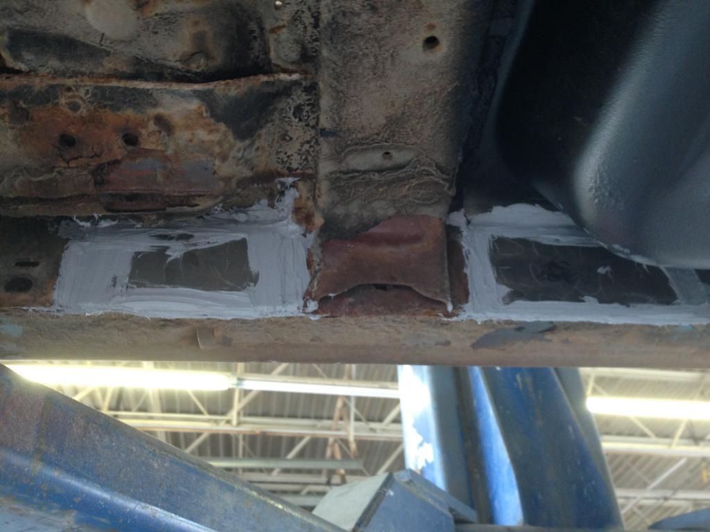

    A few updates. The guys have gone over the weld seams with a bonding agent, and are primering the pans and removing the old undercoating. Several areas have been patched, with more to go.
    Newly-fabricated inner rocker panel. This was the piece were were unable to source.
