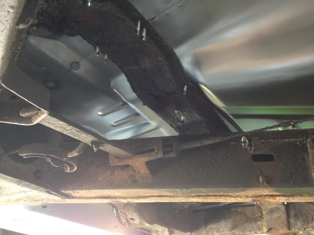

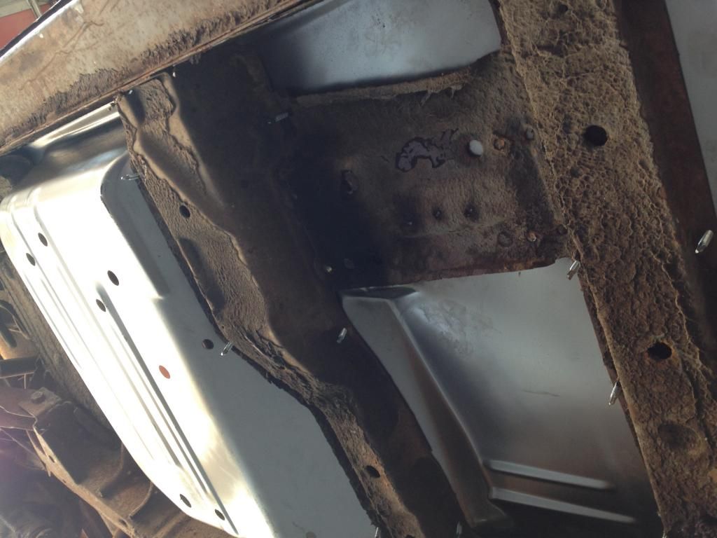

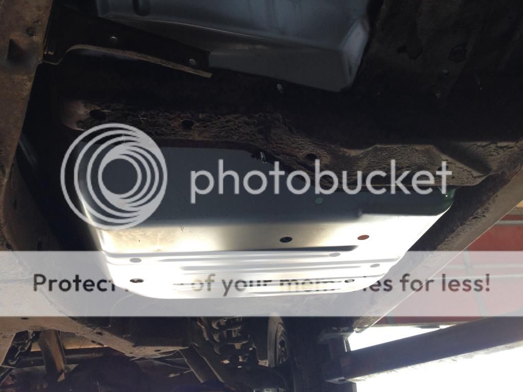

    More photos today. They're getting the floor pan in. It was a good fit - they did have to split it to get it inside the car, but then it will be welded back together. Once the pan halves were positioned, they dropped right into place.
    Here you can see the seam where the pan was split.
    They had to raise this crossmember (?) because it had settled onto the frame over the years. I am guessing its purpose is to support the floor. You can see the bolts to hold the pan while it's being welded into place. Those will later be removed and the holes filled.

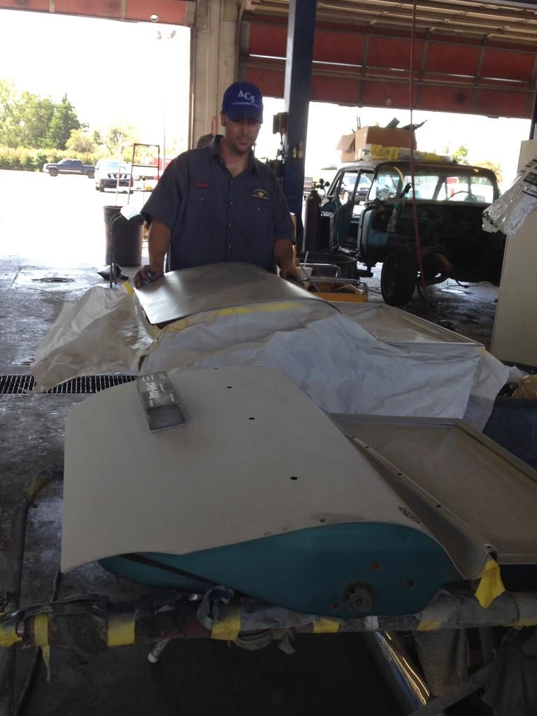

    I believe these are the rear doors, getting ready for paint. The hood will be next.

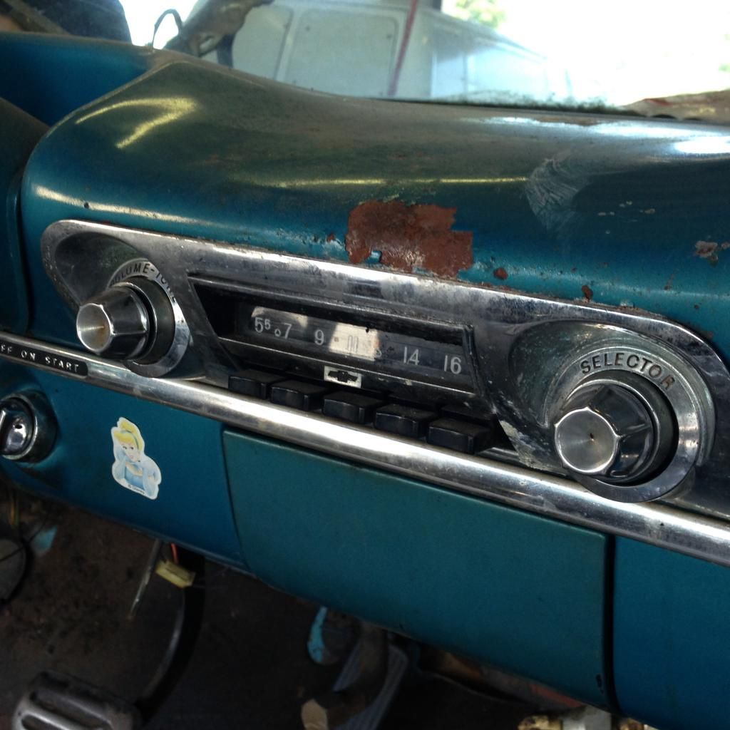

    Better view of the radio. By golly, it does look original. The buttons still work, too.

    retrosound radio lookssimilar to what is in there but has an ipod input

    That radio is original. Dad's '59 had one, and the PO only had it as a 'feature' in the car. I also talked to Dad yesterday about a bunch of stuff, and I brought up the '59; he said it had the inline six with 3-on-the-tree.

    i sold my original radio to a guy in sweden thru ebay

    Stephen said he'll get to work on the rest of the floor areas today, cutting out the rusted areas and fabricating new pans for the front seat footwell area, as well as the area behind the rear wheels.

    I hope to keep this one... I love the look of it. I guess if we want a good music selection, we'll hide away the equipment for it. (ipods don't take up much room - the ashtray, maybe? :))
