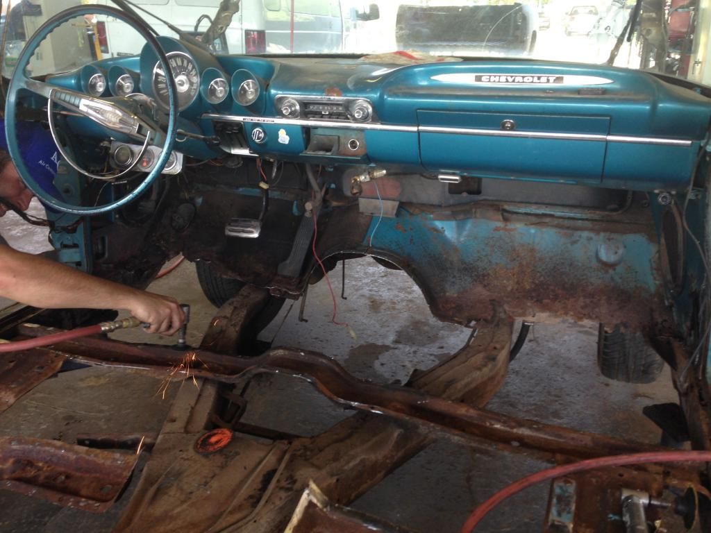

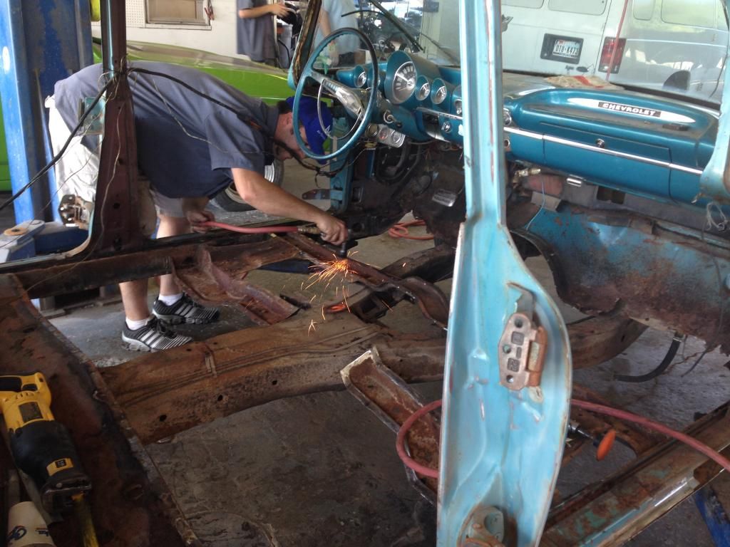

    I went by this morning and ordered the engine and transmission, and saw that they were cutting out the floor to get the new pan in. Lots of sparks flying and a great photo op - but I had left my phone at home (d'oh!). I borrowed the owners' phone and took a couple of pics. Hoping they'll send them to me soon. The guy working on it said he hopes to have the new pan in place by the end of the day today, and he'll finish welding it in tomorrow. I may go back later today and get some pics.

    A few more pics... smoothing over the cut edges. They expect to get the pan in before closing today. It's possible they may have to split it to get it in place, though. Apparently that's not a big deal.... they just weld it back together after it's in place, with a reinforcing strip of metal underneath. Sort of like taping it, I guess.

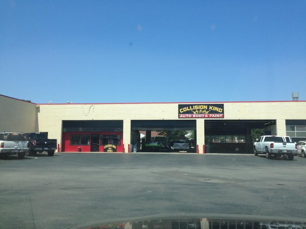

    Here's the outside view of the shop. The owners tell me they're been getting lots more inquiries about restoring classic cars, because people driving by can see the Kingswood and the Chevelle parked in the bays. You can sort of see the Kingswood behind Door No. 2...

    in the pics you posted you can see
    1- how the center section and the framerails are already boxed
    2 - the weakness of the x-frame cars is the lack of outboard framerails
    3- yes that can be the stock radio
