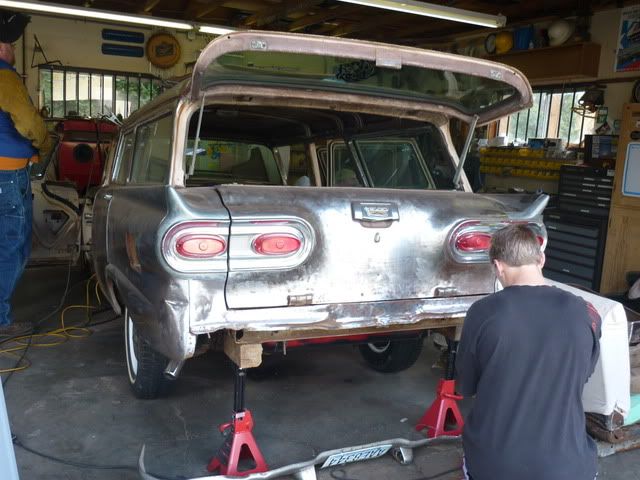

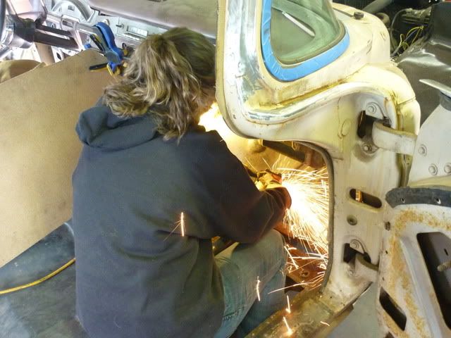

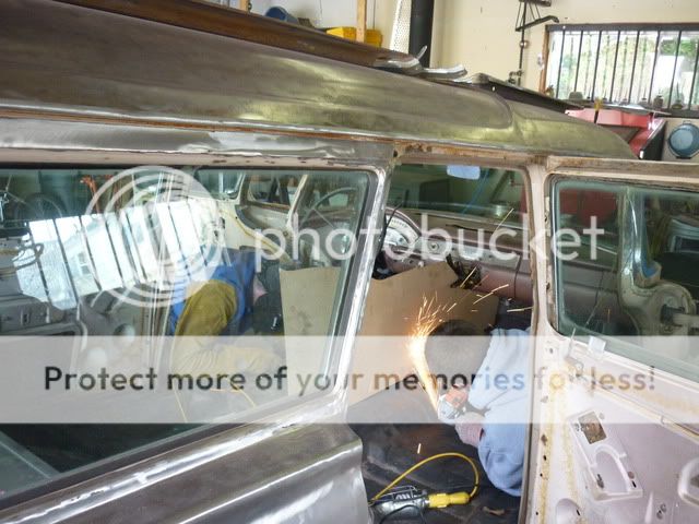

    Session 14
    It's time to patch the floors the right way before we lay down carpet. Another dad from cub scouts is a professional welder and agreed to help us out. We got together on Friday night and worked for 3+ hours to get the driver side cut out and the patch panel ready to weld in. Here's how much we removed.
    When class started on Sunday, Jake got to work cutting out the passenger side.
    Eric explains welding to the students.
    We setup a firewall in the car so we could work on both sides without anyone being blinded or catching each other on fire. Eric worked on welding the driver side while the students prepped the passenger side.
    In the mean time, Zach worked on cleaning up the portion of the body exposed by removing the back bumper.

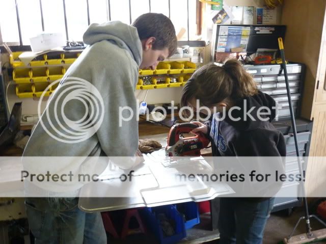

    Zach and Anika trim down the patch panel to fit. The panels are high quality pieces that exactly match the stock floor that we got from hot rods sheet metal: http://www.hotrodssheetmetal.com
    The passenger side had more rust, so Anika cut out part of the toe board.
    Here's what it looks like now.
    We need to use some of the scrap we cut off the patch panels to fill in the toe board, weld the passenger side, grind all the welds, and then paint it all. We're going to try to finish up the floors before the next class so we can put the interior together in the next class.

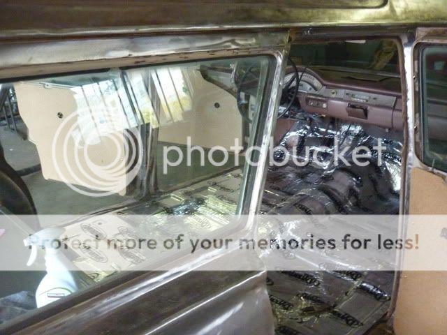

    Today was the day to work on the interior. Unfortunately I only had one student and one helper. Dave and Mitchell worked on the back seat and door panels while I installed Dynamat.
    This was my first time working with Dynamat and it went a little slower than I was expecting. Dave and I kept working past the end of class and by dinner time I had the floor done.
    It took just a little more than one box of Dynamat to do the whole floor, so we have more to work with if we want.
    In the picture above you can also see the new door panels we cut out to replace the warped originals. They still need to be covered, but we were testing the fit today.

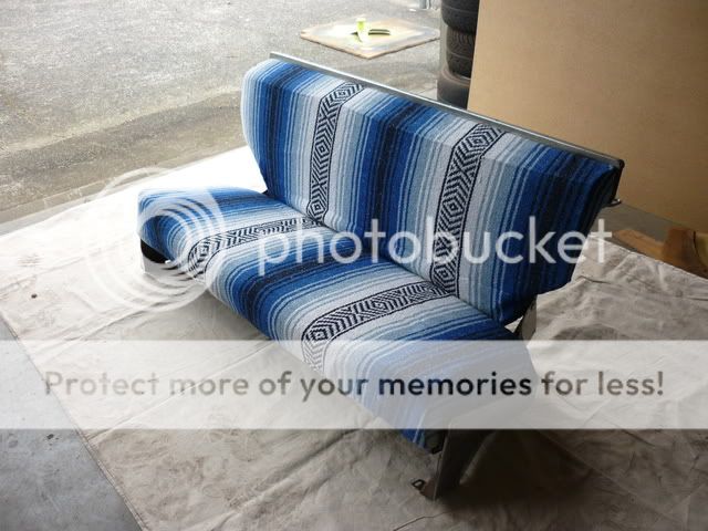

    For a low buck interior, we're doing Mexican blanket upholstery. I'm sure there are people who will frown on this approach, but I think it's turning out real well so far.

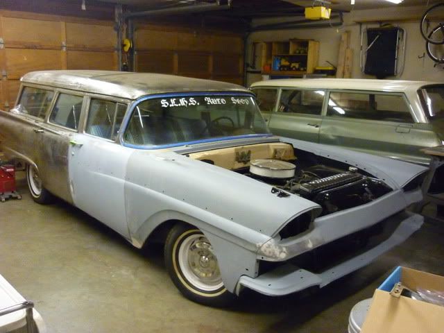

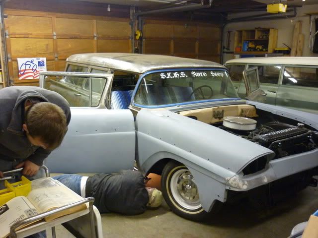

    Sheet metal
    We're going through a long period here with no class - between Easter, cub scout camp, Mother's day... But the guys and I got together this week to work on the car a little. It's getting close to the end of the year and we've still got a lot of work to do.
    We thought we better start getting the front end back together if we hope to get it painted or at least primered this year.
    We couldn't quite figure out how the radiator support shims went on and I was surprised to find this in the manual:
    This has got to be the most detailed manual I've ever seen.
    Now it's starting to look more like a car
