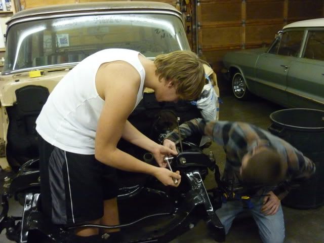

    This week we kept working on the front suspension and got the motor put pack to together. Here's Mitch and Anika assembling front end components.
    Here's how we keep the students on track
    All hands working on getting the motor ready to reinstall

    Sharp looking pitcrew!:thumbs2:

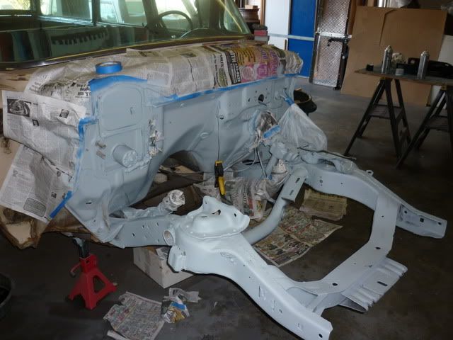

    This week was mostly about cleaning and painting, with a little front end assembly going on.
    Here Anika and I coax the lower control arm bushings into place with the handy Harbor Freight "press".
    Meanwhile, Mitch and Jake worked on the firewall and frame
    By the end of the class, it was looking pretty good.
    Most of the suspension parts are cleaned up and ready to put back on.

    Spit-polished! :rofl2: Nice work. :thumbs2:
