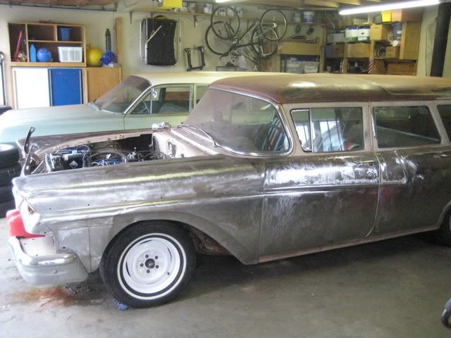

    Project's coming along nicely!
    Saw them scraping on the roof. Now ould be a good time to stick up some Dymat ('Dynamat'? for sound insulation...

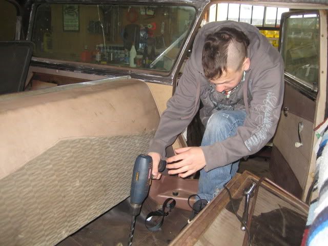

    The goal for this week was to get the car moving under itts own power. While we still had it up in the air the boys installed a set of six retro seat belts that I bought this week. I bought them from SeatBeltPros http://www.gotbelts.com/ and I felt like the price was pretty reasonable. And they are located in Washington state so I got the belts real quick.
    Here's Derek drilling holes for the rear seat (this car never had seatbelts, so we had to drill all the holes). I had to show off Derek's new mohawk, too.

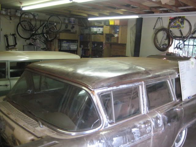

    In the weeks between classes, Dave got busy on the roof and it's now 99.9% bare metal.

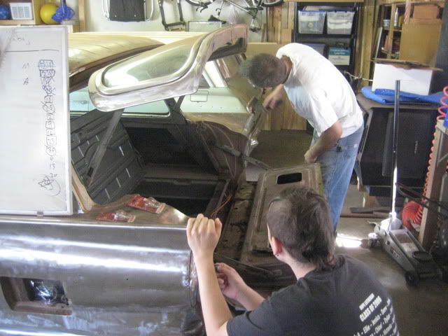

    I had Derek and Dave work on the lights. Everything is pretty dirty and crusty, so they cleaned up the sockets and chrome as well as the whole tail gate area. The innards of one of the sockets was completely deteriorated, so Derek fabricated a new one from materials found in the recycle bin. We also had to replace some of the wiring back there that was brittle and frayed. Jake usually does our electrical work, so it was good to get Derek some experience wiring.

    The tail lights all work now (after taking apart the rest of the sockets and scrubbing out the grime). This is the first early Ford I've ever worked on, so I wasn't aware of the fuse hidden on the back of the headlight switch. Once we swapped that out and fixed the light sockets, they started working. Now we have to replace the brake light switch on the master cylinder so we can be legal.

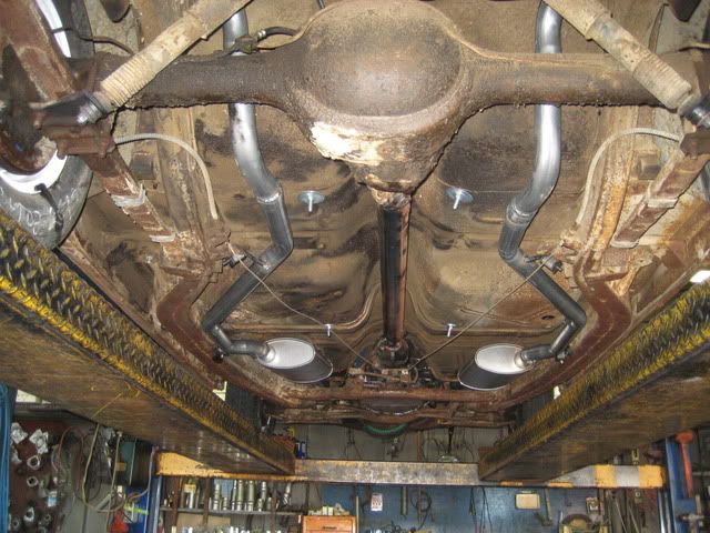

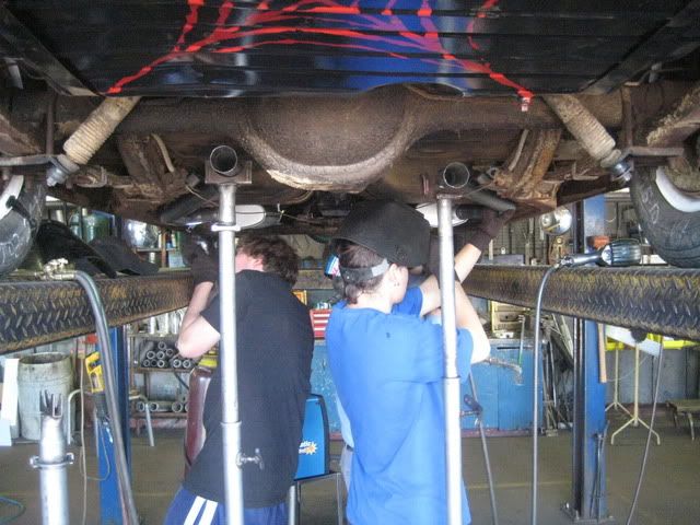

    Today we had a special Saturday class for our 18th session. The Muffler Shoppe in White Center opened their doors for us (they are normally closed on Saturday) and let the boys help build a dual exhaust system for the Ford.
    We were in the shop for over three hours and the boys got to help out the whole time.
    First we took a few minutes to checkout the underside of the car when we got it up on the rack.
    Derek and Dylan were kept busy checking welds and holding pipes in place.
    Here's our brand new exhaust system - the nicest thing on the car!
    I owe a huge thanks to Dave at The Muffler Shoppe. Not only did he open the shop for us on a Saturday, but he did a great job of keeping the boys busy and teaching us about exhaust work.
    Unfortunately, while the car was up on the rack we saw that one of the lower A-arms has some issues that we need to address before we can put any miles on this thing. We might even need a new A-arm.
