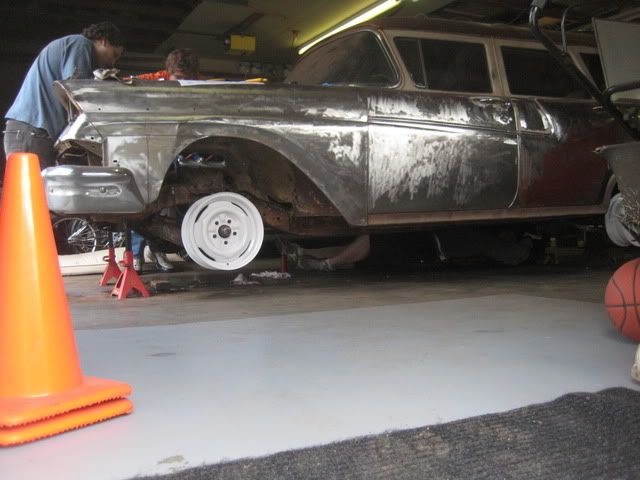

    Session Ten
    Short update this week.
    This week we got the shift linkage and throttle linkage figured out, the ignition switch wired, driveline rebuilt and a coat of paint on the wheels (I finished sand blasting the wheels the day before).

    We were supposed to have class last week, but since all three of my students are football players I thought I better postpone class in favor of the Superbowl.
    This week my helper was on a plane to the Philippines, we had an extra student observing class to see if he wants to take it next year, a couple parents dropped in, and an elderly neighbor stopped in to chat. Despite all this, we got a lot done and had a good time (the unseasonably warm Seattle weather helped, too).
    Jake has proven to be pretty handy with the wiring. He replaced the broken stock ignition switch (for which we have no key) with a couple toggle switches and a push button start. This week we tested them out. It was fun to hear static on the stock radio and see the dash lights come on. Unfortunately, the motor wouldn't fire. He ended up replacing several wires on the engine and got it to start up. It was fun to just turn him loose on that and see it turn out so well.
    Dylan got the drive shaft rebuilt (though I made everyone take turns pressing a U-Joint in place) and got it installed.
    Derek finished up the throttle linkage and got the front seat cleaned up. The back was in pretty bad shape so we decided to strip it and we'll work on padding it and making a new cover for it in an upcoming class.
    I just like this shot with the clean, painted wheels and all the boys working on the car
    In addition to the above, they also got the radiator hoses, pulleys, fan, and belt installed. We are now VERY close to getting this thing moving under its own power.

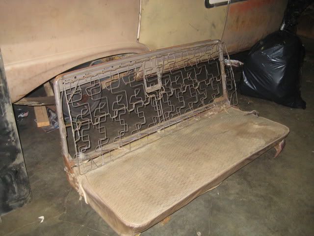

    We were down a student this week and both of the remaining two had short days with one leaving early and the other arriving late. So not a tremendous amount of work done this week.
    We dropped the gas tank to try and figure out why no gas is coming out, but the fuel pickup is impossible to get at and all attempts to clear it have failed. We're either going to have to find something else to use as a tank (and somewhere else to mount it, as the wagon tank is quite unique in shape) or forceably remove the pickup tube and fashion a replacement.

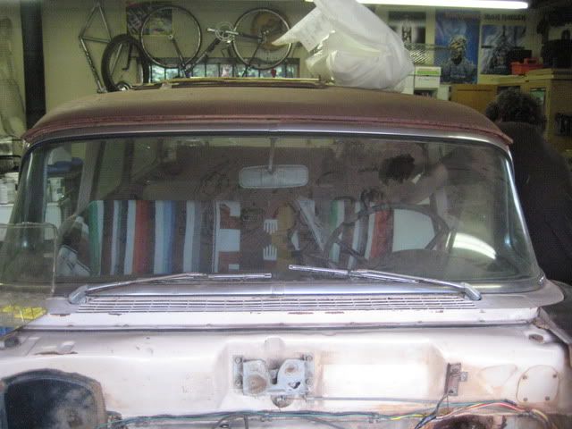

    While I messed around with the gas tank, Derek worked on the seat. We bought a foam toddler bed mattress from Ikea and cut it down to size to pad the back of the front seat, then wrapped it in canvas and applied the classic Mexican blanket.
    The boys have talked about leaving their mark on a hidden part of the car, so they signed the seat foam.
    The end result is quite comfortable. Now I'm thinking we should refinish the bottom of the seat as well.
