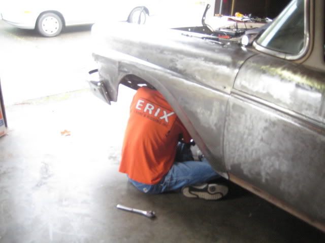

    Here's Jake finding the shortest path to the hard-to-reach manifold bolts:

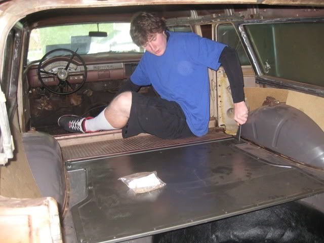

    We also put the rear cargo area back together:

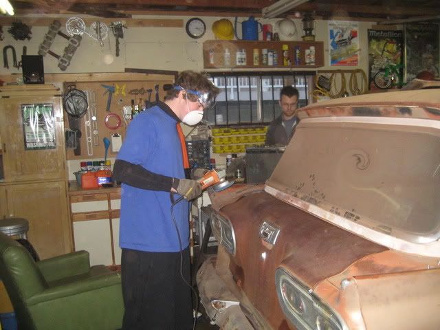

    Dylan didn't want to work on fabricating throttle linkage, so I told him to grind rust (something we'll be doing a lot more of before we're done)

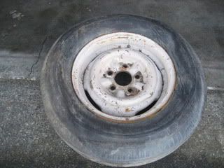

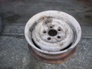

    We didn't have class over the holiday break, but I put in a little time on the project. My dad recently got a sandblaster and I wanted to try it out so I took a couple of the old wheels to the corner Chevron station and got the crusty old tires popped off. Then I took one of the wheels to my parent's place and spent several hours sand blasting (some of this time was spent fixing the air compressor, fixing the sand blaster, etc). Now we need to figure out what color to paint them - after I invest a bunch more time to blast the remaining four wheels. I wish I had a big enough compressor to run the blaster at my place so I could put the students to work on this.:)
    Wheel with crusty old tire:
    Naked wheel
    After sandblasting - it looks so pretty:

    Nicely done. HandyAndy had his powdercoated locally after sandblasting for something like $15 for each wheel. Does a 'like new' job too.
