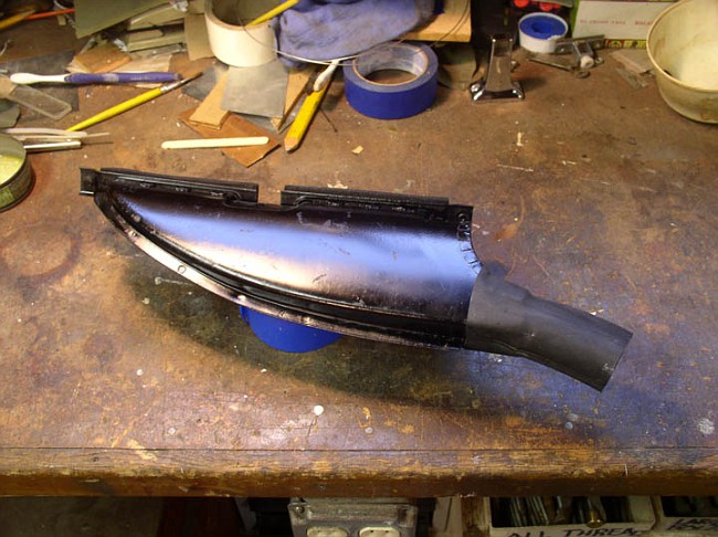

    The mailman finally delivered it! Here it is in all it's sheet metal goodness.
    What you are looking at is a fresh out of the box 1957 Ford defroster duct. The little light tan colored piece above is all that is left of the original "molded in cardboard" '58 duct system. (The rest was like wet tissue paper and I tossed it.)
    It has 6 outlets that feed the trim rail dispersing warmed air evenly all over the window glass from edge to edge.
    The problem is that in '58 some bright engineer decided to move the wiper motor away from the firewall to under the dash where it stayed till...... '69 I guess.
    What that meant to me and my car was that the center two ducts would be in the way of the wiper motor. ('58 only had 4 ducts holes)
    A little quick measuring and 30 minutes with the pneumatic nibbler....
    Problem was... it was too quick. Turns out that I didn't leave enough room for the wiper motor by 2 inches. Only solution was to cut the duct into three parts and seal them up into Left, Right and a "Y" section in the middle with rubber hoses connecting.
    For instance, here is the drivers side.
    All installed in the car with the "Y" piece in the middle. Not happy with the little pucker in the rubber. Try as I could I can't get that out and it does restrict the airflow somewhat to the passenger side. But then, I don't sit over there so... hell with it, I'm tired and my fingers are bleeding.

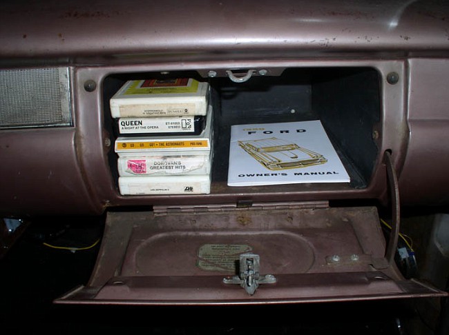

    While I had the tools out, decided to put the NOS glove box in. (Yup, the old one rotted away just like the defroster ducts.) Nice to have a place for a couple old tapes finally.

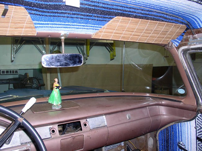

    Incidentally, even tho there was snow on the ground, blue sky and warm sunshine remained above, so I ran a bunch of errands with Queen's "Night at the Opera" in the 8-track player. Another good day! :pub:
    (Really need to paint that dash board.... but ooowwweee the masking and problems that entails.)

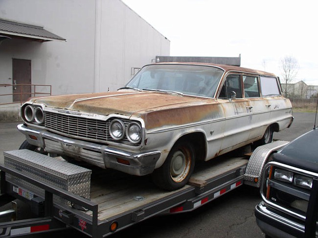

    First off, before I was through with my second cup of coffee, Mark Adams and I moved his new wagon into storage for drying out.
    This is a 1964 fully loaded Impala wagon.
    327 V8,Factory air, 3rd row rear seat, power steering and brakes, deluxe red interior on white exterior. It was pretty nice when new. Now... not so much.
    But, the body work is fairly straight and little rust that needs fixed. This wagon will be come Rat Hole #3 in the business and we have been trying to figure how to keep the patina.
    But... the pass rear pillar needs a patch and the front fender... and then pull out a couple dents... and next thing you know we are painting it. But first, we need to gut the rotting seats, carpet and door panels. If the floor seems solid we proceed. If rusted out, (and seems solid) we can always part it out and make back our small investment.
