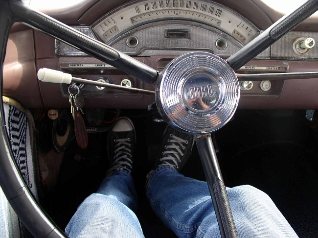

    Update: got the Alt. tested today and it seems to be okay. So I am taking the whole car down to Wayne Parkers Auto Electric on Thurs morning and see why the battery runs down when the headlights are working. Sure was nice driving it today with warm air flowing over my Chuck Taylors!

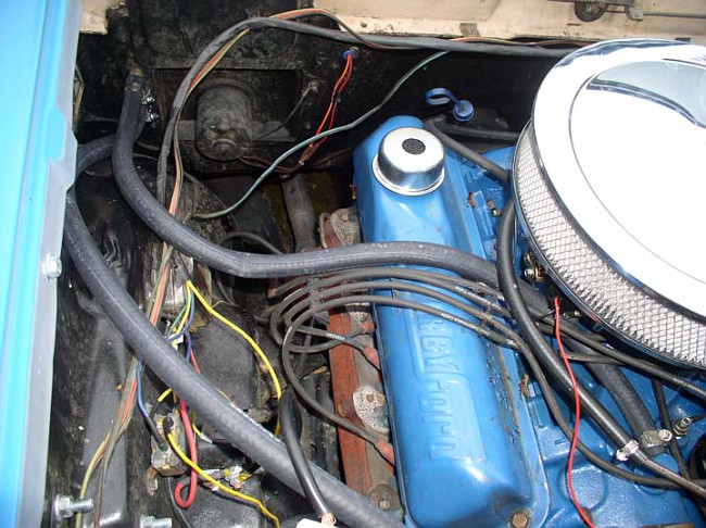

    Mike, I don't know. The car originally had a generator and that was replaced when the guys installed the 390FE motor. The new voltage regulator looks brand new and is riveted closed so no adjustment. Car sat for 2 weeks a short time ago and started immediately so the battery is fine. Only time I find a problem is when I drive long distance with the headlights on which suggests the Alt is not putting out enough juice to power everything and keep the battery up to snuff. The guys (Battery Exchange) I bought the rebuild from said they tested it and it was fine...

    Update: The wagon is currently in professional hands. Be done in about 2 hours and going to cost me $200. to have them fix all the wiring errors. Mark at Wayne Parkers Auto Electric said that when they put in the new electrical system some of the wiring connecting the old system to the new was hooked up incorrectly. Plus I installed the electric choke on the Edelbrock to the wrong points... plus that nagging "GEN" idiot light kept bugging me so I pulled the bulb a while back... which messed up the Regulator.

    Update: All done and works perfect!
    Doesn't look like much but now the "Alt" dash light comes on till the engine is running and will notify me when the system is not being charged, just like it is suppose to. Turn signals work normally and headlights are bright! No more run down battery problems... whoohoo!
    Justin, the expert, replaced the regulator and even replaced all the wires with the correct colors to match Ford colors so any mechanic (not me) would know which was what.
