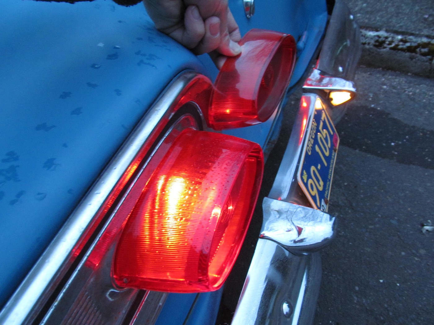

    Sun is just coming up and it smells like rain is coming. Perfect time to take pictures.
    As you can clearly see they are deeper than the originals. No problem with bumper clearance on the tailgate, but they do stick out like erect nipples more than the originals.
    My thumb is covering a faded spot on one of the originals. Guess the heat of the lamp faded out the red tint after 60 years of use.
    These new lenses are NOS sold for $8.00 each on eBay. Seller said they were for a wagon, but they are not.
    Also noticed same seller is listing them as pickup truck lenses and they are not.
    Guess he just got a gross of them and wants to get rid of'em.
