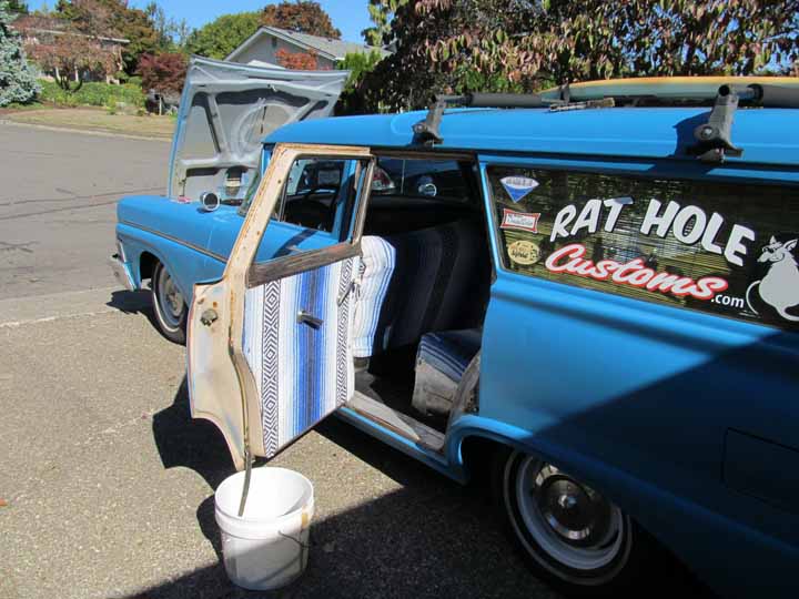

    Been a month since I worked on the car so thought I would make some improvements while the sun was out. About a year ago I purchased some door seals.... but never put them in while the weather was good.
    BUT.... we had a thunderstorm last Wednesday on the way home from work. Hail, brimstone and pouring rain, so I pulled over to let the storm cell pass.
    While listening to Led Zepplin on the 8-track I noticed water pouring in the rear doors.:49:
    Seems I forgot to change the seals when I had the chance.
    Results= wet carpet yet again.

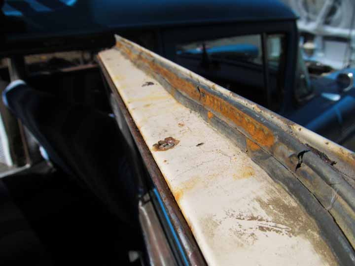

    Here is a view of the old seals all cracked and bleeding after 50+ years of age.
    And here is the finished door seal. Now I really have to slam the door shut. :dance:

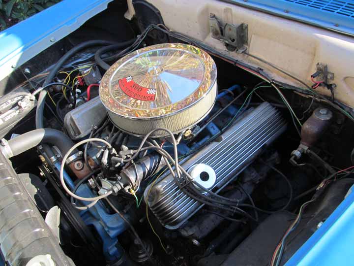

    And the mighty 390! Arrr arrrrr arrrrrr.

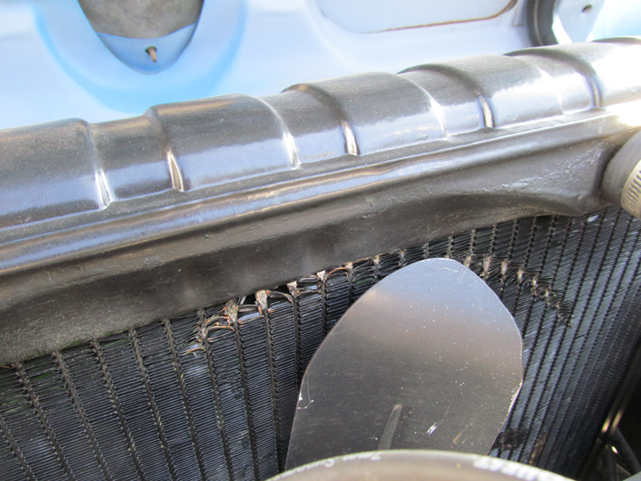

    The radiator saga continues with part 3. [​IMG]
    Drove down to Albany for some slot racing last night. When I got there and was carrying boxes in I noticed water dripping from the front end. Quick check revealed antifreeze. A sight I had not seen all summer long once I got the badly sealed seam on a BRAND NEW radiator fixed.
    Seems the engine mounts are not what they should be, because the engine obviously slid forward during a panic stop. (Brakes work)
    I can still pass my hand in front of the fan so... somethings loose.
    Took the car down to Sam's Transmission and he put it on the lift. We shortly found that the transmission mounting bolts were not only loose but neither of them had any business BEING THERE! ARRRRRGGGG.
    Two new correct bolts and everything is solid again, which necessitated yet another trip to Mac's Radiator. First words out of Denny's mouth, who worked on this radiator just a scant few months ago, was "I just fixed that"!
    Thanks Denny...
    But he also said that it might be an easy fix since the unit is still fresh and not corroded. The gouges in the fins are there to stay unless I want to take the time to bend them all back into something resembling a cooling unit again.
    Price is pretty cheap so that will be my next step. $45 to $90 bucks total if I pull the unit and deliver it. Sam didn't charge me anything so I think I'll get off pretty good with this one.
