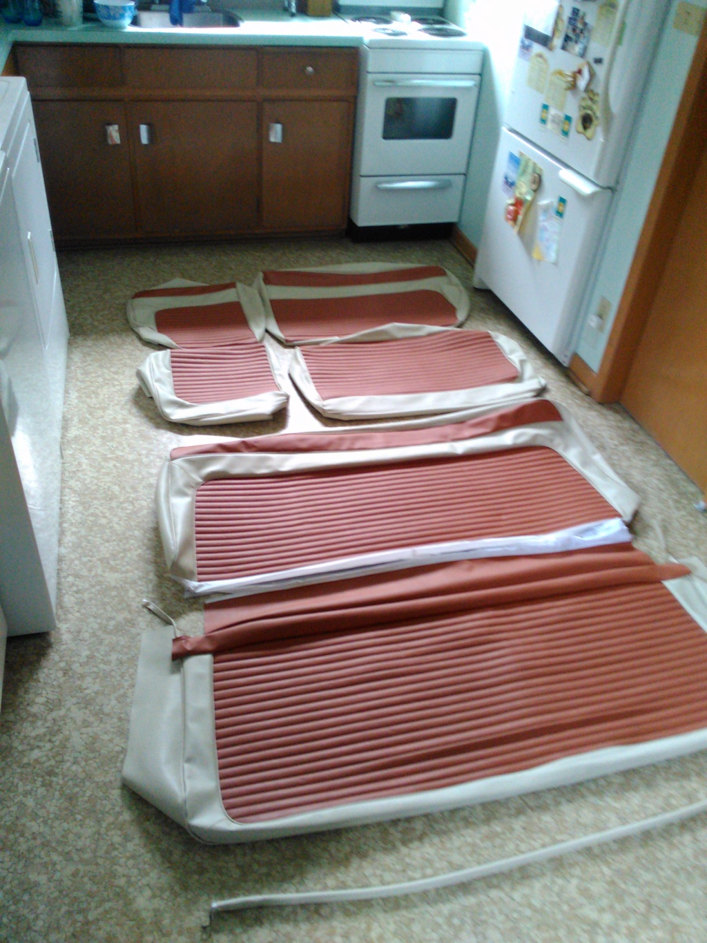

    Shortly after Labor Day, I visited my friend Pat (BuickEstate). He is building the seats and helping me with the door trim panels.
    The seat covers are looking great!
    He developed patterns for the door armrest covers and he sewed the parts while I was there.
    We were not able to build any of the main seat parts, but we determined what still needed to be done before we could install the covers on the frame & spring assemblies.
