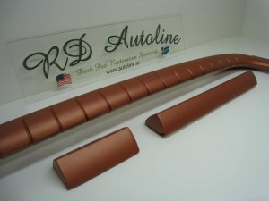

    I removed the foam and trim from the dash pad. I will repair the rust damage on the metal core before shipping it out for new cover and pad installation.
    I found several recommendations for RD Autoline in Sweden. They have already made the correct part for 58 Buicks.
    Here's a photo from their product gallery:
