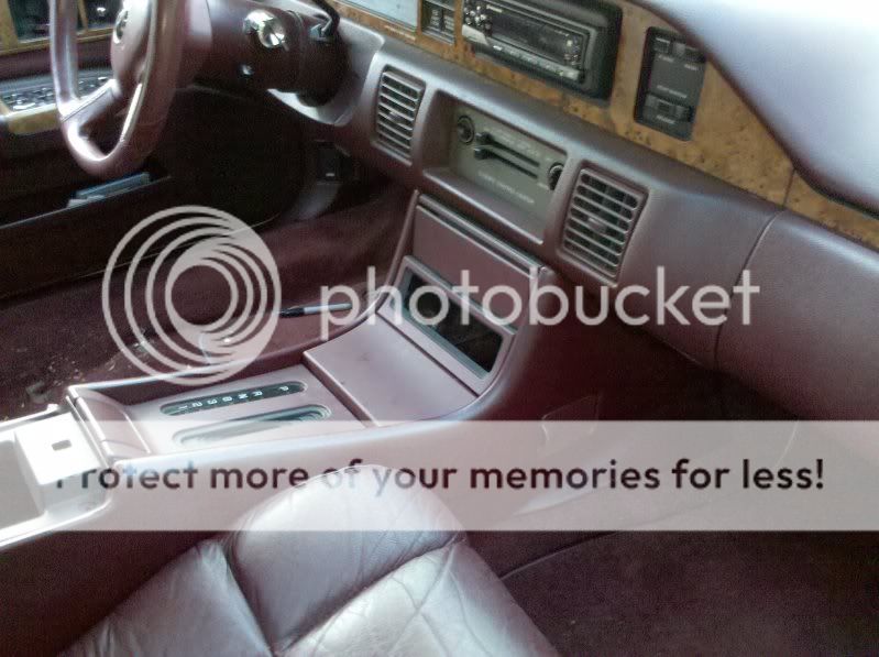

    Started my Riviera console install yesterday, did 95% of the triming to fit. A little more then I'll wire up the lights and power ports and start in on the brackets for the shifter and console,
    Initial fit before triming.
    After a few hours of triming it is pretty close, it's starting to look like it belongs there!

    Nice work! :thumbs2: Always tough to add them where they never were.
  3. Krash Kadillak
    21,109
    2,062
    Another 'twin stick' automatic transmission.....LOL
    What year Riviera is that console from?
    Looks like it was made for the Caprice as well....
    I know some B body guys have used '98 - '01 Blazer / Jimmy consoles. What are the differences?

    Nice job - looks like it always belonged there...(y)

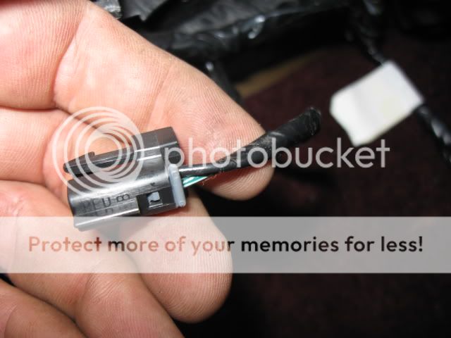

    Did some more triming and wiring...., as went along I realized that I had removed some plastic that I didn't need to, I will detail that later for the next person who tries this, everything is fine, it was just extra work I didn't need to do.
    The console now ready for brackets

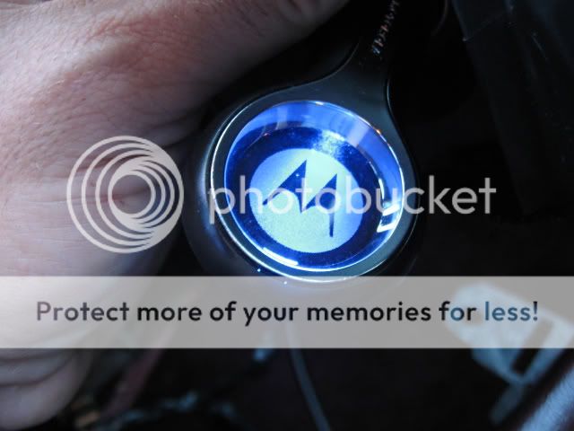

    I wired up the lights, cigarette lighter (it will power my touch screen) and the power port.
    Removed the 7mm screws that held the ashtray and junk box

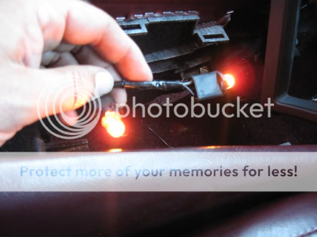

    the ashtray light will provide power to the console lights, since both are GM, they are even the same color. I will tap into the lighter to power and ground the power port
    These are not needed, they are for the sissy "cant shift out of park without the brake on" solenoid
    power to the lights
    power to the lighter
    power to the power port!

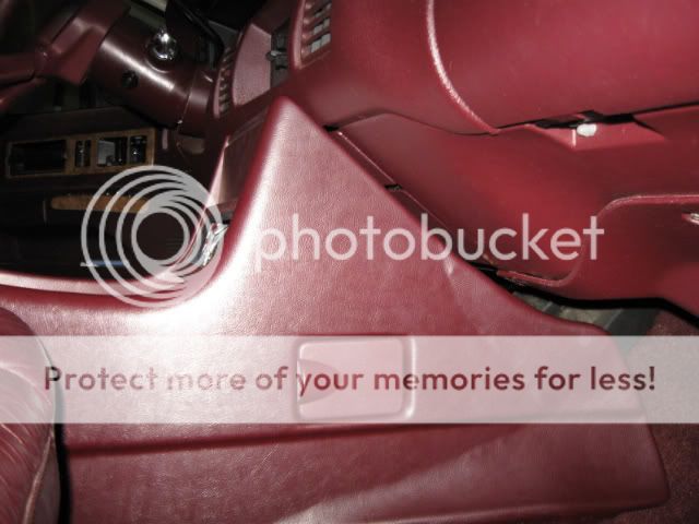

    This where I left off last night. I still need the shift cable setup but it's getting there! I wanted to be done before Wagonfest West but no dice.......
