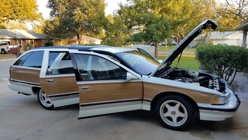

    SO I did some oil changing this weekend...thought this might be a fun topic, since it's fresh in my mind.
    - Starting with my 1996 Roadmaster wagon - 5.7 LT1, you jack it up under the crossmember under the oil pan, and throw a jackstand under it. Next, grab the drainpan, socket wrench, new filter, and some paper towels. Lay down under the driver's side front fender/door. The oil plug is at an angle and points toward the side of the car, and the filter is right beside it, hanging down and really easy to access. Drail oil, which because of the plug hole angle drains smoothly right into the pan, remove filter, replace with new filter, install plug, easy. All can be done in one spot..no fuss! Refill with 5qts...done. Total job takes 10-15mins.

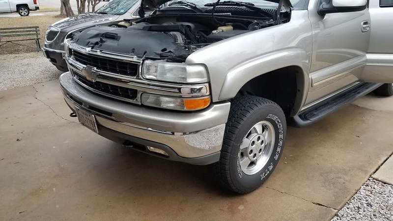

    - Next, 2002 Suburban 2WD, 5.3 LS, you jack it up under the crossmember under the oil pan, and throw a jackstand under it. Next, grab the drainpan, socket wrench, new filter, and some paper towels. Lay down under the driver's side front fender/door. The oil plug on the 5.3 is vertical, and points toward the rear if the truck. The filter is on the left side of the motor above and behind the exhaust manifold. Drail oil, which because of the plug hole location streams rearward...you have to place the drain pan behind it to catch the stream, and then slowly pull the pan forward as the stream slows so not to leak all over the floor. Next, remove filter, which is not hard with a filter-bottom wrench, but with a ring-wrench you have to reach over the crossmember and exhaust manifold to get the right angle..then replace with new filter, install plug, not a hard job, but a little trickier and messier than the Roadmaster . Refill with 6qts...done. Total job takes 25-mins.

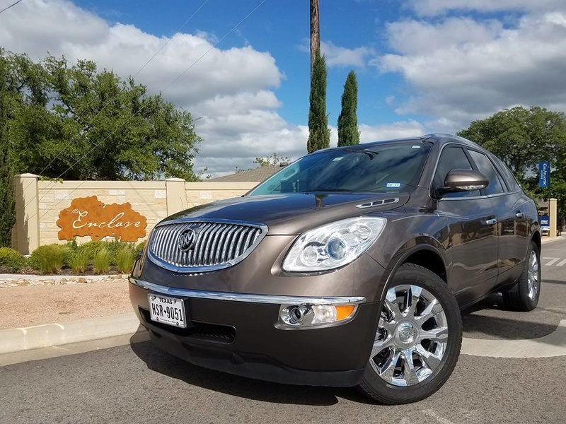

    - 2012 Buick Enclave FWD 3.6 V6 - you jack it up with the front subframe, and throw a jackstand under it. Next, grab the drainpan, and A LOT of paper towels. Lay down under the front of the vehicle and shimmy back under the motor. The oil plug on the 3.6 is angled and points toward the rear if the truck, but being at an angle...is easy to aim at the pan. This part is not hard.....but then there is the filter... SO re-install the drain plug and lower the vehicle back to the ground. Next, lean over the radiator cover and look downward between the radiator and the motor itself. The filter is on the left side of the motor about halfway down, sitting above the front motor mount, and below and around on the the fan motor...you can just barely see the end of it. It sits horizontally and points toward the front of the vehicle. To remove filter, first put the drain pan under the approximate area where you think most of the oil will fall. Then carefully snake the filter wrench between the radiator fans and engine, while swearing loudly as sharp objects cut into your hands and arms. Once you install the wrench...by feel, you have about a 1/4 inch of room to move the wrench, so continue to swear and slowly break the filter loose about a 1/4-turn at a time...you'll know it's loose when you see/hear the oil draining all over the lower motor mount and subframe...and please know that at least half will miss the drainpan as it runs all over the components and subframe down there. NEXT, slowly remove the wrench. NOW the magic happens. In an attempt not to spill the rest of the oil still in the filter all over everything, turn the filter by hand until you feel it come off the motor, THEN loosen your grip just enough to let the filter pivot...the oil coating your hand and the filter itself with aid you here, and the idea is to let the filter pivot downward so the open end is pointed up...keeping the remaining oil in the filter. Now, if you have not dropped the filter, slowly lift the filter out, snake it up, again while cursing GM and the vehicle itself as your oil-covered hand is gouged by sharp objects. Once the filter is out, wipe off the oil drips from the radiator cover and front bumper, and sop up as much oil from your hand and arm as you can, while looking for deep gouges and blood drips. Now it's time to install the NEW filter. Slowly snake the new filter down, wincing as sharp things poke you, and the fun part here is you can only see the very end of the filter, so you have to blindly poke the filter into the area where you think it goes, and then move and spin it at different angles trying to get the threads to bite...cursing here tends to help..a lot...and it will finally spin-on one you say best bad word... NOW pull the oil pan out and put it aside. Now get your Simple Green, Purple Power...ect, and soak the front of the motor, motor mount, subframe, and any other components that are now covered in spilled oil...let sit while you use the same stuff on the oil on your hands and arms, wincing as it burns, then take the hose and spray all the mess off you and the car,not forgetting to spray under the vehicle too. Add 6-quarts of new oil (DEXOS ONLY..$$$), then back the vehicle onto the street, and now use the hose to blow all the water/oil mess down the driveway and out into the street too..don't want to kill the grass now.. Total job takes around an hour..depending on your curse words and bloodletting. Don't forget to clean your hands and arms, and use Neosporin on any deeper cuts please.
