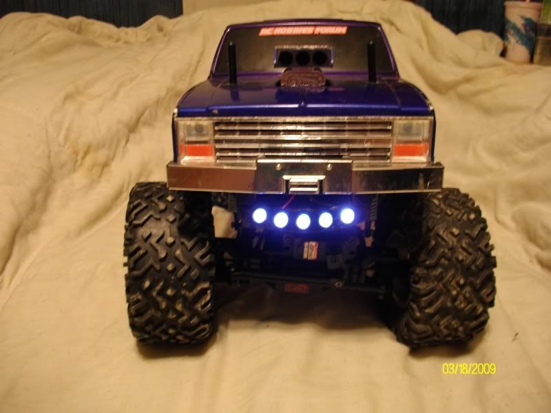

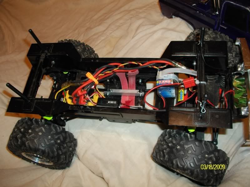

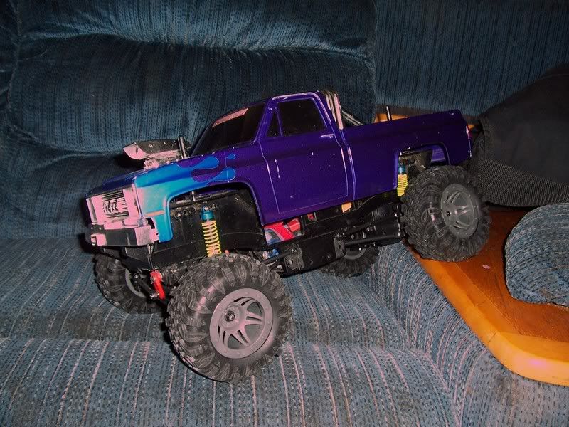

Thanks bro. I have 2 cliff climbers myself. Its simple yet works good. I am going to add BaneBot 390 motors, they are dirt cheap($5 each) and improve the Clod Stall. Clodstall is what you get when the truck starts to climb and the rear axle motor about stalls out and the front does 80+% of the work. This is one that I used a Clod Buster chassis and body to make a trail truck out of. Then once I upgraded it I added LED Lights IMEX Rubicon tires Duratrax Overlander wheels 6.0v RX battery pack for the LEDs Made filler panels for the holes in the side of the chassis Lowered the body 1/2 inch and raised the susp 1/2 inch for a lower body stance, but more ground clearance. Added the Blank Chevy Grille some cool buddy of mine gave me.*
