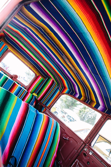

  6. Fat Tedy
    Give it a Mexican theme on this re-do.............
    :dancing:

    :biglaugh::rofl2::biglaugh:
    That's more Californian than Mexican! :slap::rofl2:
