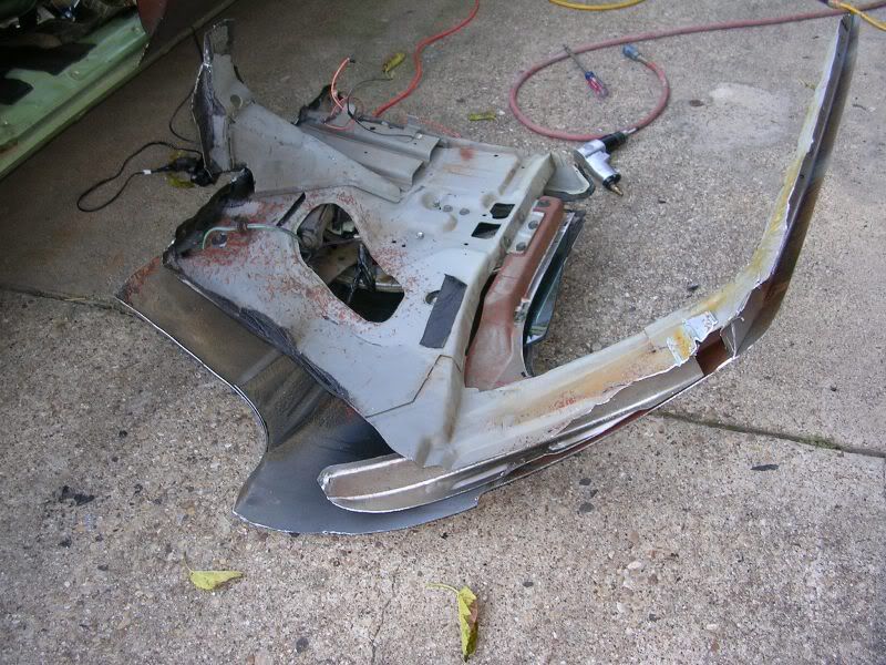

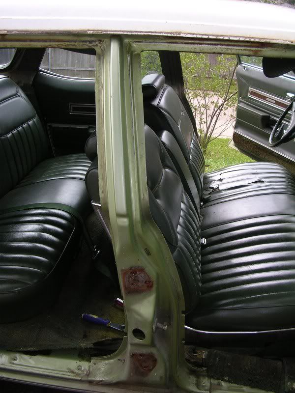

    I began by carefully studying, making templates and double-checking measurements before cutting anything. Then I made my first irreversible cut...the passenger side center pillar.

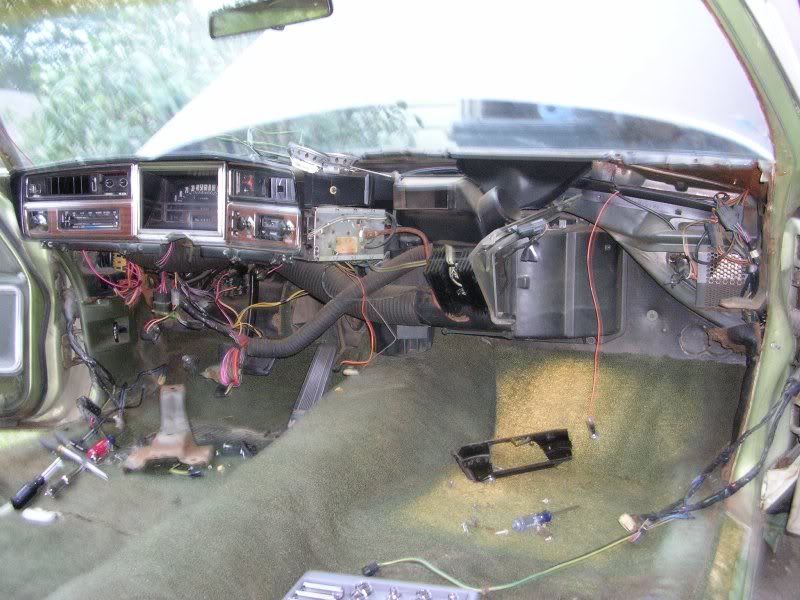

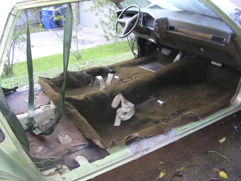

    Then, I removed the interior, dash and damaged steering column, replacing it with the Limited's dash and column.

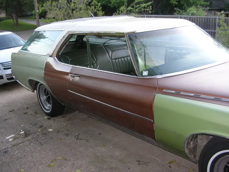

    Now to fit the coupe doors. They fit perfectly! Now I am getting excited! :29:

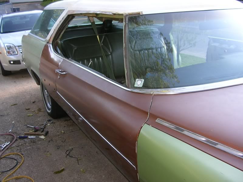

    Next, I cut and fit the quarter...this took a lot of measuring and template making before actually cutting this all-important part.
    I decide to keep it all in one piece...roof and quarter. The wagon required not a single modification other than the initial pillar removal. The quarter fits right into the opening. The inner brace meets up with the floor just as it did in the parts coupe. These big Buicks are almost identical in rocker panels and floors.
    The panels match up perfectly, as do the body lines and door gaps.
    I think it worked out even better than I imagined it would. :bouncy:

    Interesting and brave to say the least. Having trouble grasping the overall effect with the pics all so close up. Be watching this to see how it unfolds.

    I agree, Scott. Also, with it being two colors, it is hard to see how it flows. I will be stripping the paint soon, and it will all come together visually. :clap:

    Yeah, I replaced the entire steering column, wheel and dash pad. I changed my radio from the AM 8-track to an AM-FM stereo and had to wire the new column for cruise, because the wagon has it, but the coupe didn't. I won't need to change the intrument cluster or much else, but I will need the correct power lock switches for the coupe doors, as it didn't have p locks.
    These big Buicks are the easiest cars to work on! Pure simplicity. This, along with my new 71 98, is my first older GM and I really enjoy how well done it is. :jumping:
    I am used to 60's Continentals and T-birds, where it seems they built the cars around the engines and dashes...a real challenge to work on them. :slap: They are magnificent designs, and incredibly well-built, but frustrating.
