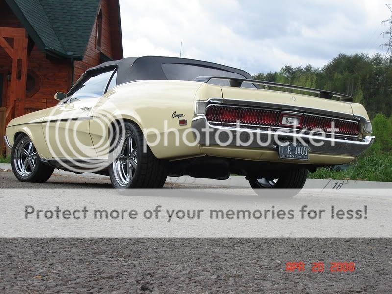

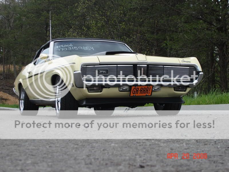

    Are you wanting the same width in front and back, so you can rotate? Or, are you considering staggered? If you want the same size, the front will be the limiting factor on width and widest tire size. I've had several smaller Fords, Fairlanes, Cougar and my intermediate Ford wagons, so I can't say for sure, on your larger Ford. But, I would say an 18x8 (maybe 18x9) would be the widest on the front with maybe a 245-255 width tire. If you wanted to go staggered, you could probably fit a 18x10 with a 295 width tire on the rear. Offset would pretty much be 0, or maybe a little neg offset. So, you won't be able to use newer model Mustang Bullitt rims, unless you use a decent sized spacer. Personally, I would go with a 17" rim, just to add a little more sidewall. Here's a pic of my Cougar on staggered 17s.

    I can see that many members are following the Sheep. Tires should fill the wheel well opening but not dominate the looks of a vehicle as they are beginning to do.
    The Cougar looks perfect
