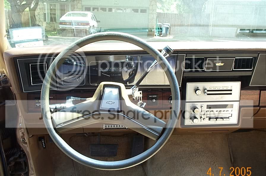

    There is an easy solution for your Caprice. I installed the factory optional gauge package on my '86 Caprice Sedan. You just need to grab one from the salvage yard, and also bring your wire cutters and cut off the cluster plug too.
    On your existing car, you use the cut off plug as a model and move the pins/wires around on your existing plug until they match. You will also have to replace the oil sending unit, get one for a gauge, not a light.
    It's an afternoon install. I LOVED mine. See before and after pics below!
    Before- As purchased:
    After - Installed full gauges, Celebrity Eurosport steering wheel, and wood trim around radio and climate control from a Caprice Brougham
