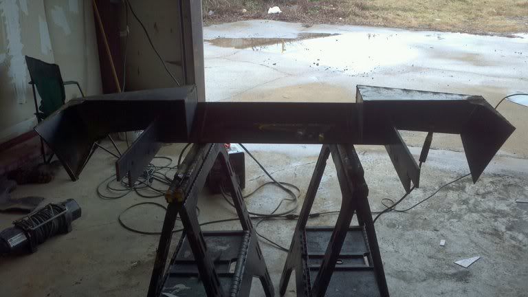

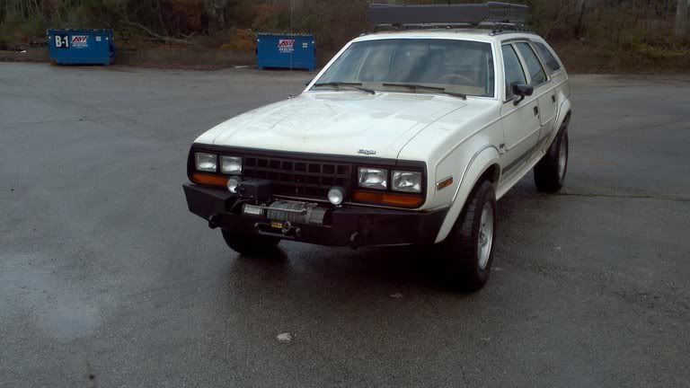

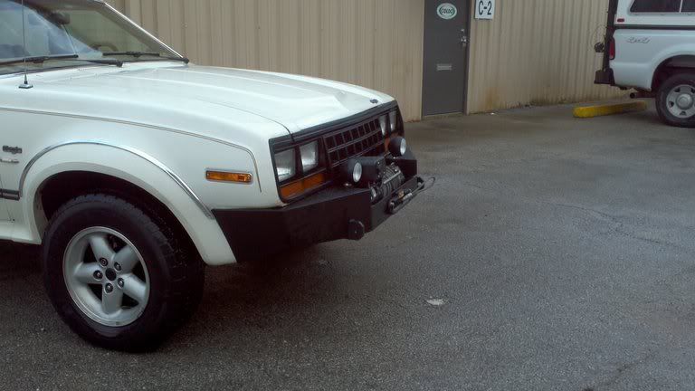

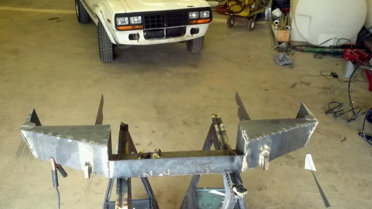

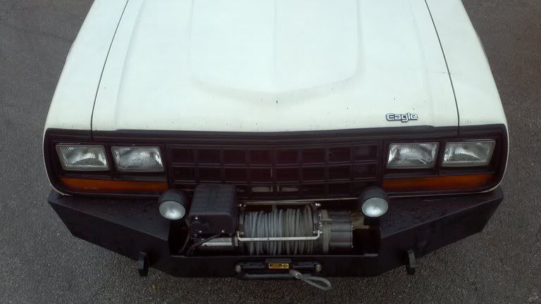

    Ever since I built the rear bumper with tire carrier, I've wanted to build a front bumper. Well, I finally made the time to do it. It took a few days but got it done. I didn't take many pics of the build like I did with the rear bumper so I can't go in as much detail.
    I started with a piece of 1/4" steel that I had made for the winch. I believe it was 8"x 33 1/2" and a 4"x 33 1/2" piece

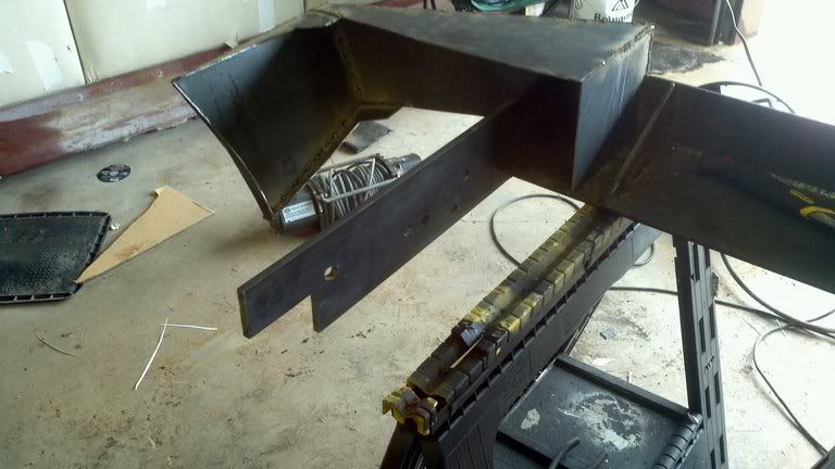

    welded to make an L. I then took 2 24" pieces of 3/8x5" flat stock that I made the frame mounts out of. I removed the bumper brackets and installed the 3/8" steel to the unibody using one of the bumper bracket bolt holes, a steering box bolt on one side and idler arm bolt on the other side. I also added 2 more 1/2" bolts that I drilled through the frame and sleeved. I bought premade recovery points that are made out of 3/4" stock. The rest is 1/8" steel. The winch is a 9,000 lb Harbor Freight Road Shock that I got in a trade. I am going to upgrade to a Warn some day in the future.

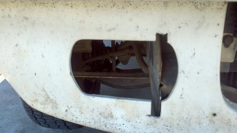

    I had to notch a little bit of the front valance for the mounts.
    Here's my 79 year old uncle stick welding the 1/4" winch plate to the 3/8" mounts. All I have is a 120v welder and wanted to make sure the critical stuff was done right.

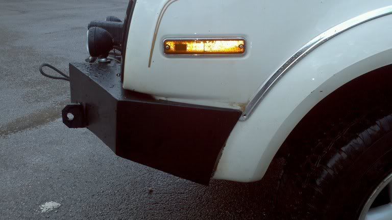

    Here is the only place I ran into trouble. The steel moved during welding. I guess I got too much heat in that area. I will have to figure out how to fix it.

    Great job Eagle Freek! Can you add a small angled filler at that top side to blend with the curve of the fender? Or just leave it cause it looks great!
    Or cheat and paint that small area of the body black. :lolup:
    I just double checked. The other corner looks perfect.

    I'm far from being a fabricator. There was alot of grinding of crappy looking welds and some body filler involved. One day I decided to buy a welder off of Ebay and figure out how to use it. Most of my career I've been a carpenter and that experience has come in handy with my car projects. Accurate measuring and a calibrated eye are great assets when doing this kind of stuff. I've come up with a plan to fix the left side of the bumper but won't have time till the end of the week to attempt it. It really bugs me, there is no way I could leave it.

    Eagle Freek, I hated to even mention that little boo boo. I could never do that well. But I figured you'd end up making it perfect in time.
    Still those other suggestions sound good. After all, it is for work!
    I'd just tell people you had to pull an eighteen wheeler out of a ditch and the angle you were pulling sprung it.:clap:
