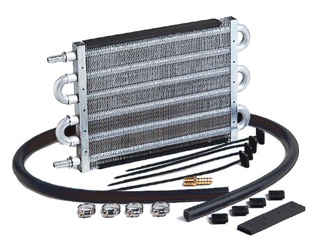

    Hey all, I got a 1963 ford country sedan, I had the engine rebuilt a few years ago and now I am in the process of connecting everything. I was wondering if for the transmission fluid lines if I should just bypass the radiator and just add a transmission cooler?
    I have something like this one already that I never installed in a different vehicle. https://www.summitracing.com/parts/...9jGW93WoYyfRafeY1FtSvNr7TX5c16GAaArBIEALw_wcB
    Thoughts?

    I would. I'd run it to the cooler mounted in front of the radiator if it were me.

    No! Just buy a decent tranny cooler, skip the radiator part, and run the tranny lines to the cooler. I used to use old refridgerator units in cars , trucks, and motorhomes. I used a 1965 Mustang fastback to pull a fold down RV for years with 289 and 4-spd.
