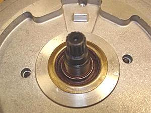

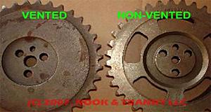

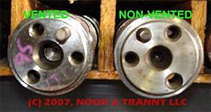

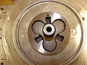

    Here is some Optispark info I've had bookmarked for years:
    The LT1 Optisparks are very similar between years, but there are only 2 styles : 1992-1994 and 1995-1997. The 2 cannot be interchanged without front cover and camshaft modifications. There are 3 main differences in the units : drive method, ventilation system, and electrical connection.
    Vented Optisparks have 2 small vacuum line attachments. These attachments allow for engine vacuum to remove moisture from the Optispark unit.
    Non-vented Optisparks have no vacuum line attachments. Instead, 3 small holes are located at the bottom of the unit to allow for ventilation. This causes failure when driving in rainy weather or through a puddle.
    The Optisparks use 2 different drive methods : Spline drive and Pin drive. On spline drive system (92-94), the Optispark has a splined shaft that mates to the camshaft timing gear. The gear is clocked so the shaft only goes in 1-way for precise timing. On the pin drive system (95-97), a pin extended from the camshaft runs through the timing gear and into a slot on the Optispark, and the shaft from the Optispark runs through the camshaft center for better bearing support.
    Non-vented:
    Vented:
    CONVERTING FROM NON-VENTED TO VENTED OPTISPARK
    Some advantages of the vented Optispark are (1) the ventilation system allows for a longer life span and less misfires, (2) the bearing and drive method allow for longer bearing life, and (3) the larger diameter front seal reduces the change of oil leakage through the cover and into the Optispark. You can convert from a non-vented Optispark to a vented Optispark by changing the Optispark unit, the front timing cover to a 95-97 model, camshaft timing gear to a 95-97 model, adding the vacuum lines, and changing the Optispark extension harness to the later model. The camshaft does not necessarily need to be changed, but you will need to drill the cam centering hole deeper for the Optispark unit to slide in all of the way.
