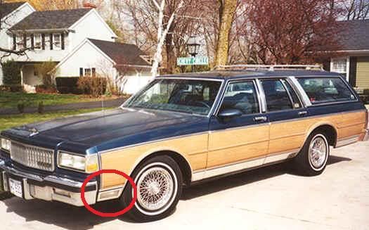

    Does your wagon have the optional cornering lights ?
    I had the same problem with my 1983 Caprice wagon.
    In the end I found out that a previous owner wired up the cornering light to the right hand front side marker light....[​IMG]
