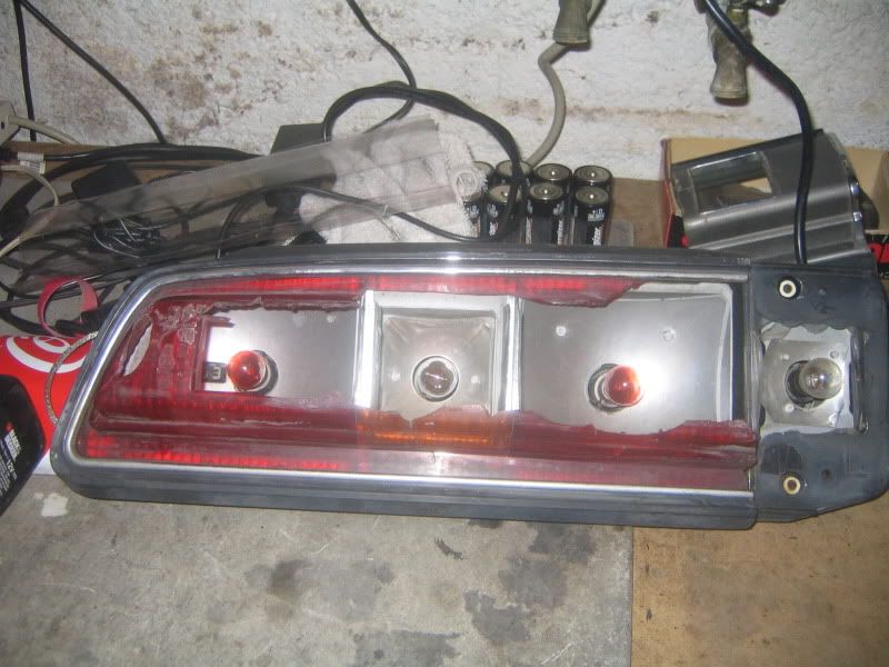

    So what to do about a hard to find, rare car tail light when there is not enough of the original lens remaining to simply patch up with lens tape?
    Here is my first attempt at trying this technique.

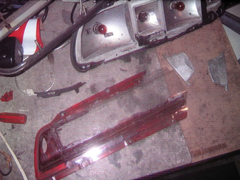

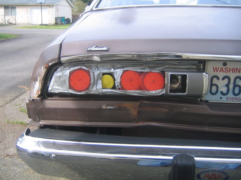

    Ok, the duct tape and gate marker reflectors worked for the short term, but since it could be a very long time before I locate a replacement, I wanted something that looked better and would be a more durable temporary fix.

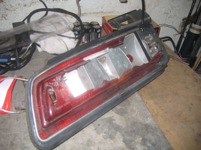

    As you can see, there is a lot missing. (red sharpie marker on the bulbs works in a pinch, but does not last very long)
    This isn't a simple flat lens, it stands out several inches and rises in two steps.
    It gets taller and wider towards the center of the car.

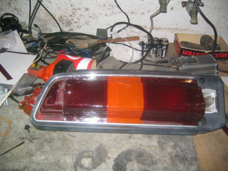

    I used a sheet of clear plastic from the packaging of something I had bought and trimmed it to the correct width. I began bending it to match the contours of each step in the base of the lens. I used hot glue, so that it would not be permanent and I could make another attempt if it did not turn out well.
    Once the shape is formed and attached, apply the lens tape to the new shell.
    Reassembled on the car. Not perfect, but a much better looking temporary repair. Good enough to be legal, and should last quite a while.

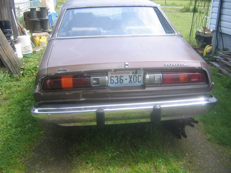

    1974 Toyota Corona Mark II - MX13
    I would want the entire assembly if one was available.
    The backup light housing has broken assembly bosses and is clinging on for dear life.
    I am also missing that corner chrome trim and the rocker trim. The trunk trim may be salvageable.
