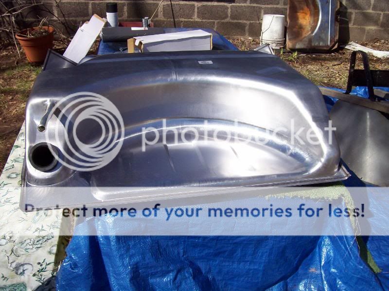

    Last Thursday and Friday were spent productively. My new gas tank and sender had arrived as well as the battery box parts.

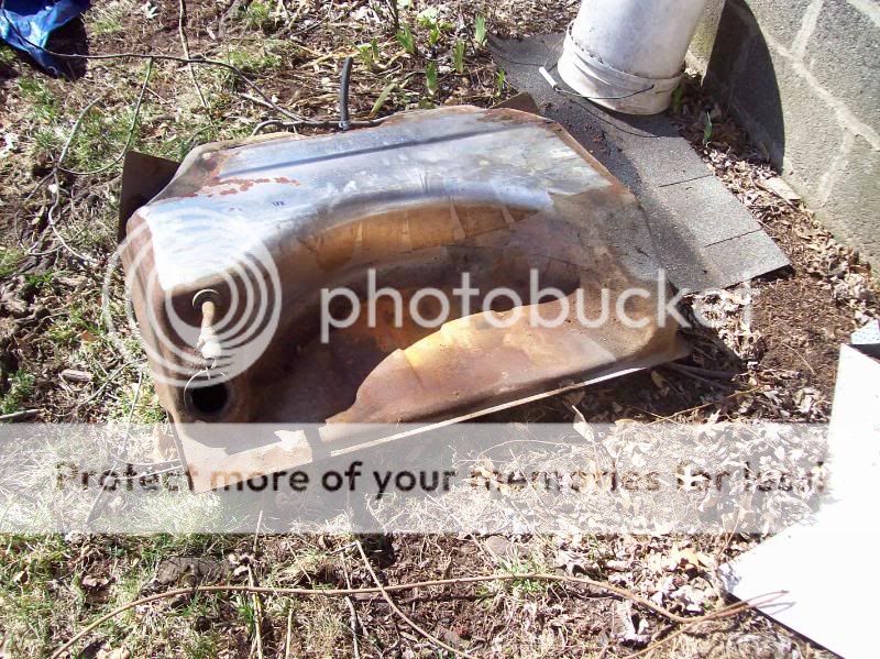

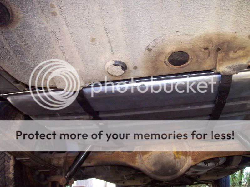

    The weather was beyond perfect in NJ for working outside. Just about 70 degrees and sunny. I crawled my fat butt under the back of the wagon and removed the leaky gas tank. It is a bit of a job by yourself, but I was determined. Here is a pic of the offending unit.
    Here is the makeshift repair done by the previous owner.
    I wire brushed and painted the straps and installed the new tank and sender with new j-bolts for the strap and a new insulating pad on top of the tank. Fit perfect. It is a Spectra Premium tank.

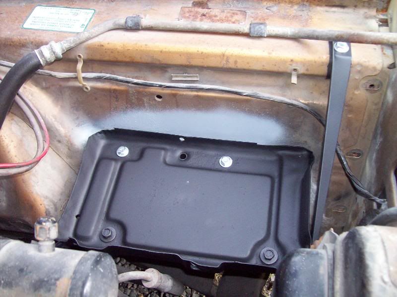

    Next I took on the battery box. Look here real closely. You can see some rusty bailing wire holding up the battery tray which was missing all the brackets.
    I purchased new brackets and bought some bolts and washers at the local hardware store.
    I painted them up and bolted them in. Solid as a rock.

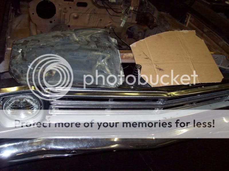

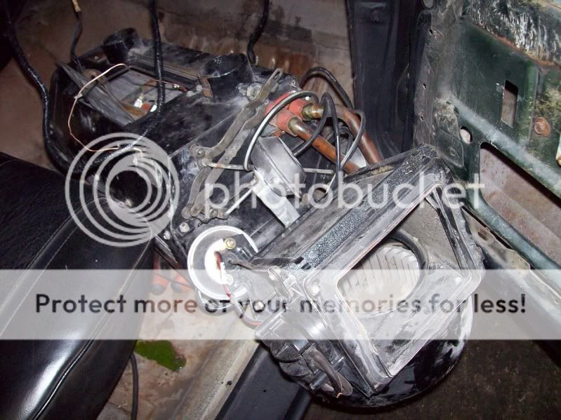

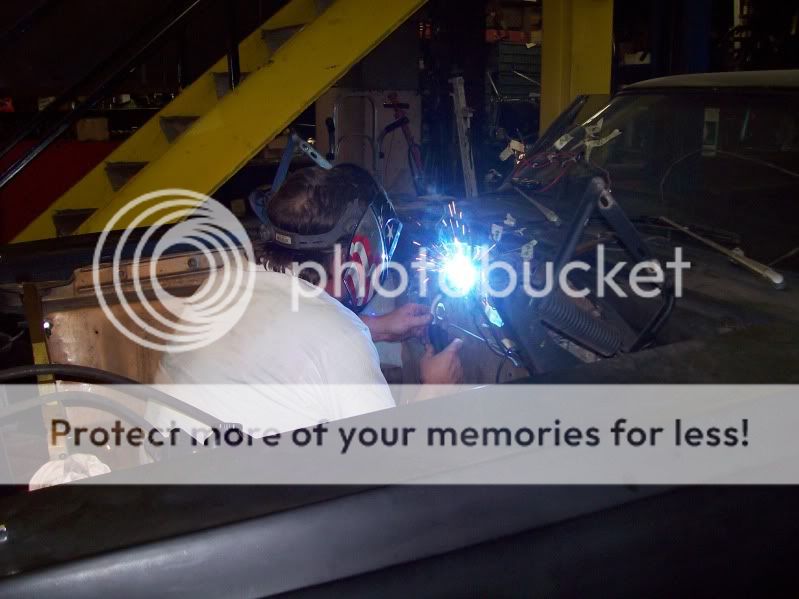

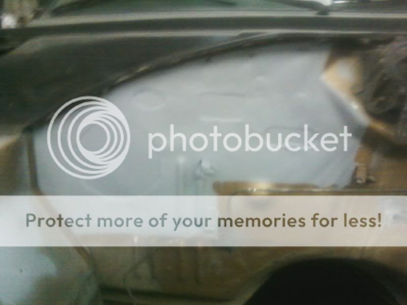

    I removed the ac/heat box.

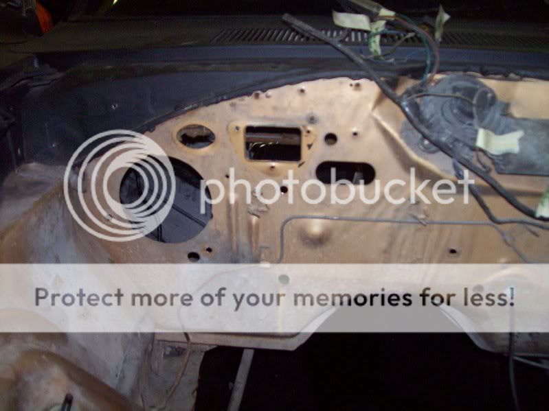

    I made a block off plate out of sheet metal from a carboard template I made.
    My buddy welding it in.
    I ground the welds and threw some primer on there for kicks.
