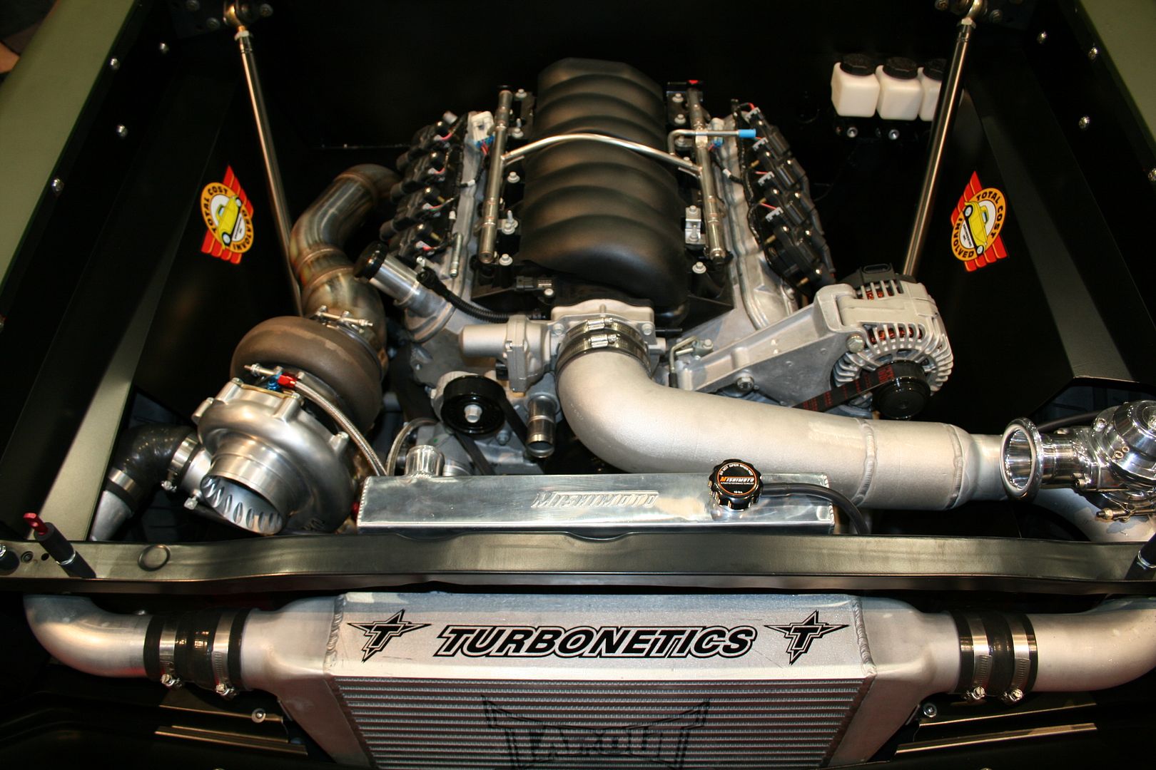

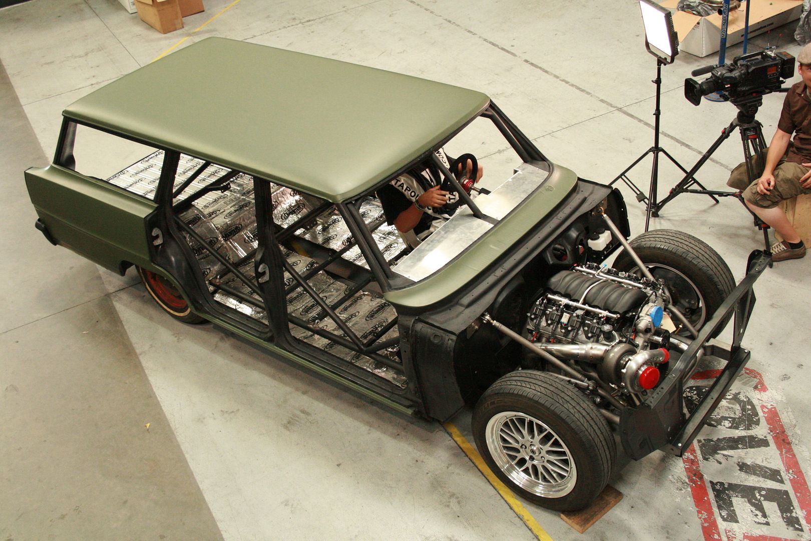

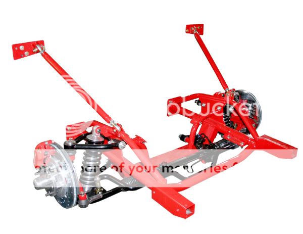

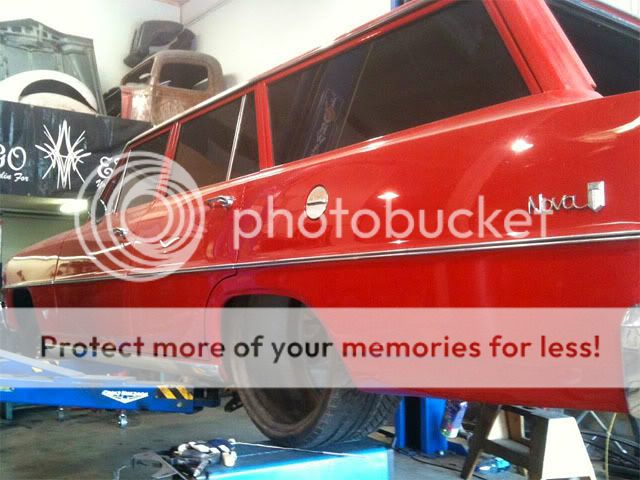

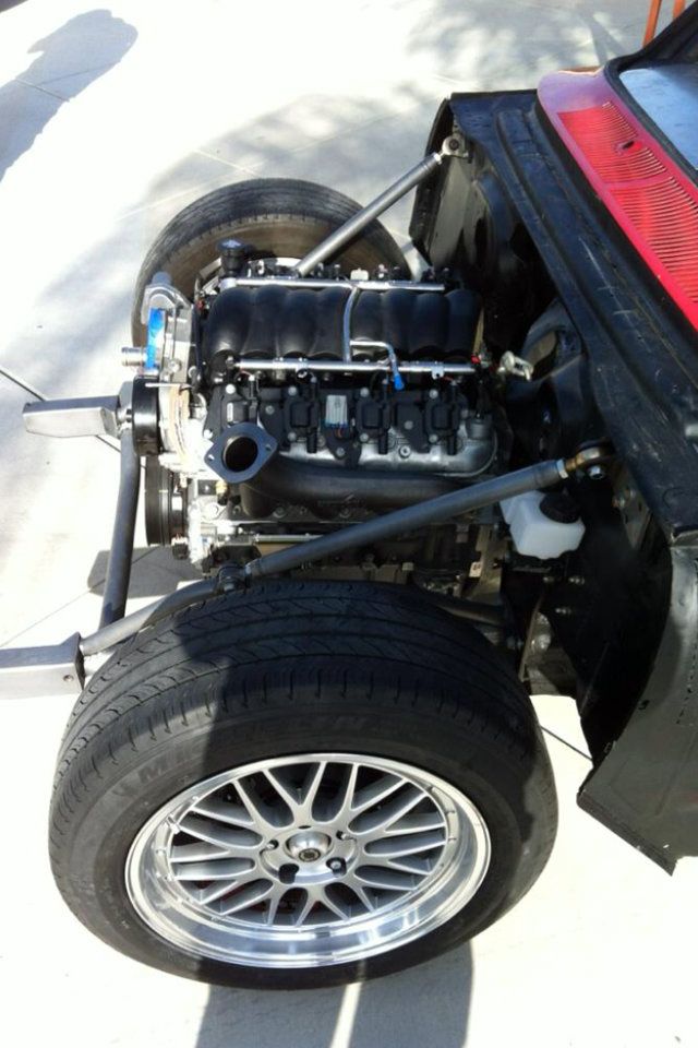

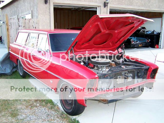

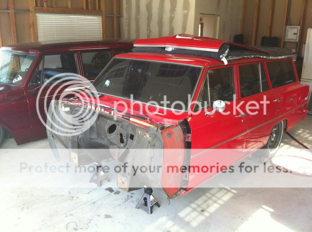

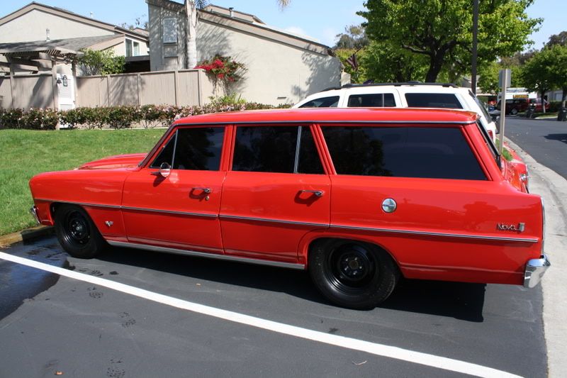

I was asked Walrus(Wally) to post pics of my Brothers Wagon that is currently getting built He bought this car about 4 years ago, its been one of the most reliable cars you can imagine. His plan was to leave it alone until he had West Coast Custom's do the interior, they did a hack job, so he had them re-due it and it was still crap so that all got torn out and it was time to cage it and build a race car out of it. The plan is to have it done by SEMA and run it at the Optima Challenge in as well as all AutoCross events. As of right now these are the vendors helping with the project: *Be Cool Aluminum Radiator *Currie F9 housing, 35 spline axles(boost is in this engines future), 3.70 Platinum Trac, billet yoke, billet pinion support *GM Performance Parts E-ROD 6.2-liter LS3 crate engine *Total Cost Involved Pro-Touring front clip & Torque Arm rear Suspension *Tremec 6 speed *Wilwood 14" 6 piston front, 14" 4 piston rear *The GMR *Rigid Industries *Turbonetics single Tubro *Dynamat *Magnaflow *Ricks Stainless *Redline Gauges *Wilwood *KO Rims *Toyo Tires *Wraptivo= http://www.wraptivo.com/ *Blitzkrieg Motorsports= http://www.blitzkriegoffroad.com/ *Fesler Built How it started: Getting a mini tube and caged at a friends shop: gon.jpg[/IMG]

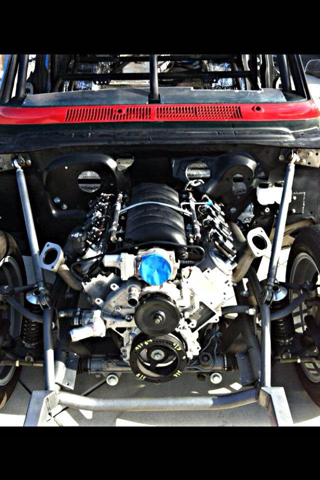

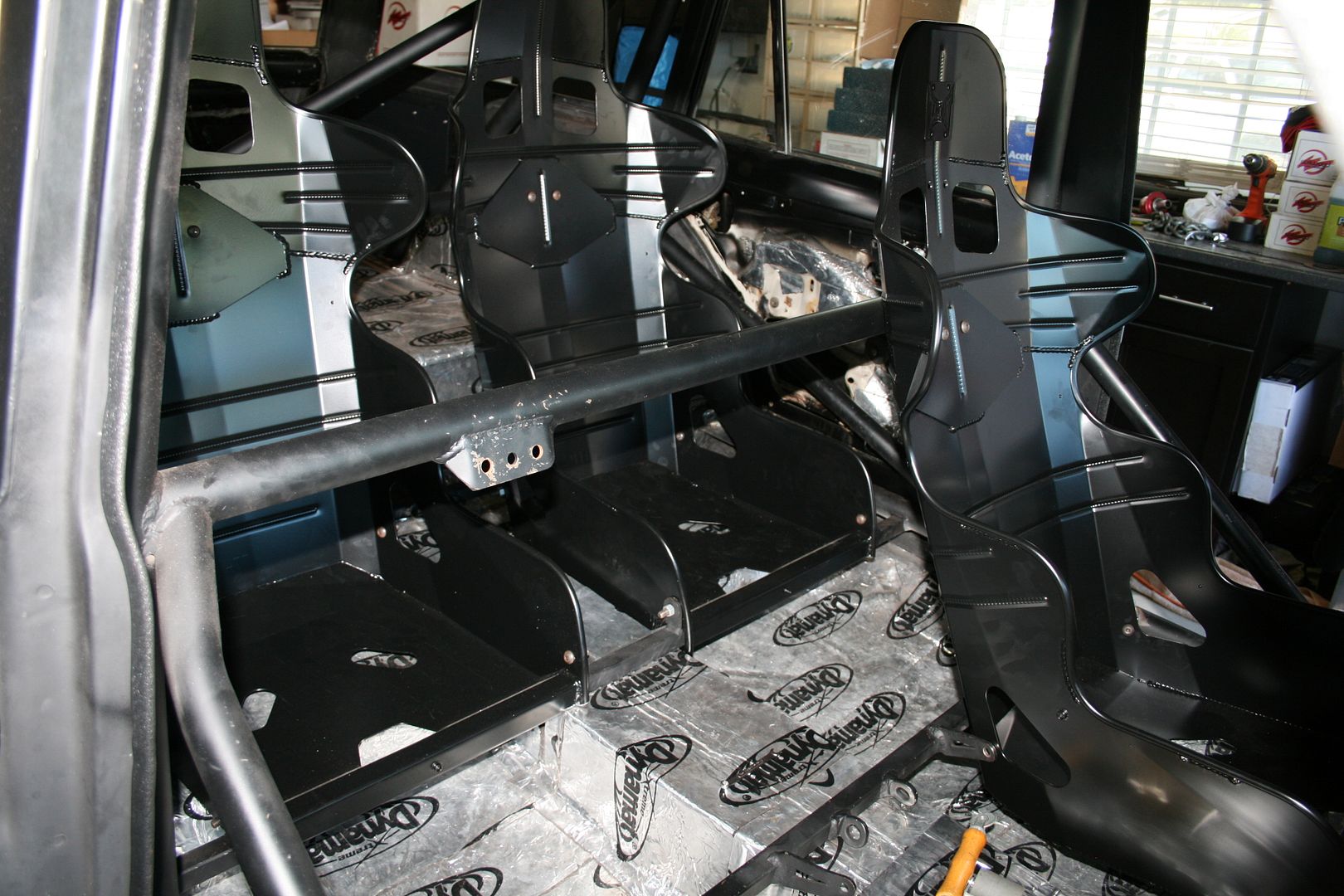

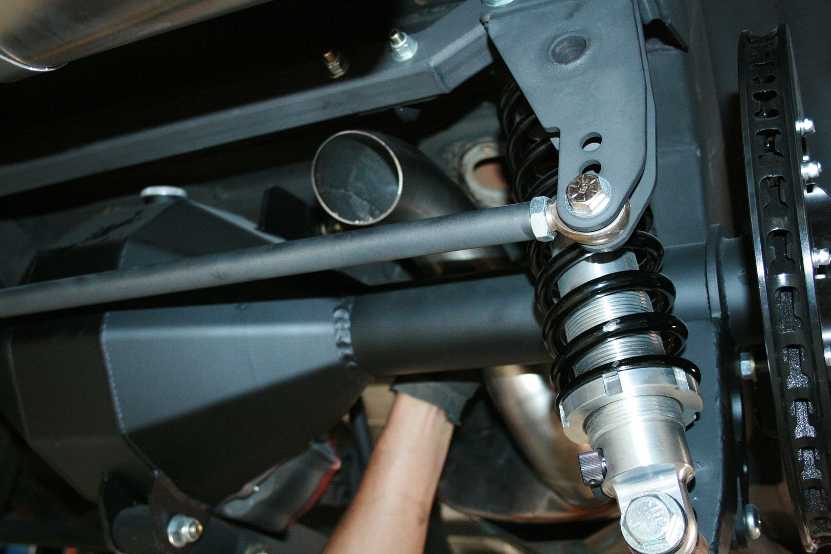

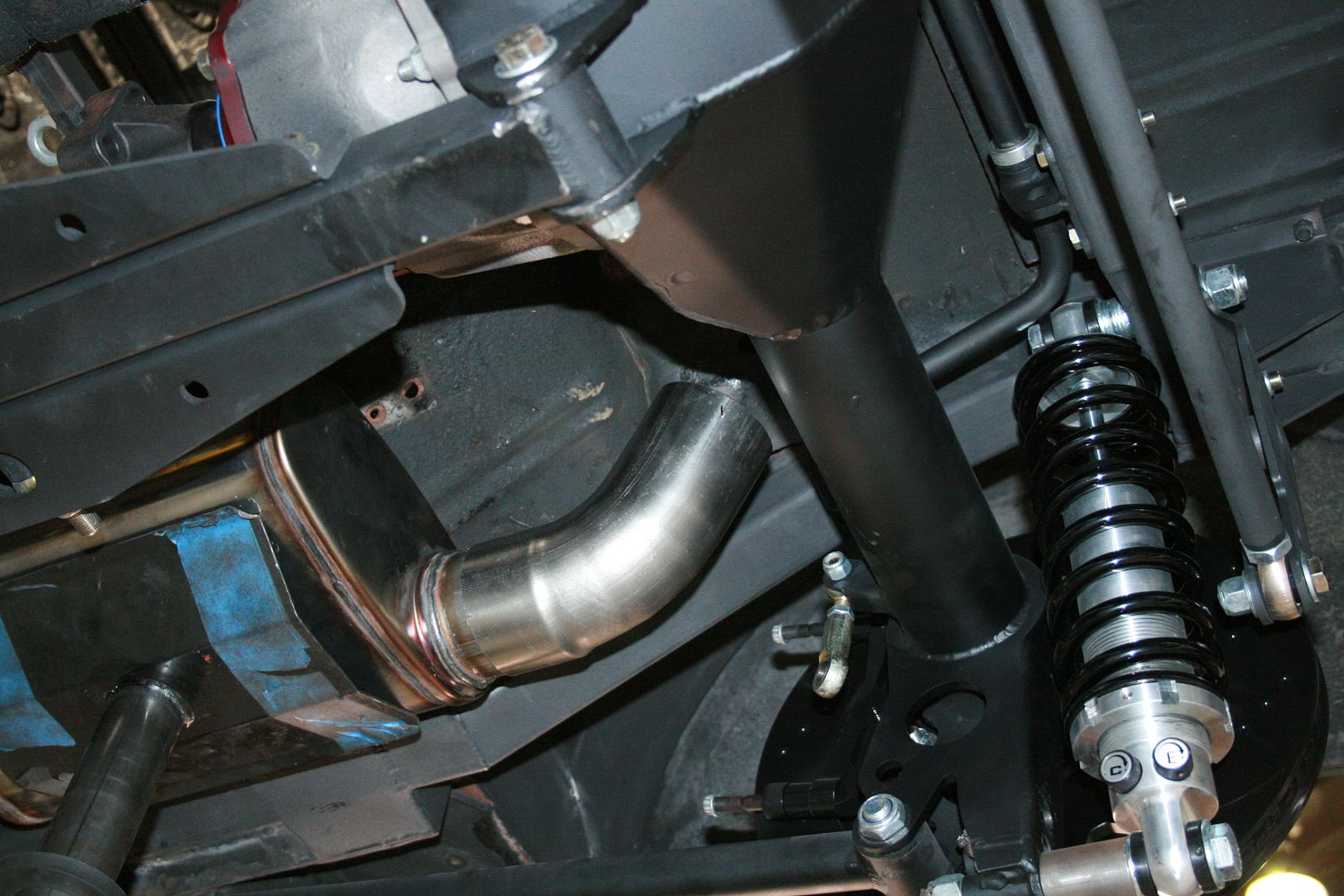

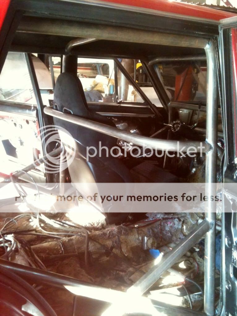

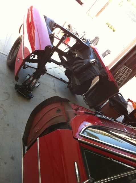

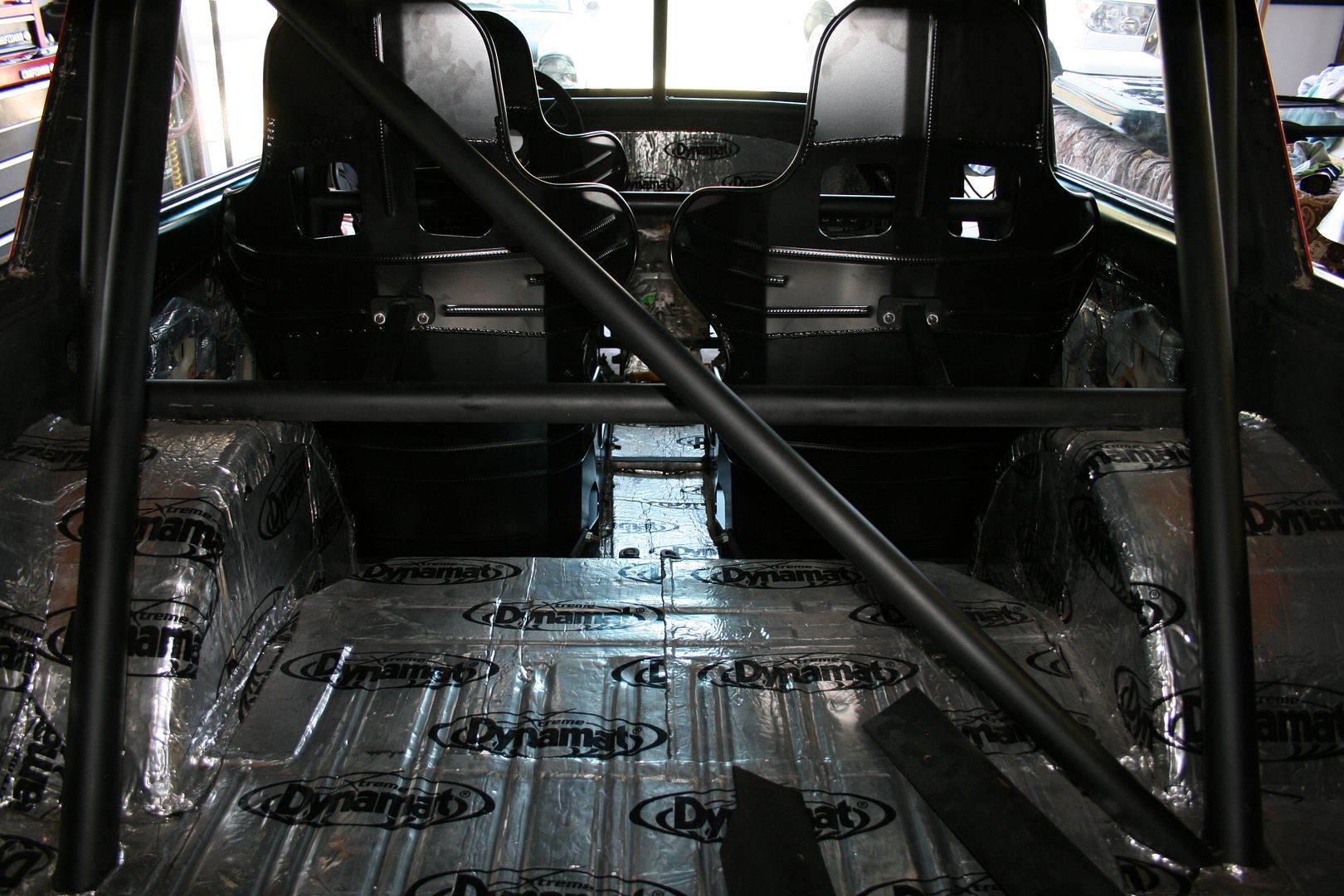

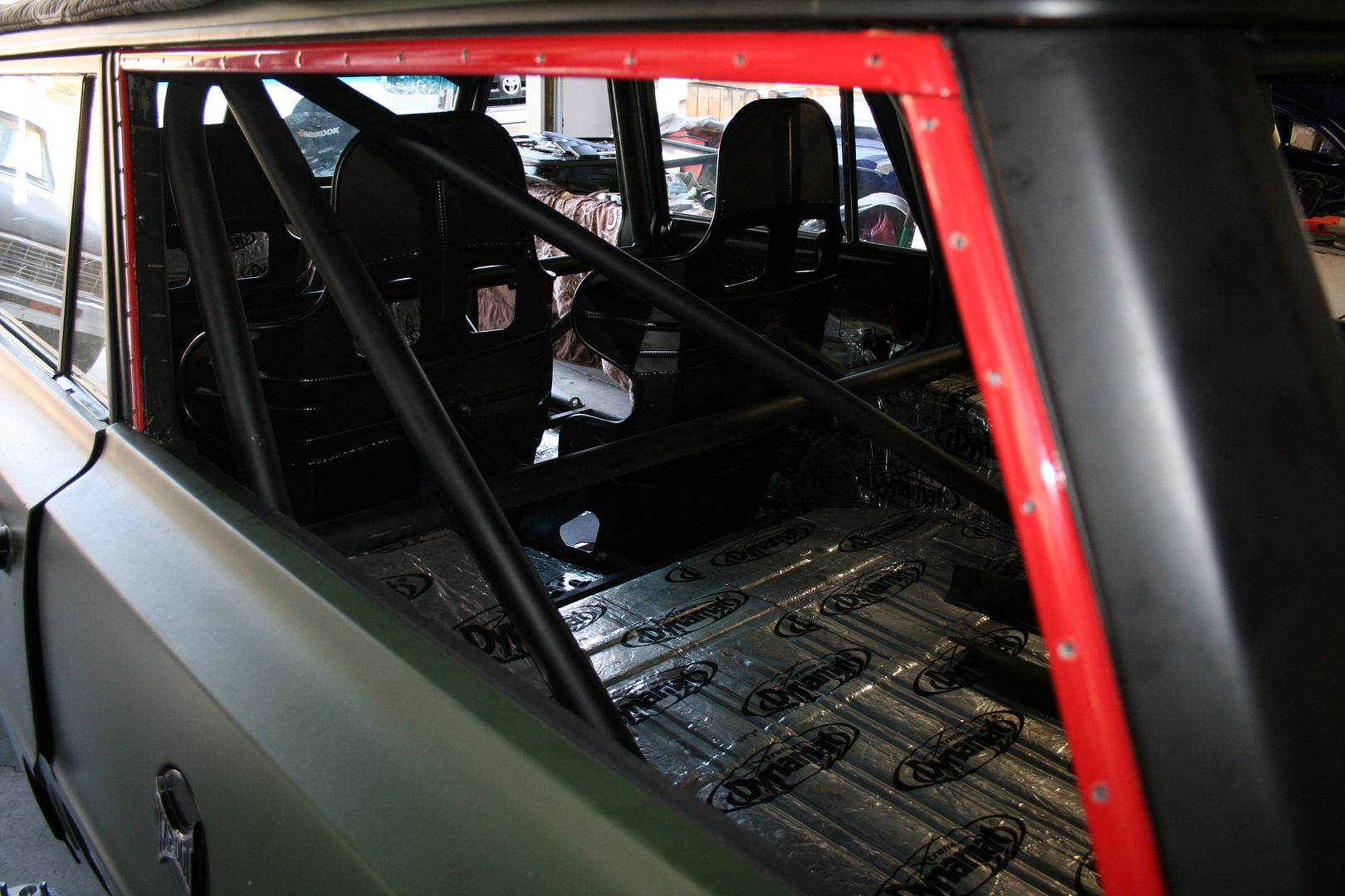

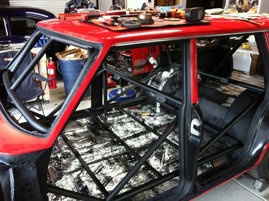

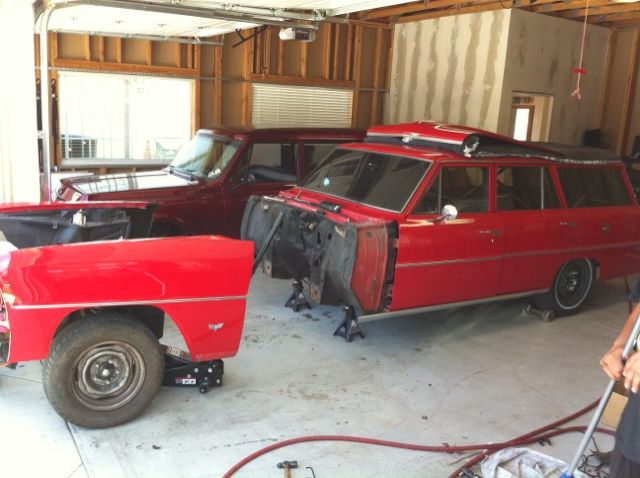

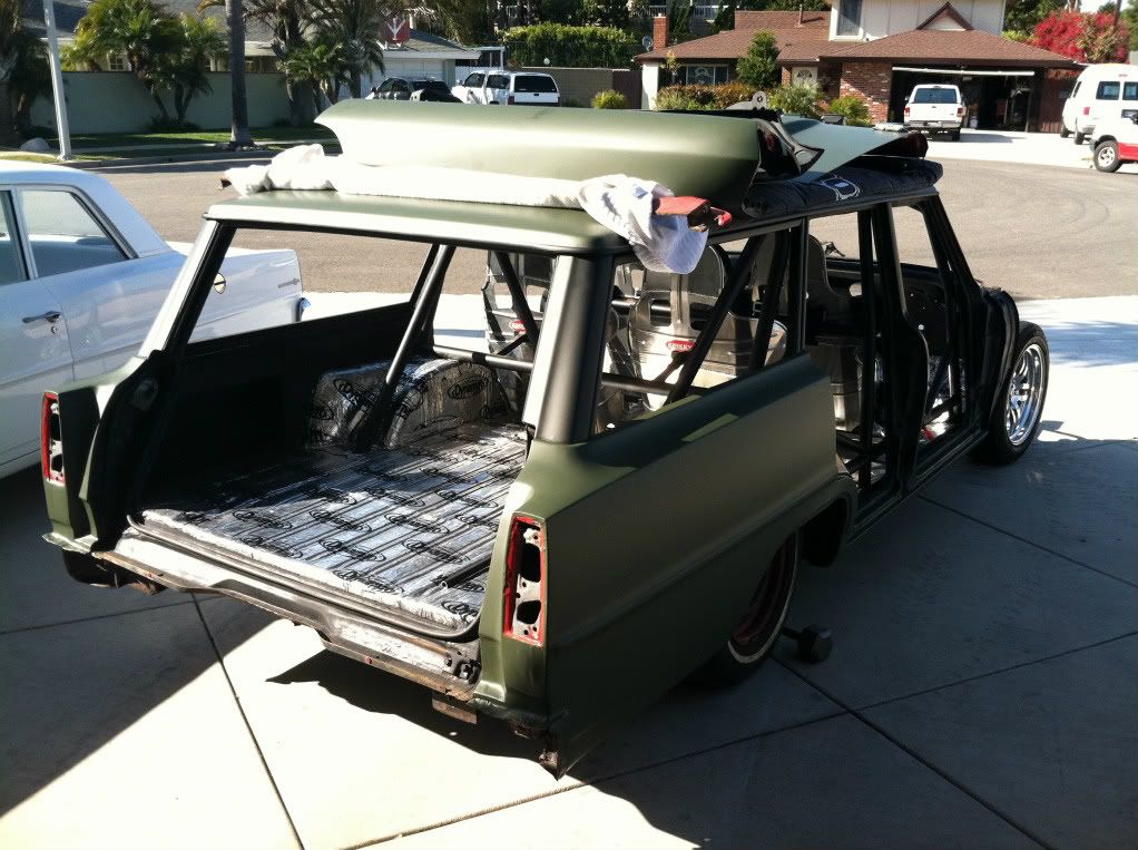

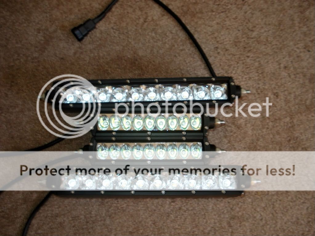

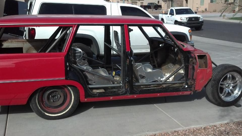

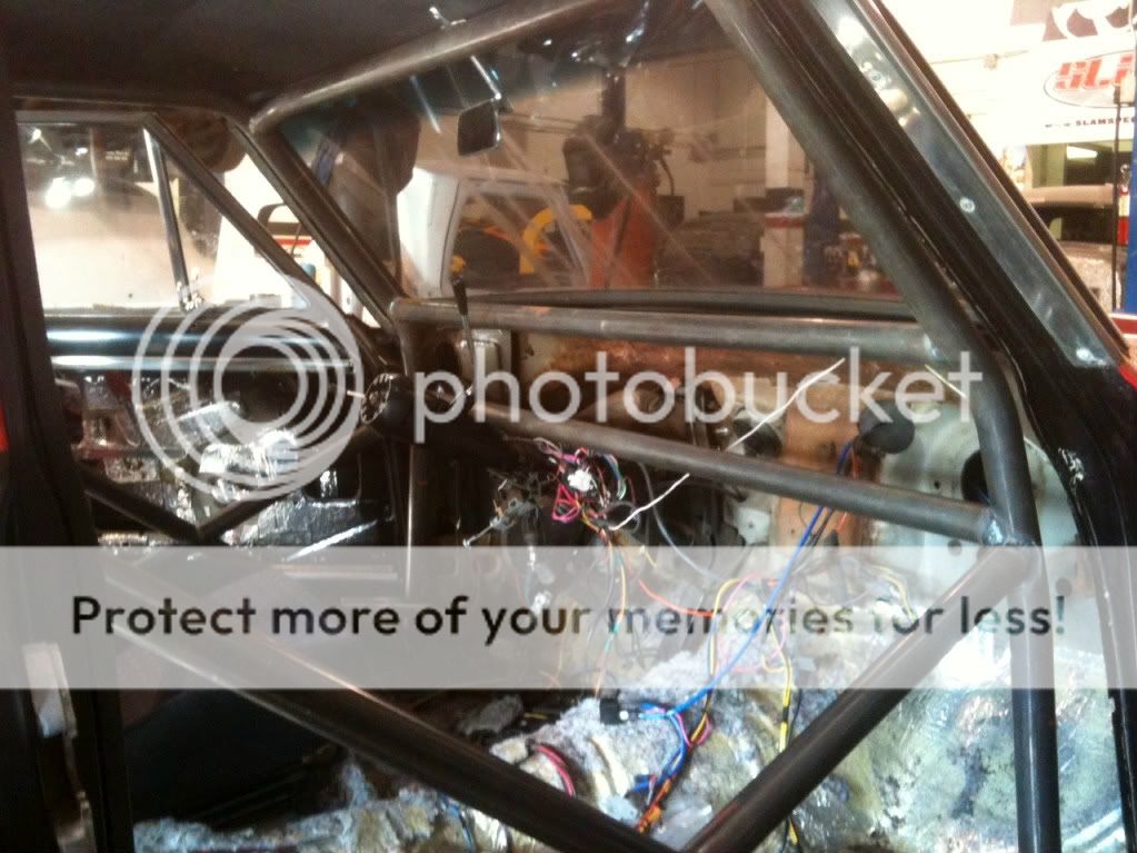

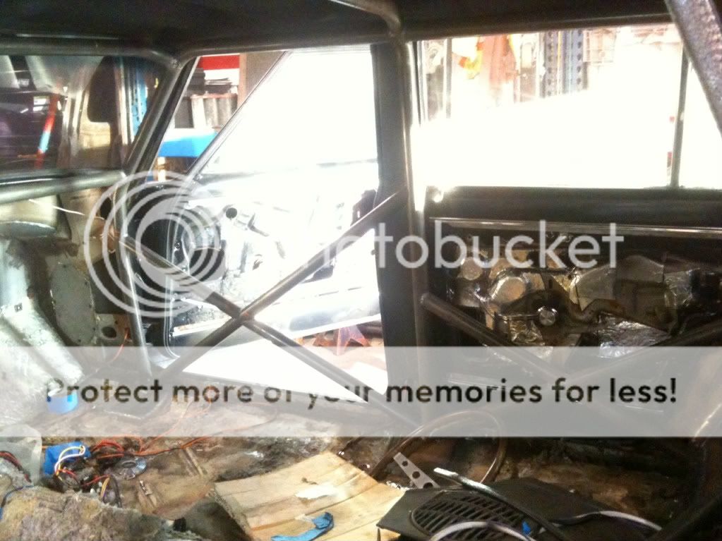

Time to come apart Today the firewall got cleaned up, tomorrow the front clip gets mocked up.I can't wait to see how the paint comes out. If it comes out like it sounds it will be different to say the least . TCI supplied the suspension Got some light's from Taylor at Rigid Industries Old cage got cut out and a new cage got built Curry Rear end Dynamat getting laid down

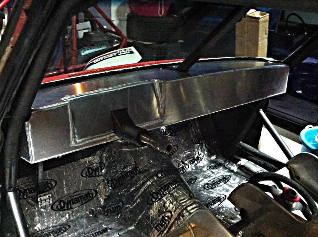

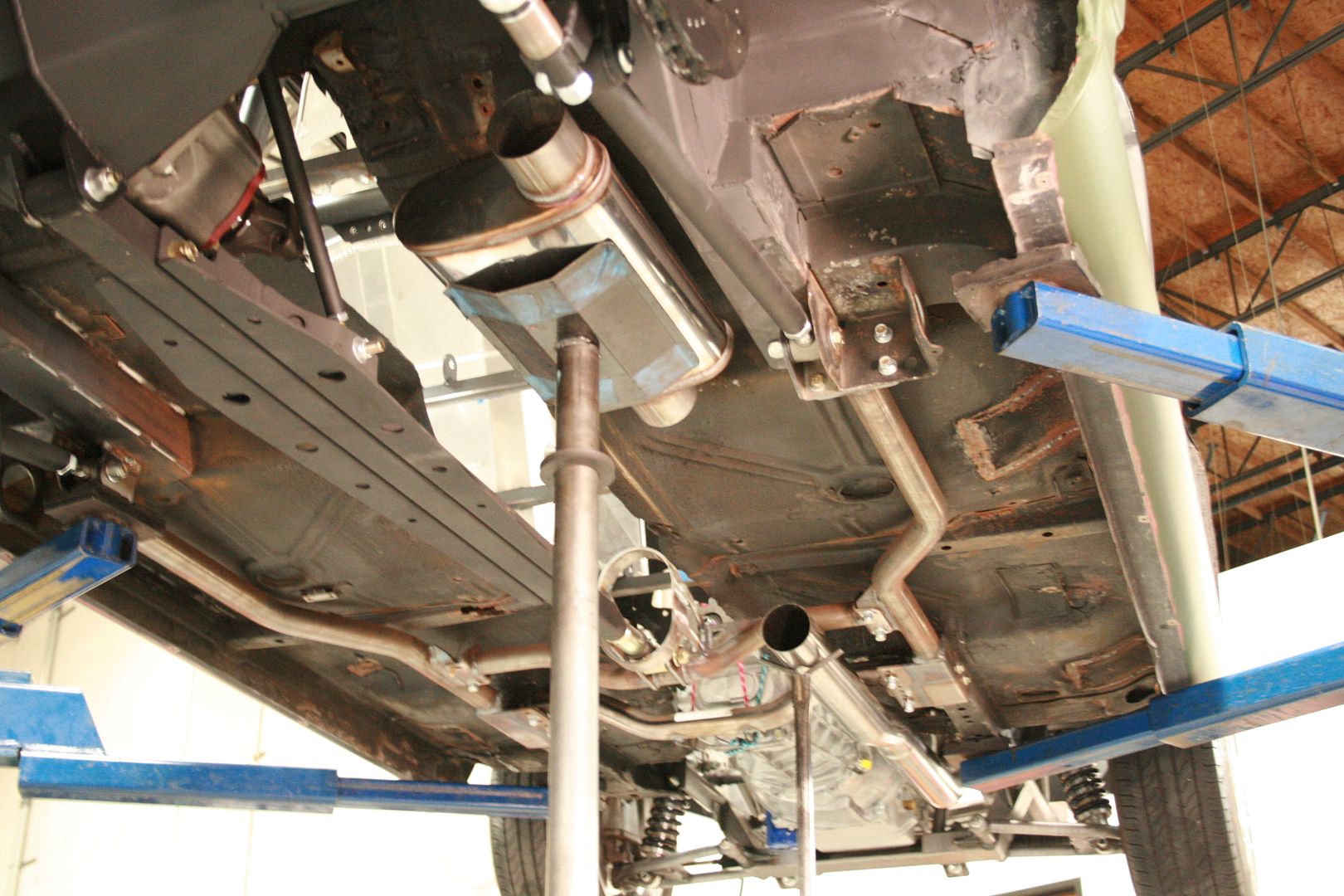

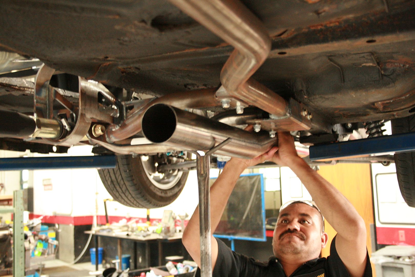

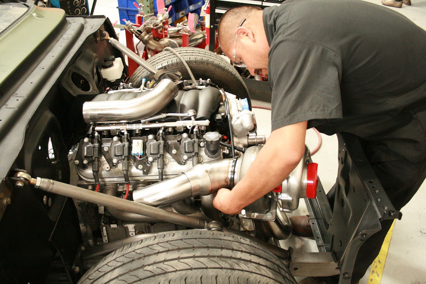

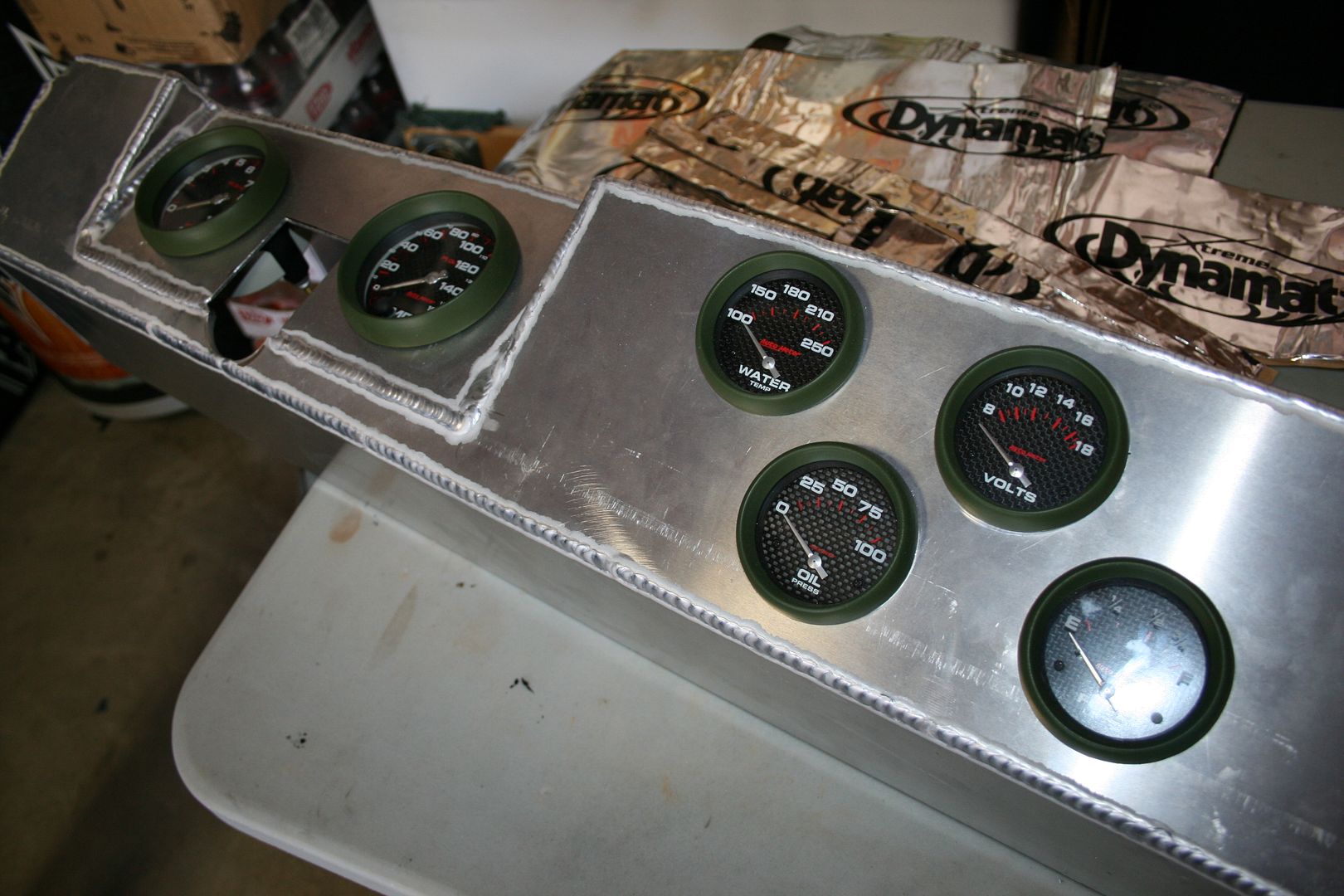

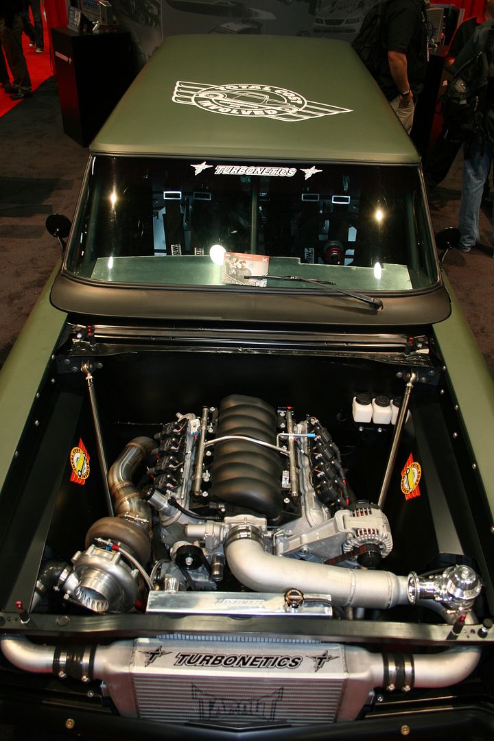

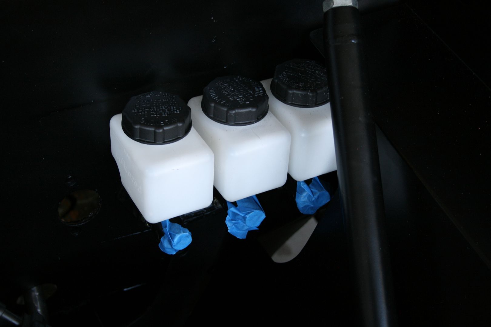

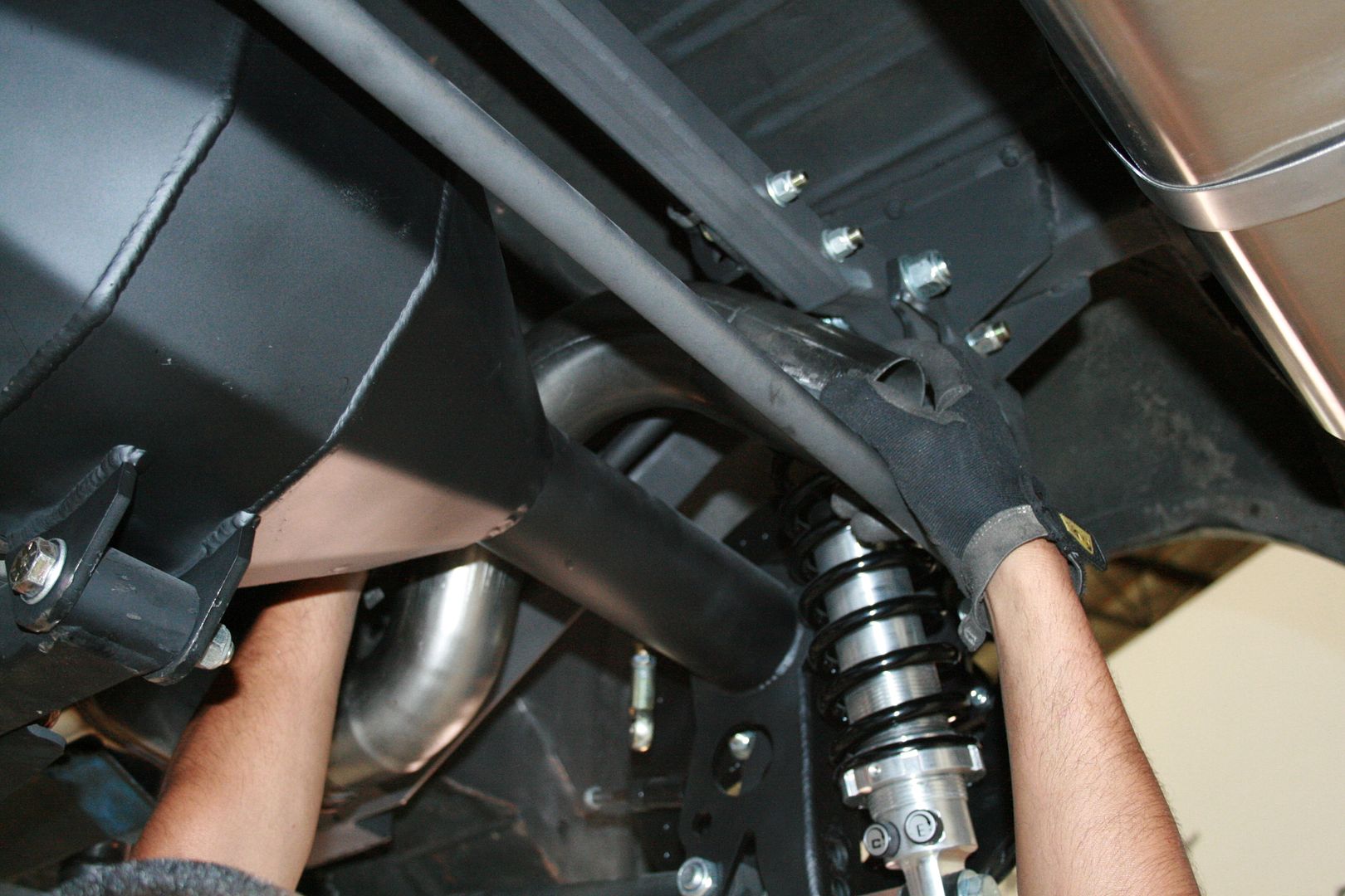

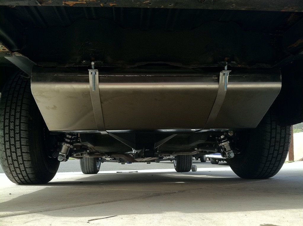

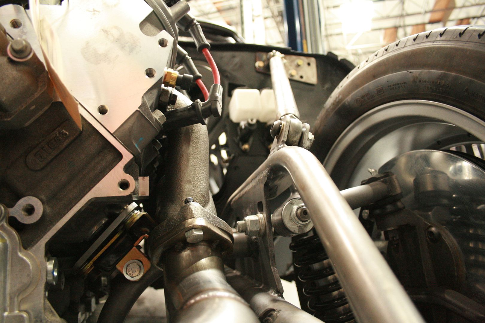

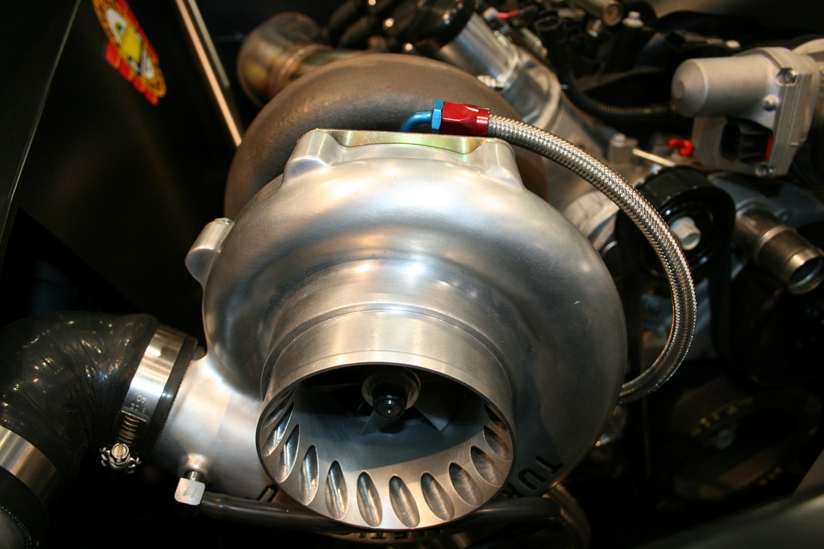

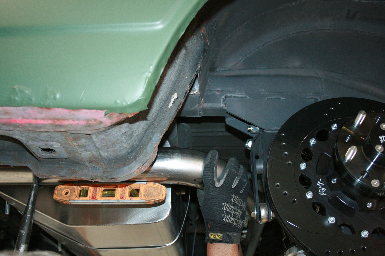

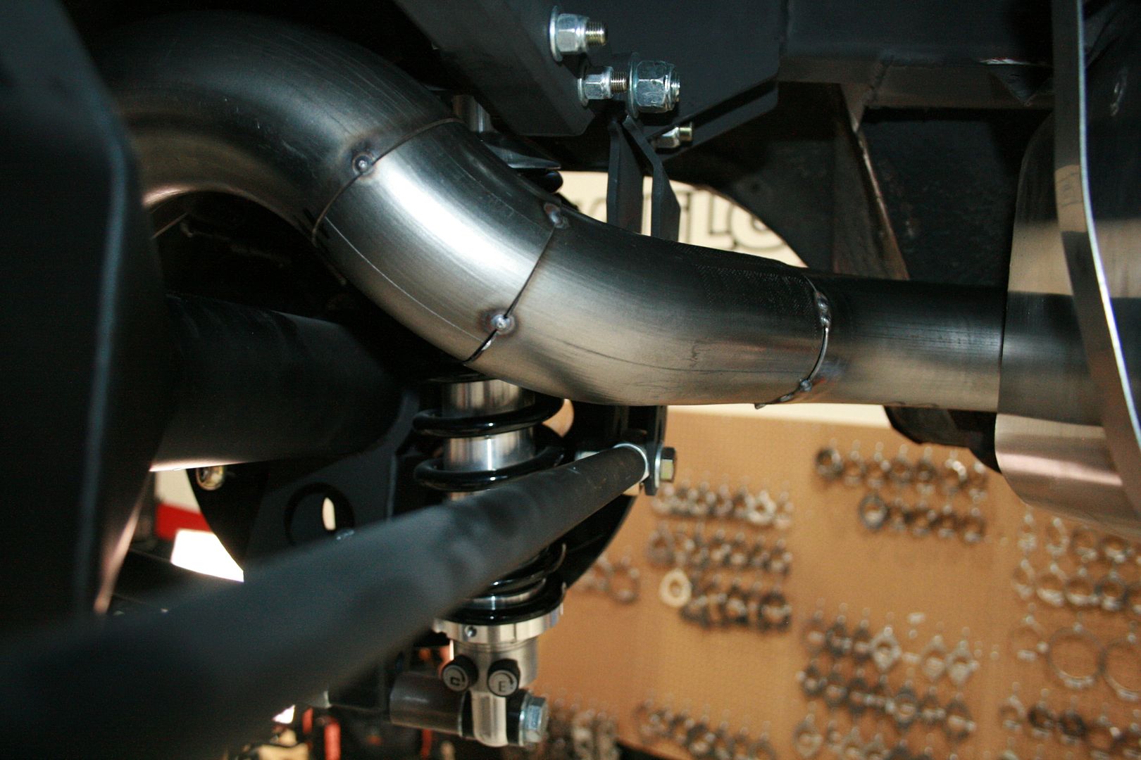

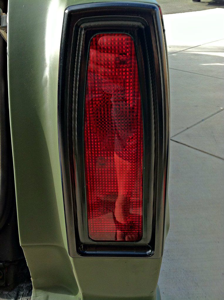

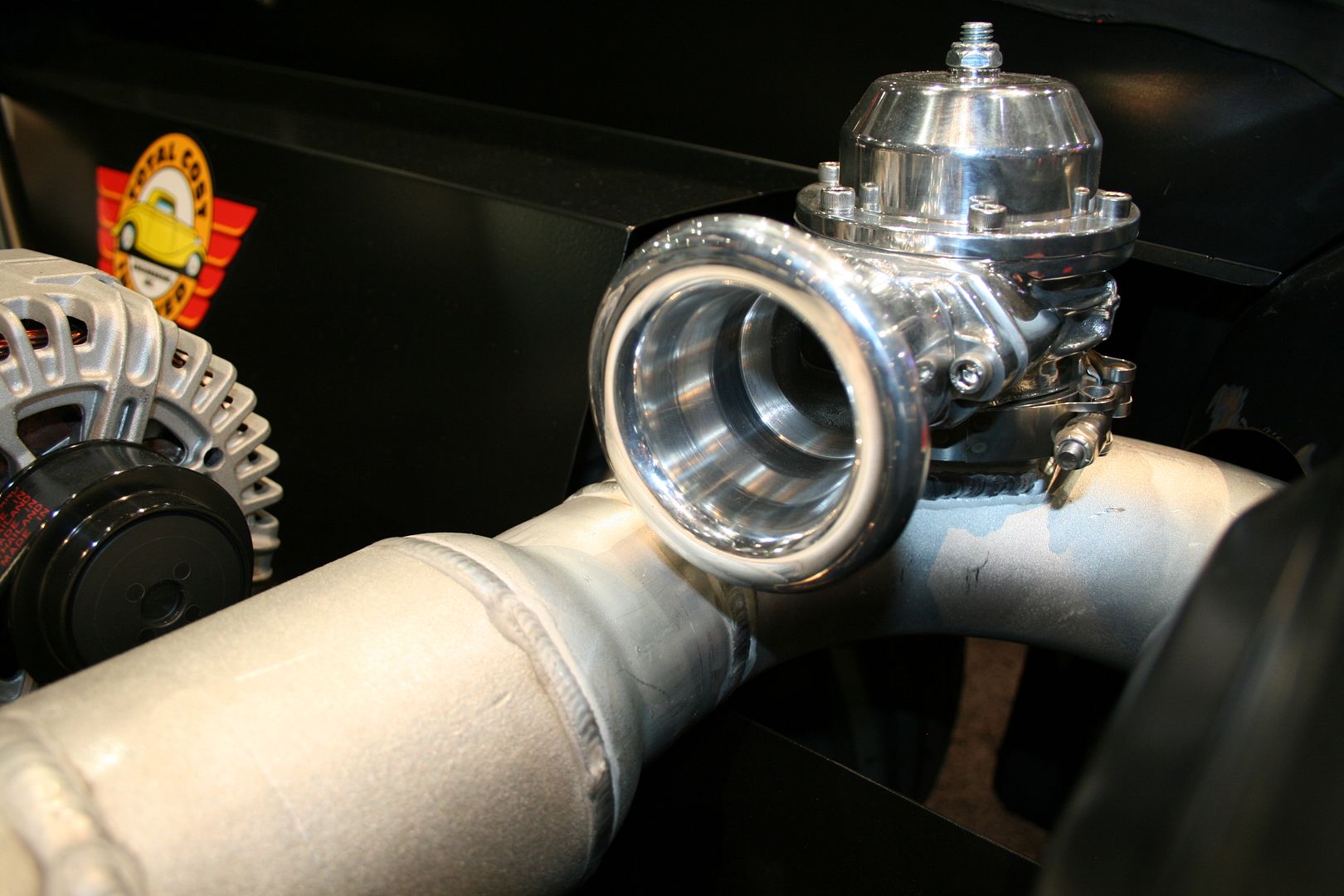

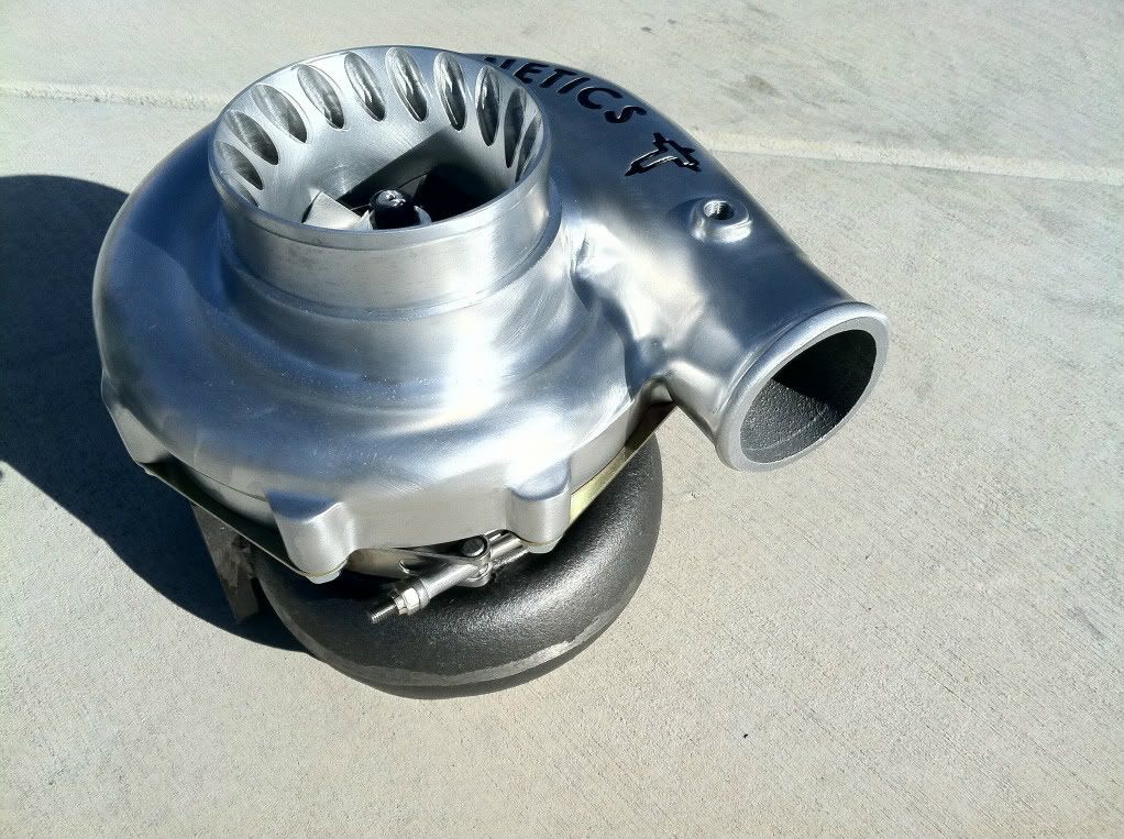

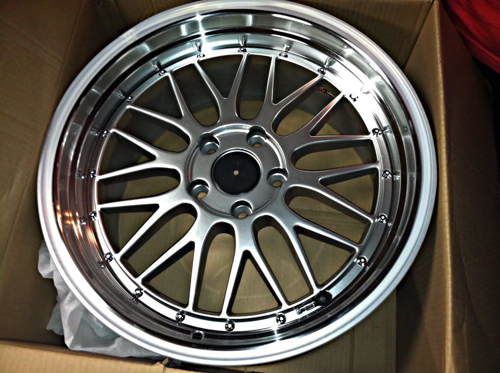

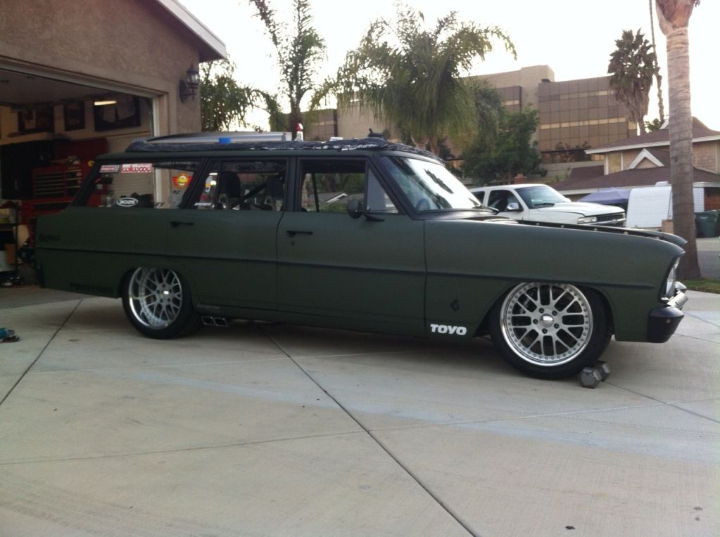

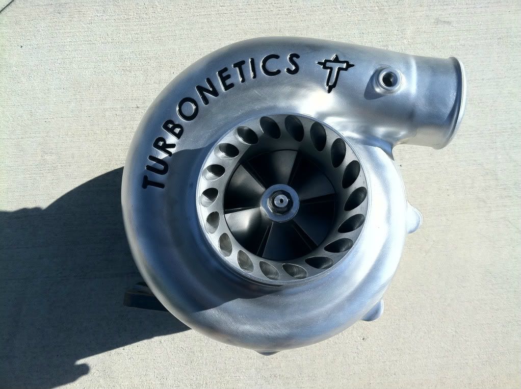

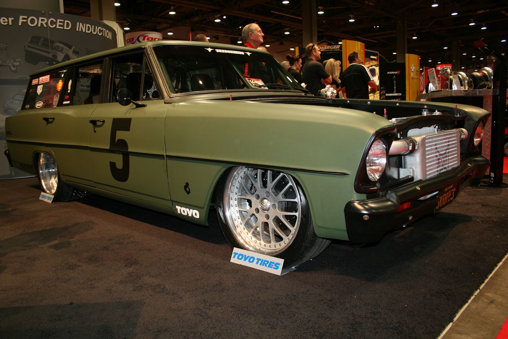

. Turbonetics 75/76 . Curry housing with GMR full floater hubs New wheels Dash is finished Fesler Tail lights . LS3 with Tremec 6 speed . Rick's Stainless Tanks : Welcome to Rickshotrods gas tanks is in . Starting on the driver's side exhaust

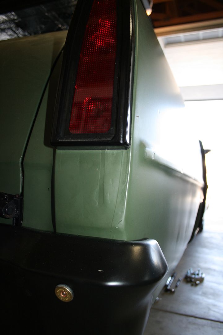

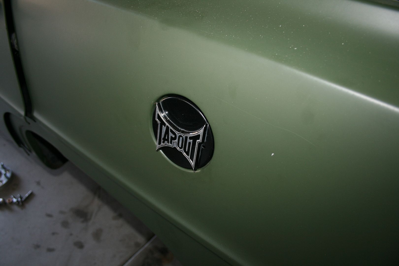

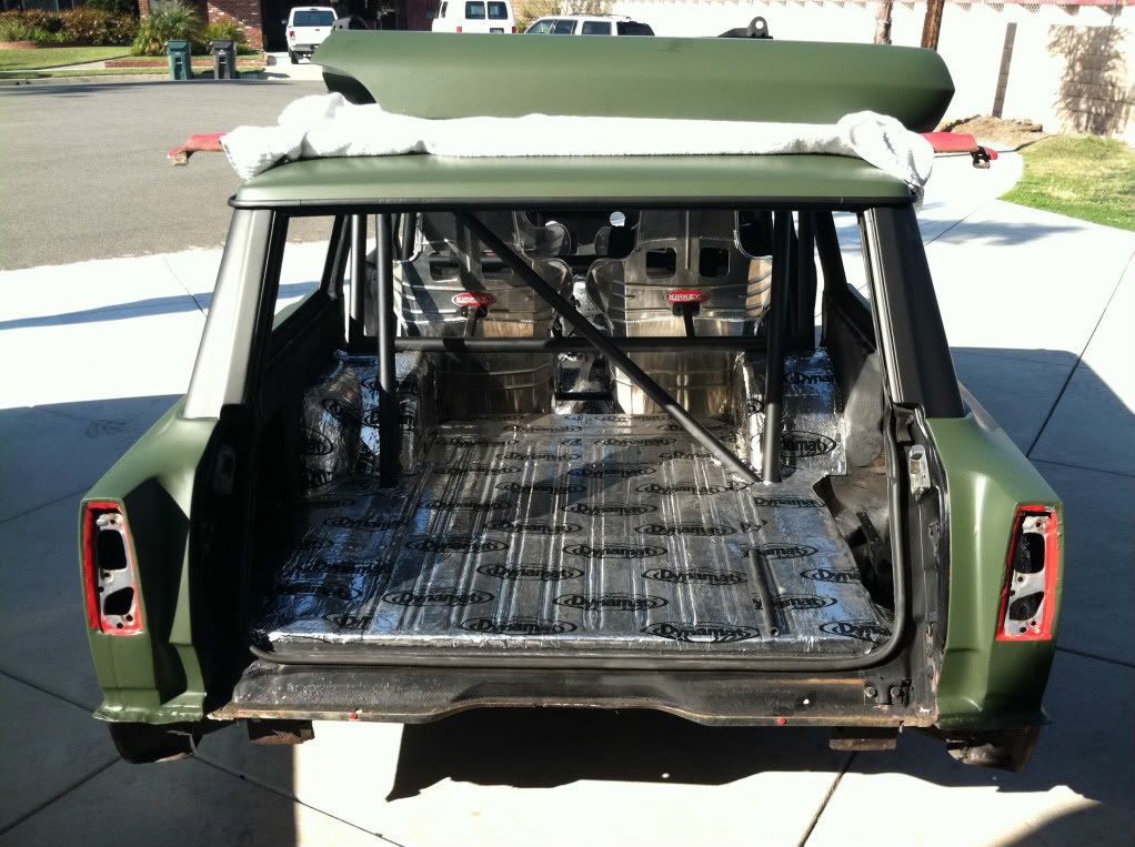

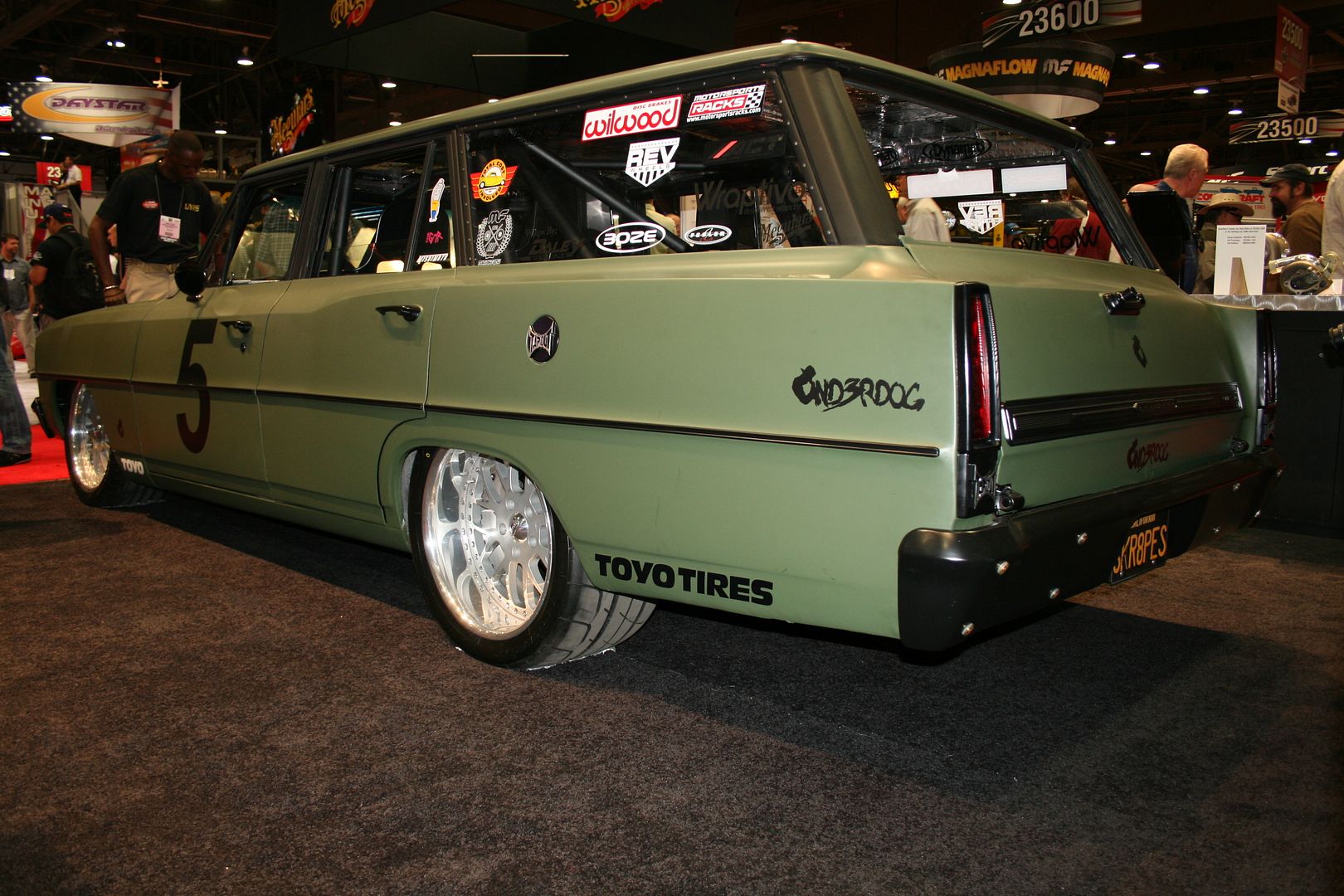

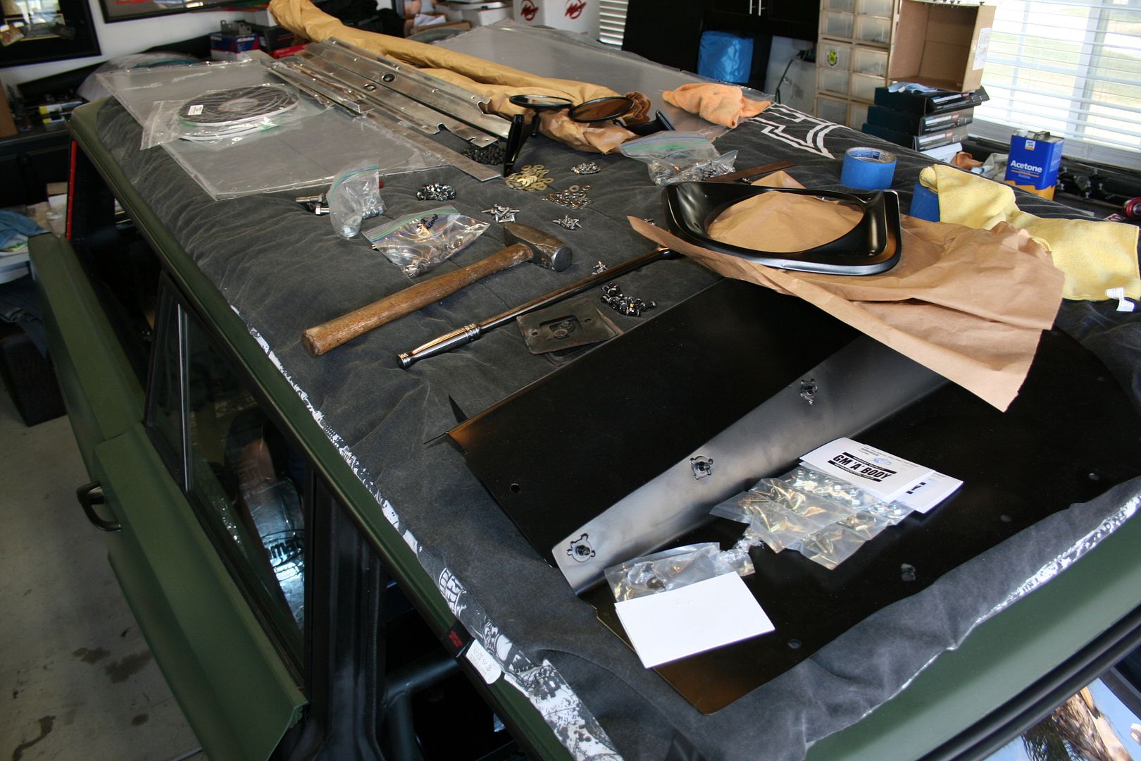

Here are some updated pics Shotgun shell bumper bolts Lexan windows are ready to go in TCI loaned Tim the wheels off their shop Camaro for SEMA
