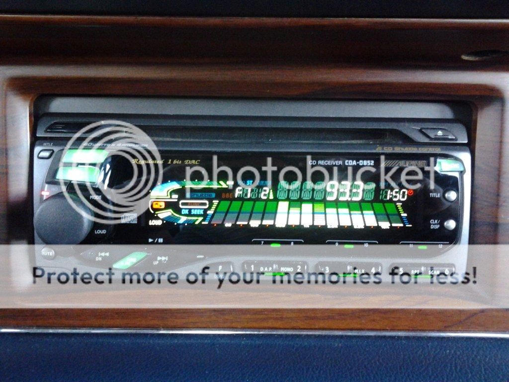

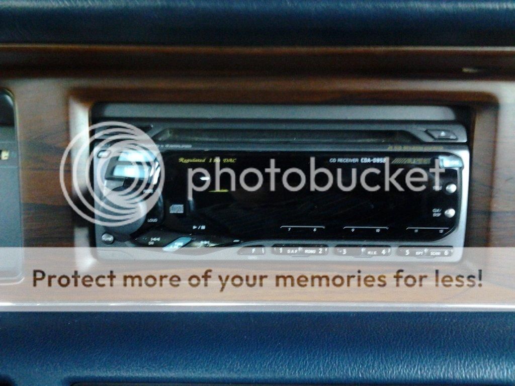

    Go to Zoomthelist.com and search Craigslist for either the Alpine of Pioneer 1.5 decks. They are still out there, and can be found cheap used, and are generally good quality items.
    I bought two Alpine's like this, one out of California and one out of Illinois. Also bought the Pioneer version for my S-10. The Alpines are by far my favorites!
    Jensen also made a 1.5...but it's pretty junky...
    These can also be found on Ebay but I've gotten much better pricing off Craigslist. And if they take Paypal most likely they will ship to you.
    Alpine 1.5 models:
    CDA-D852
    CDA-D853
    CDA-D855
    CDA-D857
    Pioneer
    DEH-43DH
    DEH-45DH
    DEH-P47DH
    DEH-P77DH
    Jensen
    CM7015K
    Here's the Alpine in my '92 Olds Custom Cruiser wagon:
