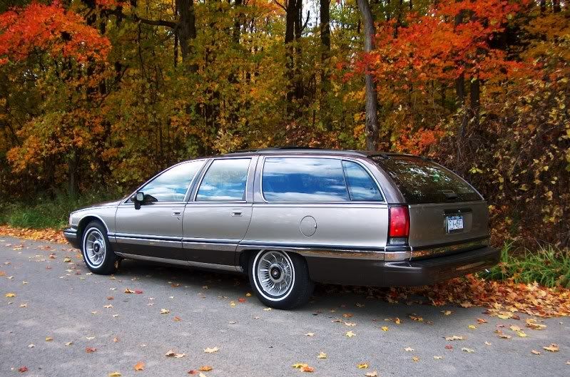

  7. batcar
    batcar New Member
    Aug 19, 2009
    24
    Elyria Ohio
    These are on temporarily until my 90 estate wheels are reconditioned, they are off my 73 Riviera..... 001_zps9704579e.jpg
  8. ponchopio
    ponchopio New Member
    Aug 27, 2009
    25
    Homewood, IL
    Wow, that looks fantastic!
