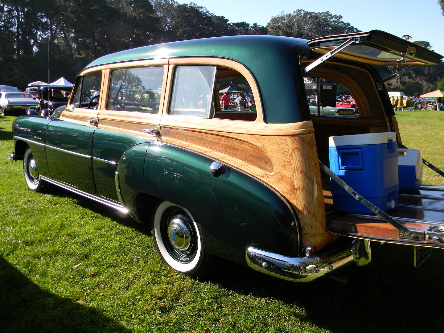

  10. Smokinbill
    Smokinbill Active Member
    Aug 26, 2013
    57
    40
    30
    Roseville Ca
    My friend has a Tin Woodie with painted wood grain, Little more than is supposed to be on there, But it looks great
