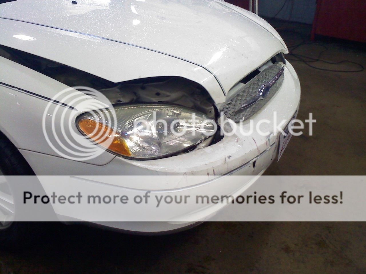

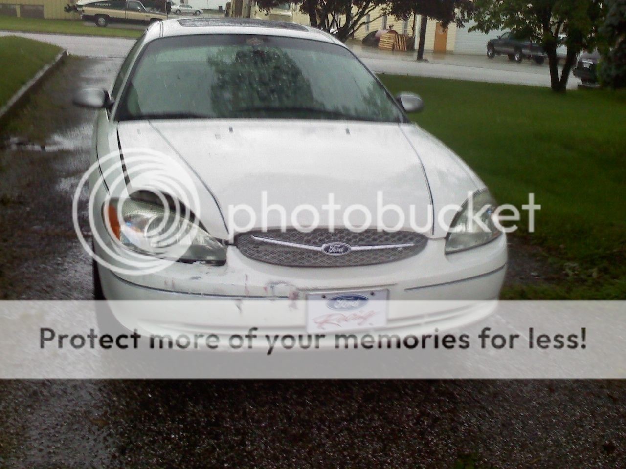

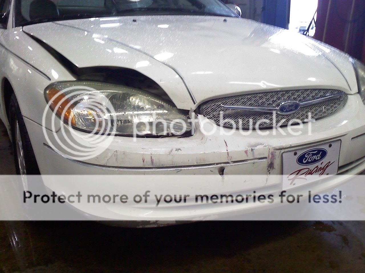

    It's really not as bad as it looks. Appears to be all 'cosmetic; damage (although I'd check your A/C condenser and radiator for damage)
    You need:
    - Bumper cover / impact absorber (foam underneath the cover would be crushed). Bumper reinforcement might be damaged, but my guess is that it's OK
    - Fiberglas header panel and grill assembly
    - Hood and hood LATCH (important to replace the latch after any impact like this - you don't want your hood flying up in front of you on the freeway) I'd also check your RT hood hinge....
    - Rt headlamp assembly
    - RT fender looks like it's rolled a bit at the front edge - ?
  3. Dented Fenders
    Dented Fenders ATX assassin
    Jan 4, 2012
    217
    Dallastown PA
    Rad is good, condensor seem fine, absorber has a little damage, but it did it's job, and the impact bar is untouched. Fender is rolled a tad, hood latch holds the hood down as designed. (will replace it anyway) Right headlight is pushed in, but the header panel took the damage. Headlight will be fine with a little work, (it looks broken in the corner, but it actually isn't). Hood hinge looks fine, but I'll be getting a new one anyway. Grille is good, too! The steel mesh panel protected it. (the reason I put it on there :dancing: ) From what I can tell (I do know about this stuff, been in the business for a while now ;) ) there is nothing structurally wrong with her. And if everything goes my way, Marilyn (the car's named Marilyn hehehe) will have a completely custom face. :D
