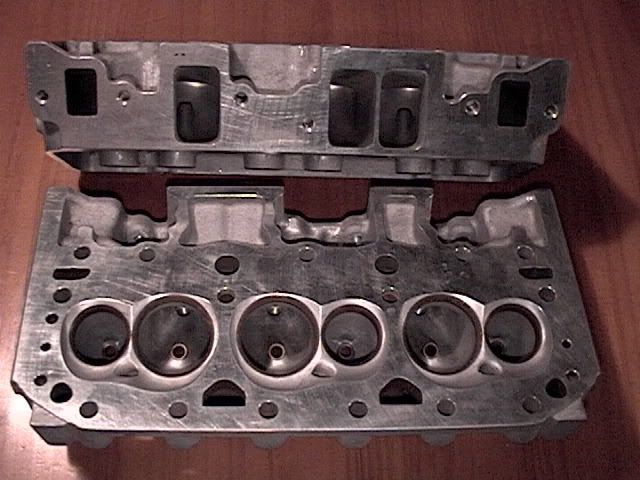

    Well, well a subject near and dear to my heart. Question is how far do you wanna go? There is an Edelbrock TBI intake and headers that you can use. There is a 4 barrel intake that came stock on some Astro vans. there are also alot of aftermarket stuff out there for them. I also ran a Pete Jackson gear drive(noisey of course). I bought these heads and Intake at a swap meet one year for $900. They are aluminum GM performance heads and intake that were ported. Polished and flow bench tested as a unit by Katech. Sadly I sold them quite awhile ago.
