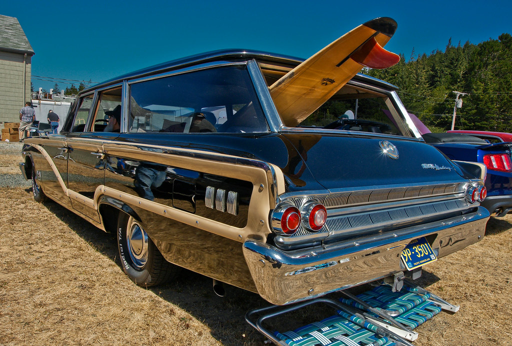

    Yep, I found another '63 on Tumblr that had the exhausts cut at a 45 exiting about 3/4 down rear quarter panel. I thought that look really good so I'm going that way.
    [​IMG]1963 Colony Park wagon -- DSC04978 by Lance Nix, on Flickr
