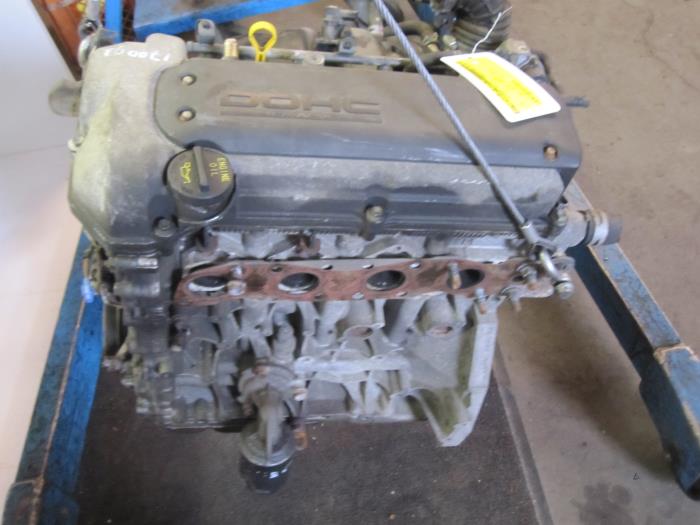

    That'll be interesting to see how you're going to stuff a Subaru drivetrain in there. Without replacing the entire front end suspension, the flat engine won't clear. What you're more than likely going to have to do is to find a donor car, weld braces between the A-posts and then transfer the entire engine compartment with suspension onto the Vauxhall. Because the Vauxhall isn't as wide as the torbocharged flat-6 models, you're unfortunately going to be limited to using a flat-4 donor car, unless you cut the Vauxhall longitudinally and vertically, in order to widen the entire vehicle.
    If the drivetrain has to be Subaru, the easiest way would be to drop in a 1300 cc Subaru in-line. Not that it necessarilly has to be easy:

    I became a little worried about the size of the Vauxhall after Dogheads comment, so I took another measurement of the Vauxhall and our 06 Outback. Out side of front fenders on Vauxhall was 64" and Subaru was 67" outside of front wheels. Seems doable. outside of frame on Vauxhall was around 26" and the inside of the frame on Subaru was 30". Hmmm looks like widening sub frame on Vauxhall is going to be a must. Length of engine compartment with radiator on Subaru was 33" and the Vauxhall was 44". It doesnt seem like it's an absolute no it wont work at this point. I am bringing the second one home Friday and will decide which I am going to put on our new rotisserie so we can get down to seeing how it will work.

    Essentially, the Subie engine sits just about on the subframe rails, and is attached at the bellhousing to the firewall, but they're bolstered front and rear by the unit body construction. I don't know if the Vauxhall is Unibody or not, but even if not, it's likely you could build a frame skeleton that could hold the engine, upper rear dogbone and the MacPherson suspension, then lay the sheet metal over it. It will be interesting to see how you approach this.
